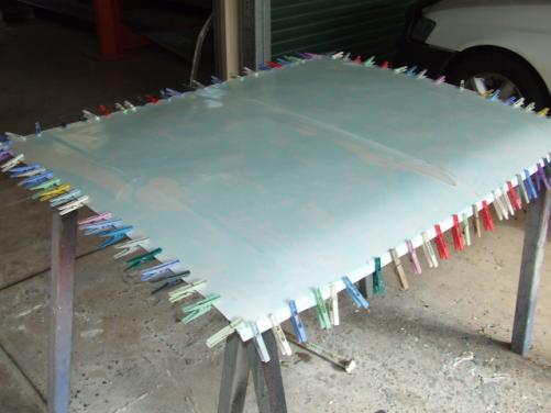

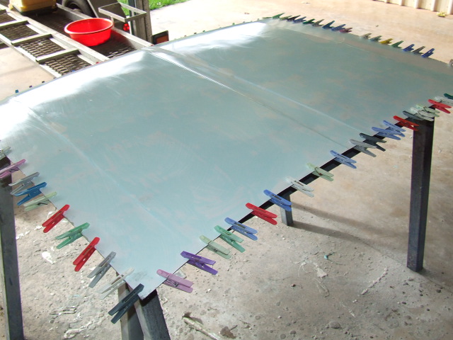

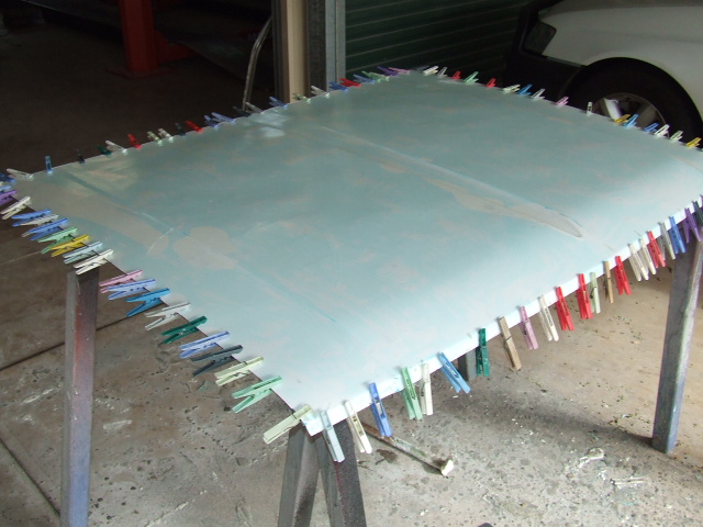

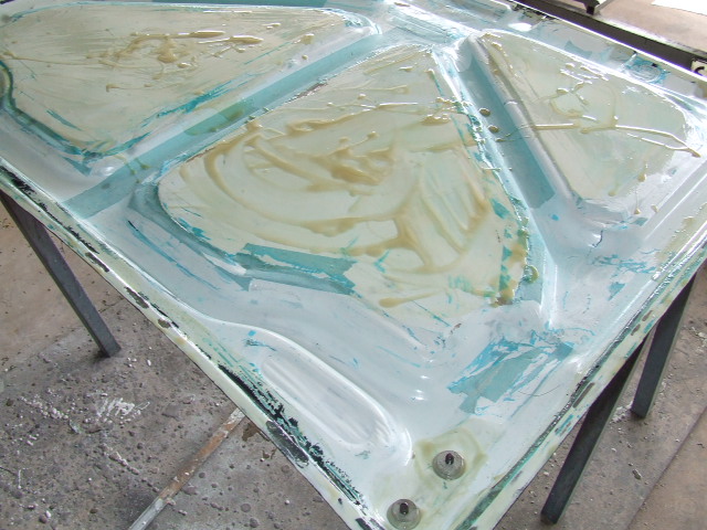

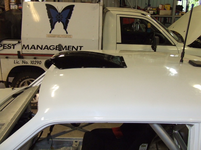

Fibreglass bonnet going together.

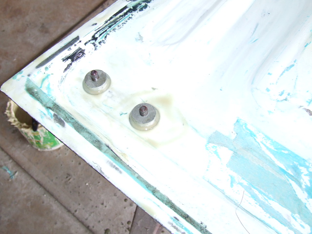

Alloy captivated nuts glassed in and inner and outer skins glued together.
Steel bonnet weight 13kgs
Glass bonnet 6kgs.
Its not bad at first glance although at eye level you can see its fibreglass.
To keep it light its just one sheet of glass and gel coat thick. Its stiffness comes from laminating the two halfs together.
You can get a steel like finish, but it would take 3 or more layers which would bring it up to steel weight or maybe more and it still might flex in the sun.
Not much point.

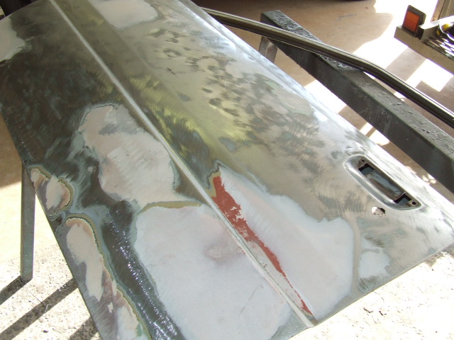

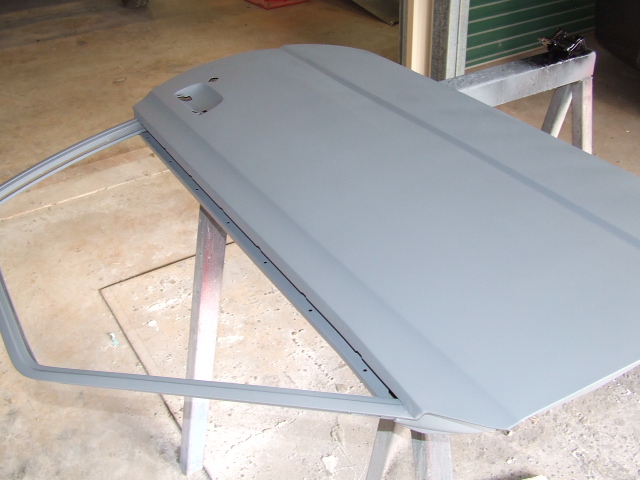

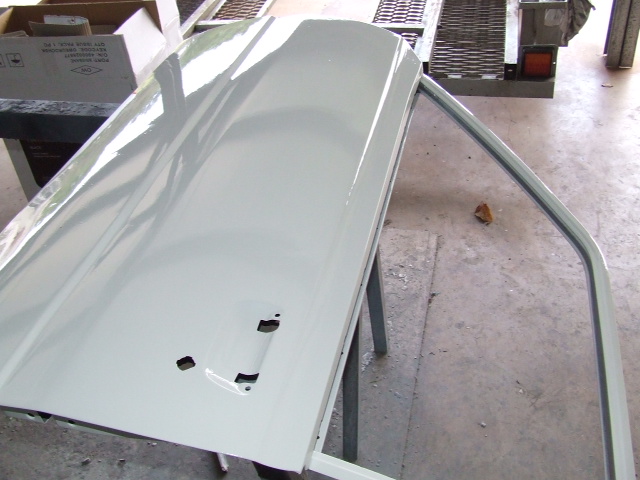

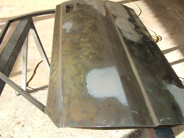

Started preping a door.

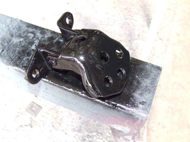

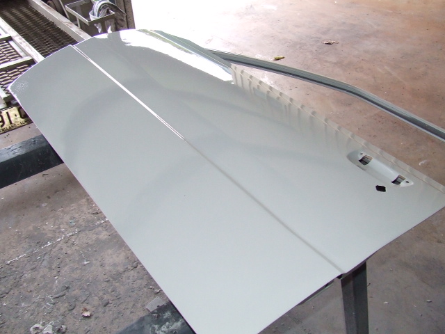

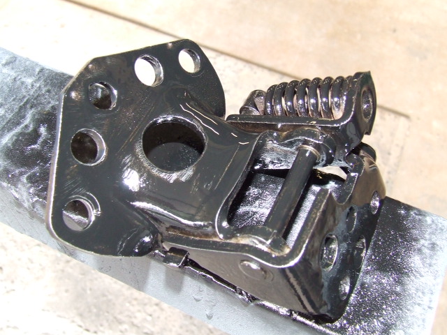

Lightened some door hinges. No PEGS were used in this process.
LoL, the lengths drivers go to for weight saving!
We took an Abra file to the Datsun hinges, a hacksaw blade that cuts in any direction. We left an outline of the hinge and the boltholes!
I've seen drivers cut the spanners in the toolkit shorter to save weight.
