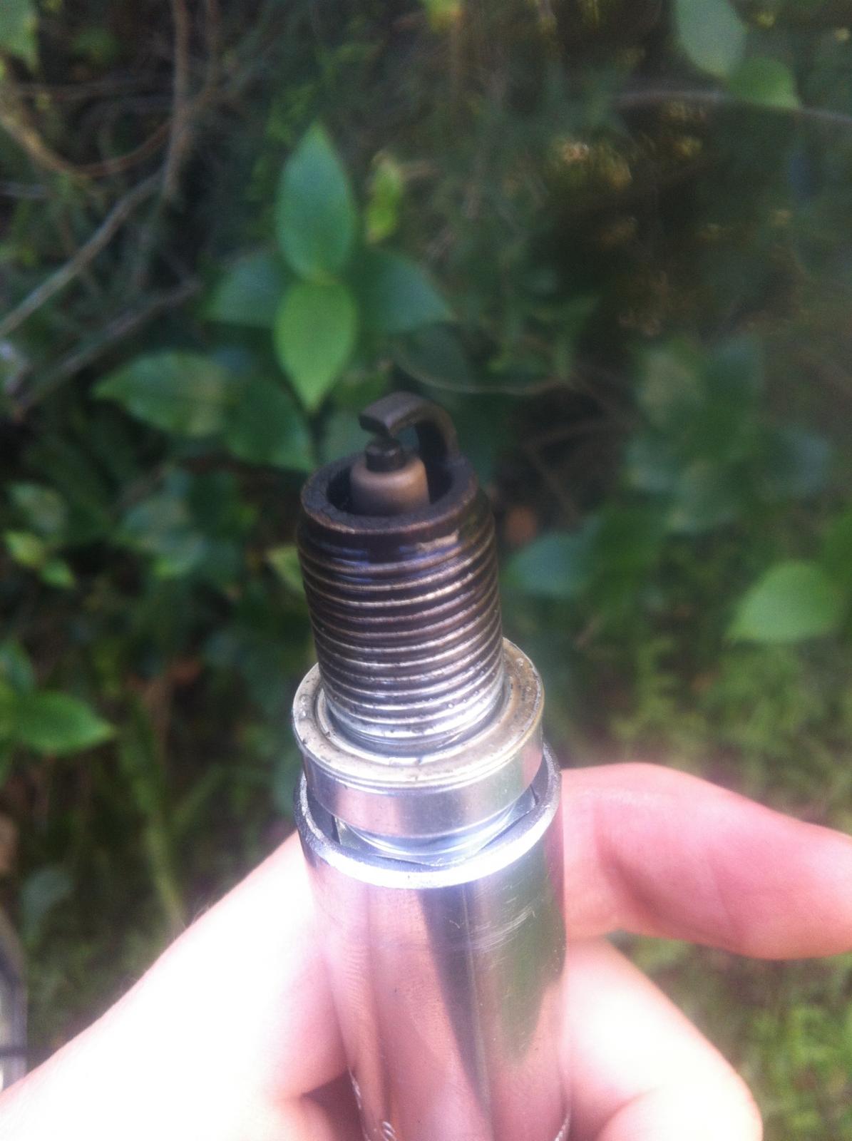

- The spark plugs will create a reasonably strong spark, but the spark is still orange and not blue.

- When I checked the plugs after cranking they were wet and smelled of fuel.

Here's how the plugs looked:
