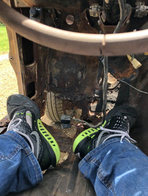

pay atention to my friends foot coming through the floor

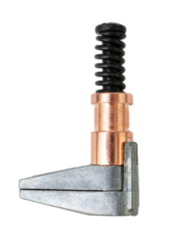

Thanks for the comparison with Binky, but those guys are on another whole level.
I have those cleco side clamps, they were on a kit I bought, but they don't clamp a 10th of what the pins does, so I rarely used them.
