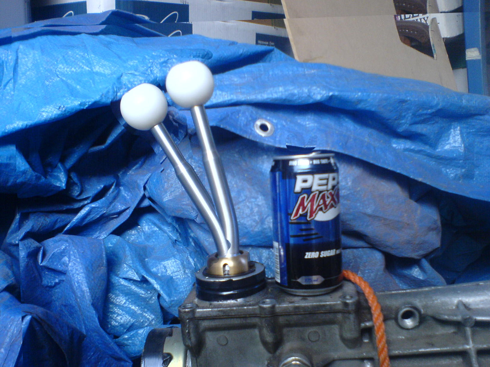

got a short shifter the other day, chucked in for shits and giggles today to see if it was any good!
well i nearly shit myself, the throw is sooo short like i mean nearly 5-6 cm gear to gear
have a look at this, did it on photoshop, did not doctor this it is genuinely 3 to 4 gear

Thats gonna be a pain in the butt for down shiftin but otherwise thats pretty cool dude :)
Not wrong about short.

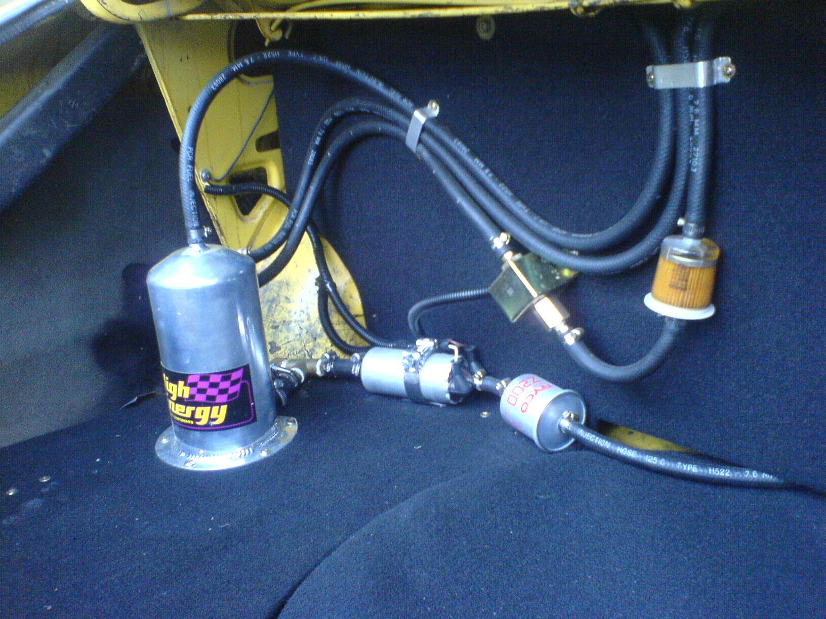

got the second fuel line under the car and the pumps and surge tank hooked up. wired them up the other day and cleaned the lines out, yuk!!
also thought it would be a good idea to change the old rubber hose that is uder the car that jions the line in the boot to the line under the car, just aswell i did as when i got underr there i noticed that there was a same line running dwn about half its length, pressed the line and got a face full of fuel, turned out to be split. lucky!!

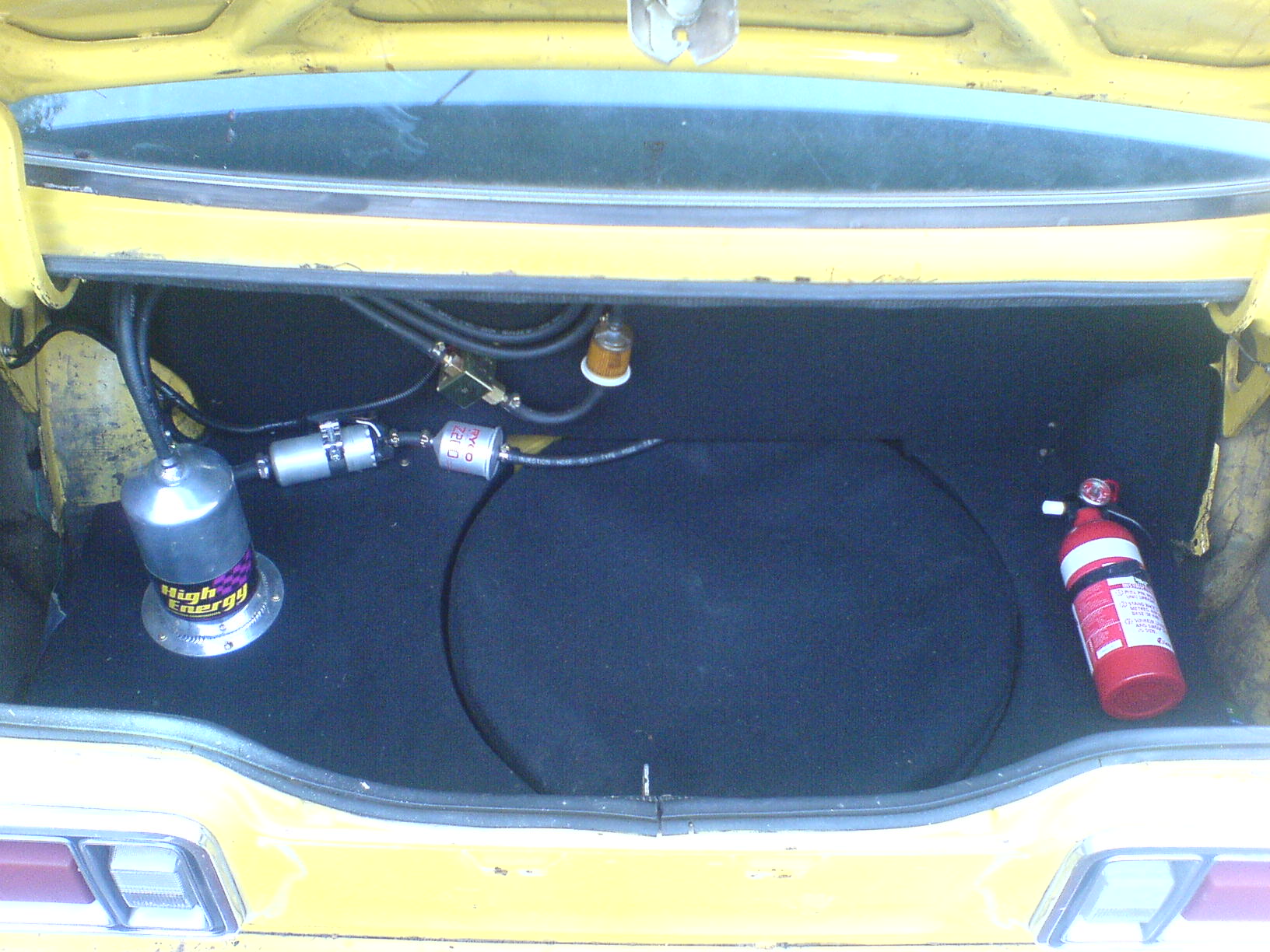

made a few hose bracket things to clean the spaggetti of fuel line in the boot, came up nice. and also made a cover for the spare tire.

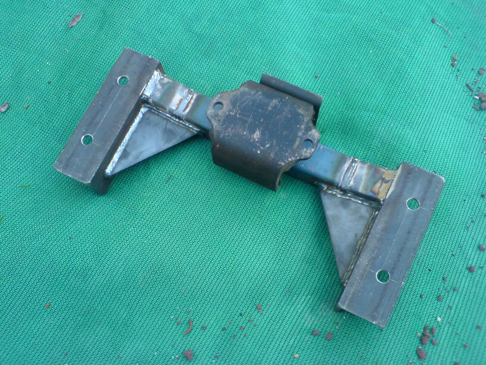

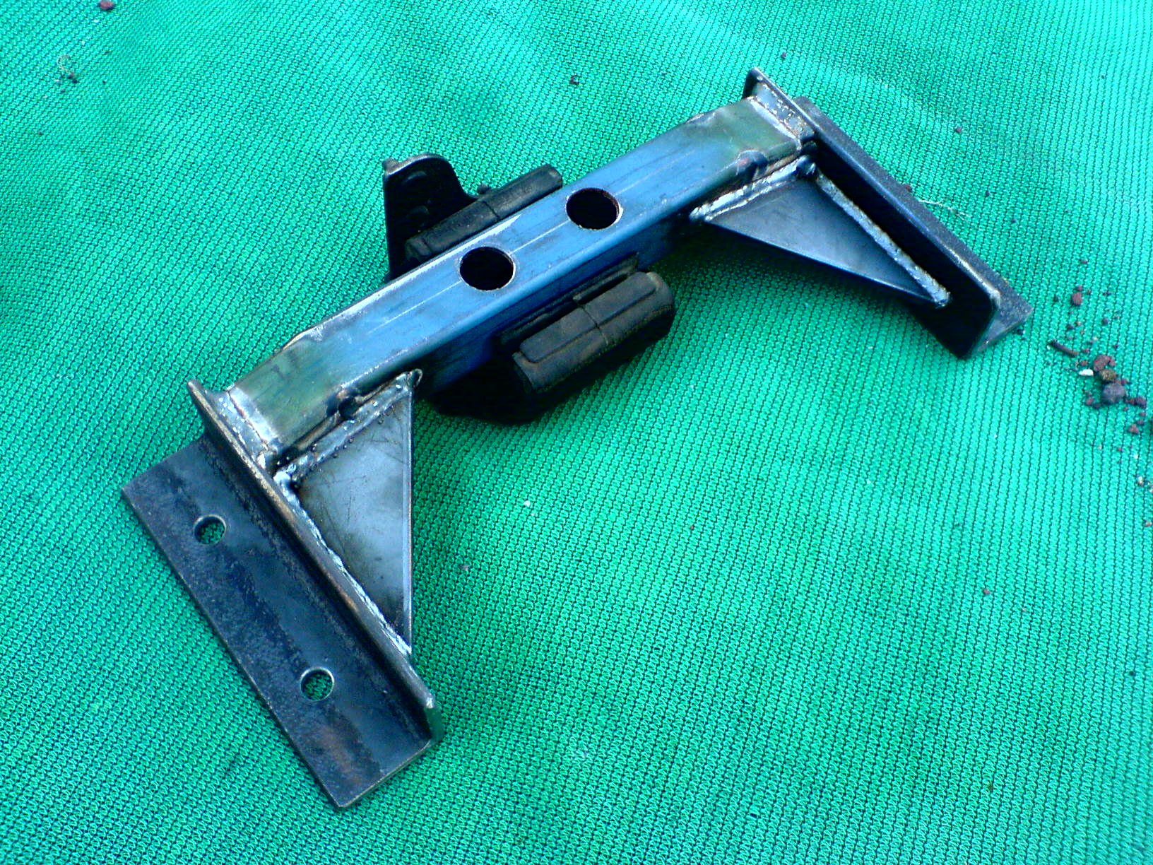

got my cross member late last week, and i must say it is a work of art, and wieghts about 4 times as much as the original ca one, did someone say over kill, but i'm not complaining. thanks to stew and lee for hooking me up.
also pics of the boot all done

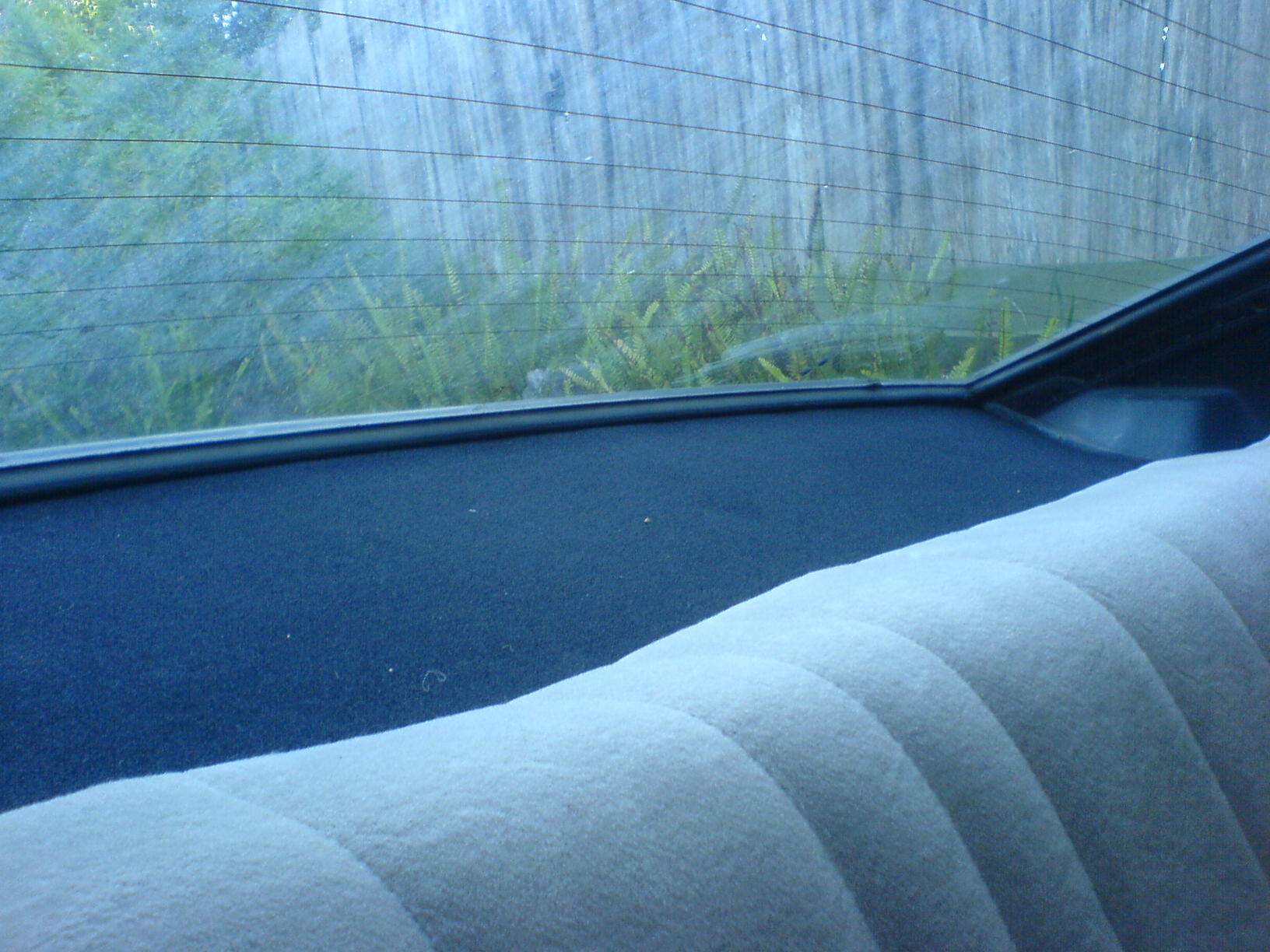

the parcel shelf

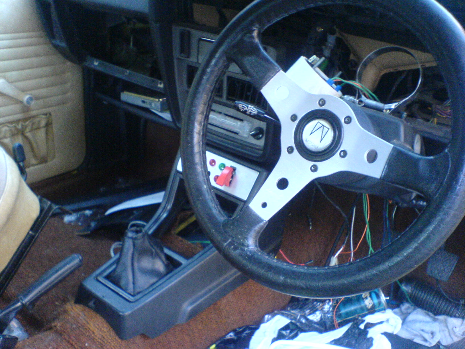

and my modified center consile
Definately a work of art :y: . Nothing wrong with overkill, looks almost identicle to mine, except for the extra triangles so the engineer will love it. Nice to see that fire extinguisher too, my bros car burnt down last week, and all he could do was stand and watch. That was just a standard camary too, performance cars should always have one! :D
Nice strong x member, looks piss easy to make guess if i take the ca18det path i might guess i have a x member design lol
