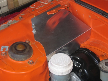

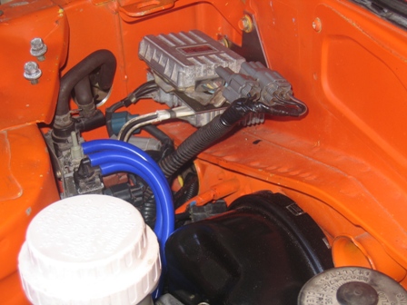

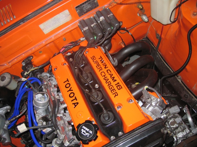

Ok most of the engine wiring has been done....Just need to do the body wiring.
Its taking a bit long as I'm trying to make it as neat as possible and hide all the wiring, I was also able make some custom brackets to put all the VSV valves, igniter, resistors and relays in one corner of the engine bay and make a custom aluminum cover to hide it all:
Looking sweet!

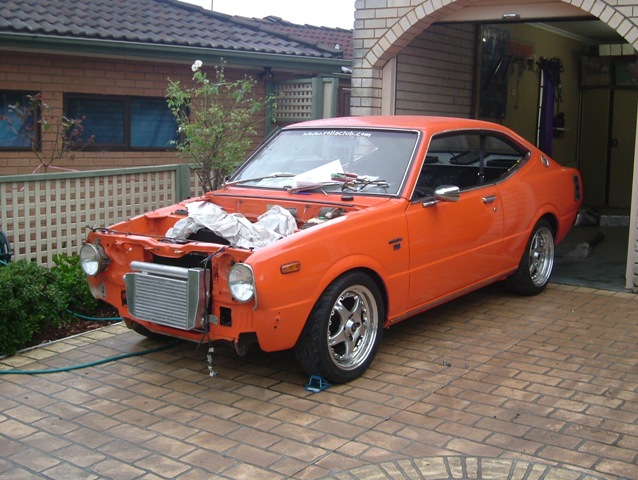

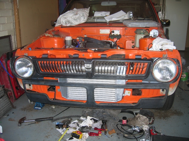

I also mounted my front mount and modified the front grill and valence to fit, the result:
I'm happy with it, i didnt want it hanging out the front to get too much unwanted attention.
looks great chris! you could even paint it black for the ultra hardcore 'don't give a f@$k' look.
Lookin very nice, finally this car will be a good all around package!!
You should be very proud of your work

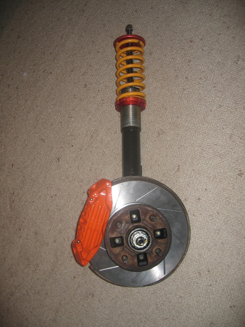

Update: Been really busy with uni and work so haven't been working on the car. Since last post just been doing more wiring, finished off building my struts, painting my brakes and re doing my rocket covers (wasn't happy with the last job). Also i got my wheels.
Newly painted
Corona struts, hilux brakes, Mr2 inserts, custom coilovers

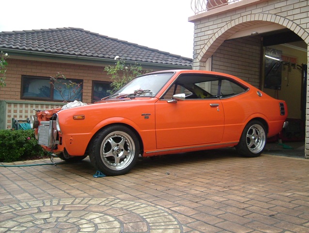

16x7 and 16x7.5 ROH 3 piece
The car is really dirty in the photos....but what do you think about the wheels? i think i still need to space the rear out a bit.
Dam that looks hot as!! I like the wheels!
Yup, Looks awesome.
the wheels are prime, i was looking at them a while ago, can you tell me what they set you back?
Yup, Looks awesome.
X2
sweet job looks great keep it up :jamie: what did you have to do to the struts for the mr2 inserts to fit?
