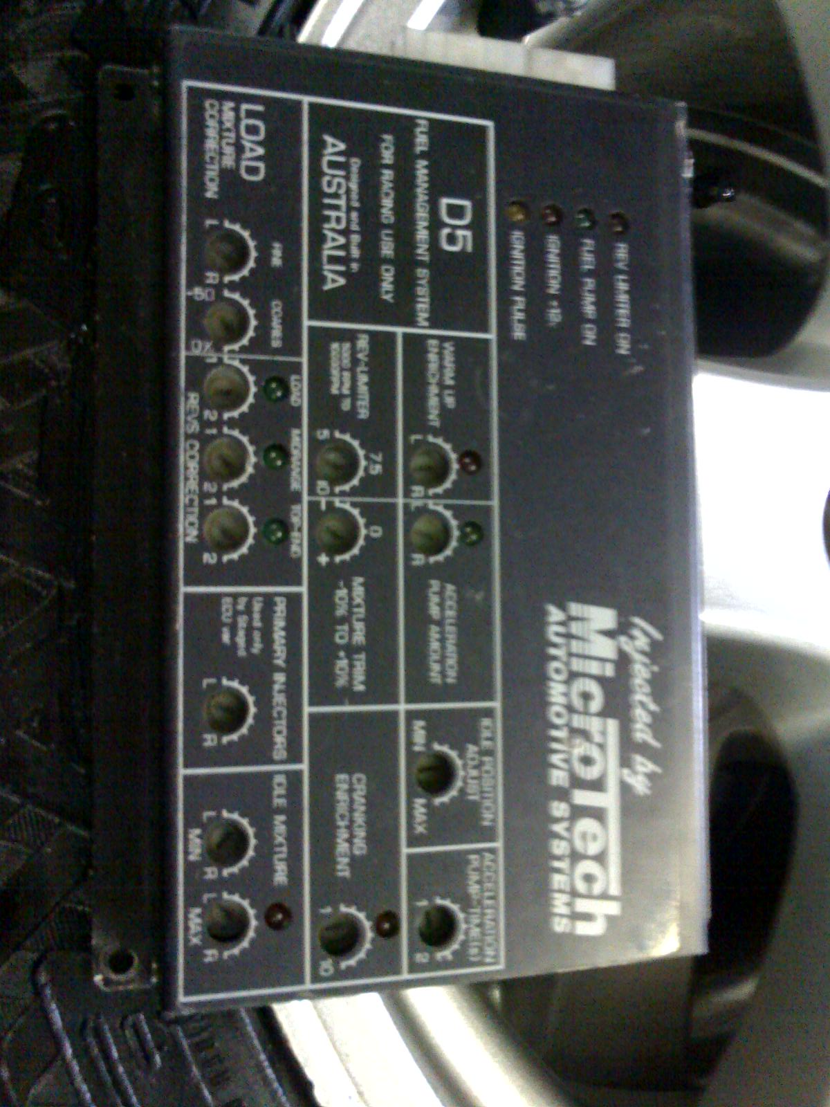

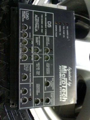

Yeah the D5 will not be lasting long as it has no cruise setup and runs REALL REALLY rich at 30% or less of throttle but sweet under boost.
16.5-17ltr/100km is a little excessive for a 5k even boosted, so i will be looking for a new ecu. As soon as funds become available.

I'm using the high imp 4AGE 100kw injectors i think they are about 250cc. And running about 44psi of fuel press at idle.
A little too small I'm thinking for the injectors, but seems to be plenty rich enough though. the lambda readings are about 0.90 under boost and 0.68 at light throttle.
Havent asked sparrow how often the dyno is calibrated, i will do tonight.
I was also thinking that ej20 wrx injectors would probably work aswell. They are a high imp 320cc injector. But all that will come when i decide what ecu ill get.

Well it seems i have fixed the economy a bit just turned the warm up enrichment to near off. Heaps better now.
