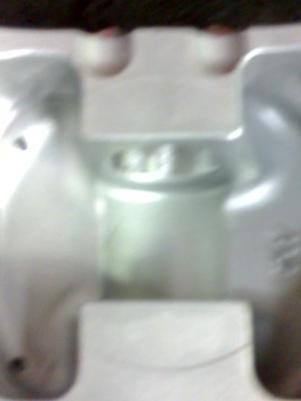

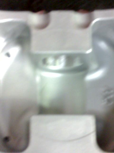

Stu, 4k and 5k dished piston heads have a couple of protrusions under no 1 and 4 spark plug holes.
If you are going to boost it, just bolt on a normal flat top head from a 3k or 4k. This will decompress it cheaply without resorting to spending a heap on new pistons. That is providing that your existing bottom end is sound. I'm assuming your motor has dished pistons as 90% or more have...

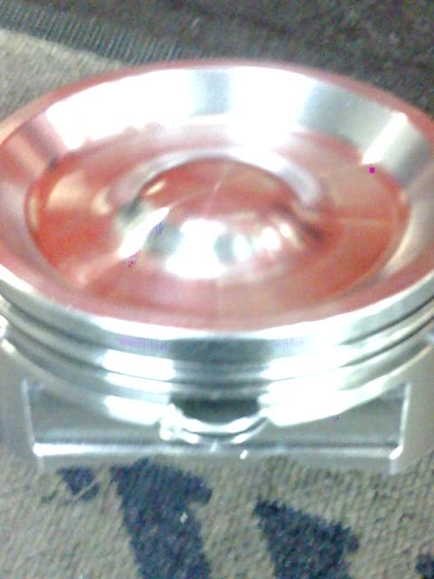

On the piston front i was wanting to find out if these heads are easy to find ill use one as i`ll be able to use a shallower dish
and achive a better burn. It wont cost me as much as you may think as i work for Special Piston Services and make custom made forged pistons. here are some i have prepaired earlier.
These were made for a nitro turbo Harley Davidson
