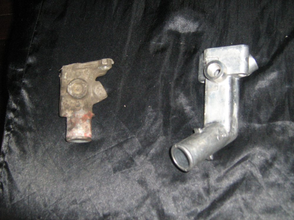

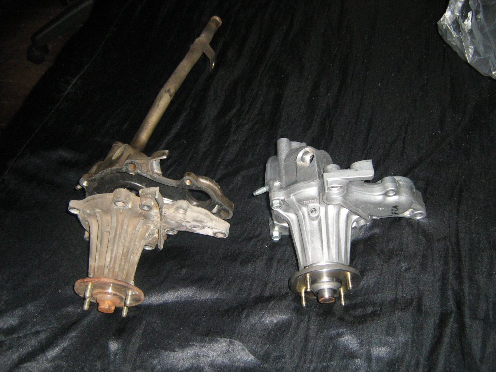

  9. Ok as it would seem, The 4A & 4AGE rwd housings are the same (I thought the single bolt pipe was the rwd 4age but its the front one) but the pumps are different to allow for the different cam covers. The reason why the top outlet does not line up with the water pump housing is the head width vs top outlet offset.
  10. Thats a 4a rwd one, I will get some pics of the differences and post them up shortly.
  11. The 4ac & 4age rwd housings are totally different, You can't combine a 4ac setup with the 4age engine as the alternator can't sit on the exhaust side of the engine, If it was all that easy i would not have spent what i have on converting my engine to a brand new rwd 4age setup.
