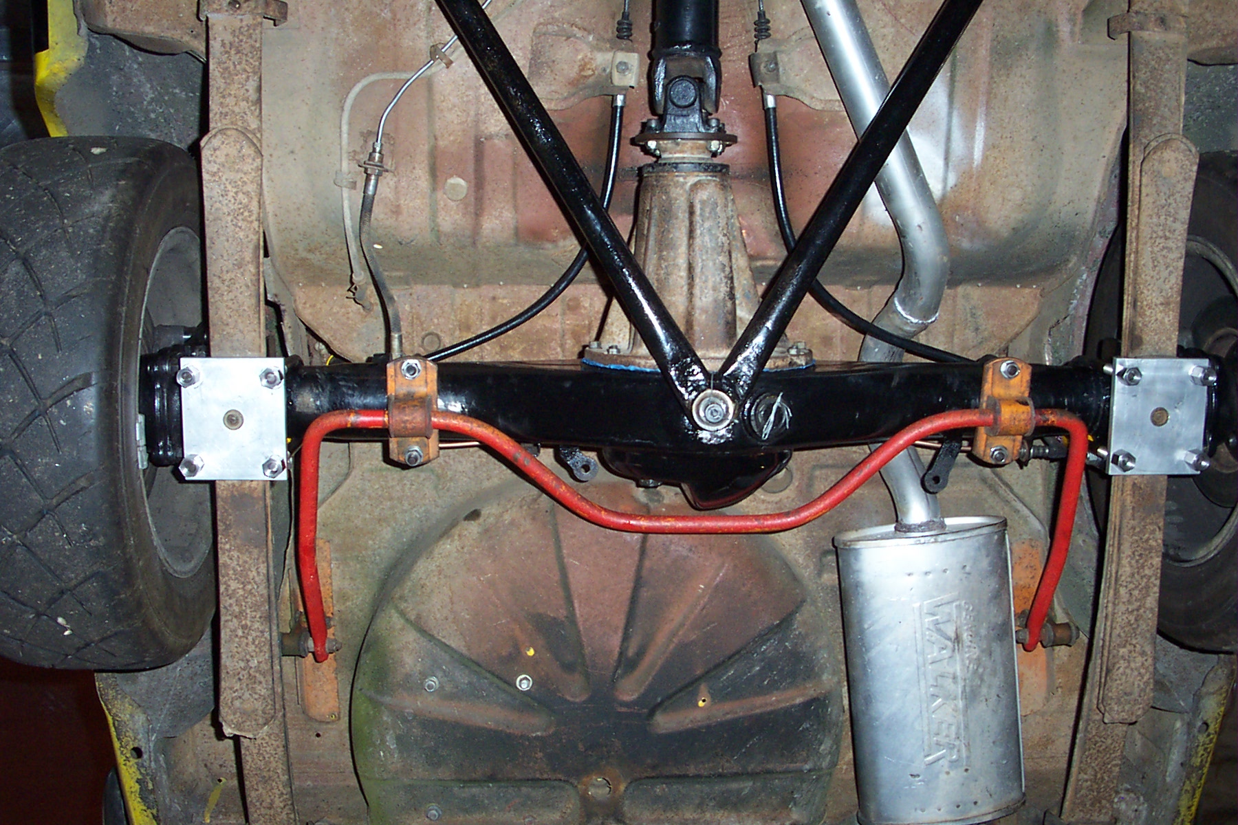

  5. Hi All, Just about to start measuring up what to fit in my new car as far as a good diff is concerned. My older car runs a TA22 diff with TRD LSD 4.9 ratio but i would like to build the next one with something heavier duty. What is the current concensus on this?? I know there is the hilux as we have this in the KE15. I have heard there is a mazda RX7 version with good ratios / LSD is cheap and has good size axles. Anyone just been through it all and can suggest the better all round solution? I expect to put about 220Hp through it and would like it down in weight compared to a hilux. Suggestions ?? Thanks David

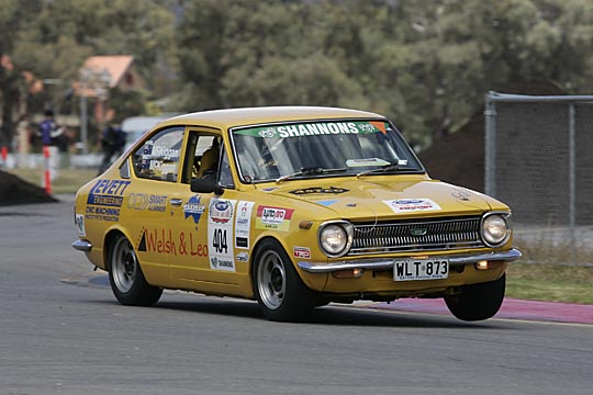

  7. This is the KE15 that my Dad lets me rally drive in. Its his car but we both enjoy the rallying driving in it! Just some of the features. Its had K / 3K / 4K & 5K engine in it. (7K sitting in the shed now) Twin Webers T50 Gear box Hilux LSD diff TRD Valves - small stem Dia. Ported / polished Volvo 4 pot ventilated front disk brakes Lotus A frame rear end. Yokohama A032R tyres Too many smaller parts to list but all work towards making this a perfect car in the wet and an great tarmac rally car. DMC

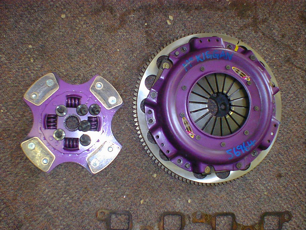

  9. We run a button ceramic / organic combo similar to the picture. Made by Extreme ctutches in adelaide. The one shown is from my 3T engine but the 5K looks the same but smaller. Also have the K-T bell housing and use the T50 box in the car. Great match for the 5K and the low ratio gear set we run. Maybe its more of increasing the spring pressure on your clutch plate. Usually they ask you power and torque and then they make you the correct part for what you are running. Just a thought.

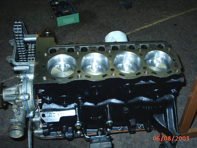

  13. I too agree with Old Corolla Bloke... interesting lack of understanding of these engines. I have developed over the years of racing the following engine combo: 3T block - Bored to 89mm (Ultrasonic tested for core wall thickness- some you just throw away..) 3T crank (crack tested) TRD 89mm Piston Kit (made by Wisco now anyway) TRD 304 deg. Exhaust Cams TRD 288 deg. Inlet Cam Vernier down hole cam gears. Double Valve springs Oversizes intake and Ehaust valve Ported / matched ported inlet & exaust manifolds twin webers All chain guides changed to PTFE material. Compression at 10.5: 1 (But have run 12:1) Steel 4kg TRD flywheel Larger head gaskets are easliy purchased - just expensive. Results have been 210 Bhp at the flywheel / 150 Rwkw. But ever dyno shop gets a different result. To sum up these are a great engine when you port them larger and cam them. I have 2 sets of the inlet / exhaust cams and the TRD book says the next combo to try is running both inlet & exhaust at the 304 deg duration. Have not tried this yet but it would be interesting. I have lots of fun racing with this and have had a good run of realiable engines. Just my two cents worth.. DMC

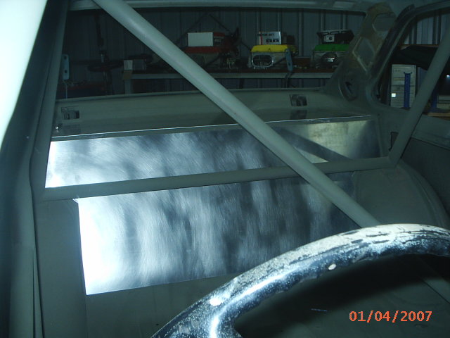

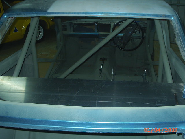

  14. Hi All, Another small step in the process. The car is back from blasting the internals out (3 weeks longer than promised!!!). Now ready for the rear ally panels to seal off the top & rear bulkheads from fuel. Just need the rivets to fix into place. Also the brackets for the TA22 fuel tank are to be made to fit in the boot where the old one was residing. Both will be done over the easter break as well as a group sanding effort on the rest of the body. Another quick job of the seat brackets to be finilised for the set of Velo's to be added when painted. Hopefully looks like a car once the paint has been done. The next set of photos will starts to show real progress. DMC

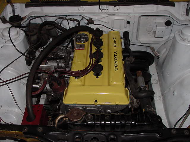

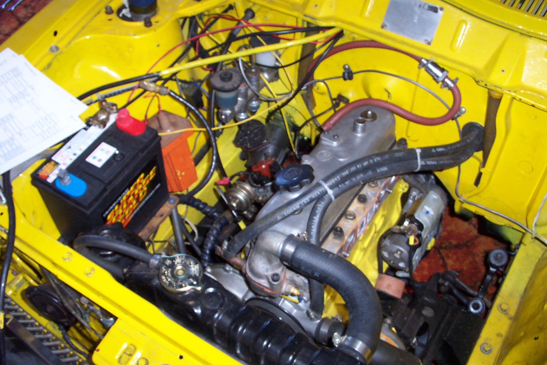

  15. Hi Retro, As the KE20 came out in Japan in the Levin spec it had the 2TG as the standard engine. It actually bolts straight in. You might just flatten out a couple of the bumps on the fire wall so you can remove the rocker cover easily and taking the engine and gear box as an assembly you need to gently wiggle it over the steering arms but it all seems to fit in snuggly. I think we ended up using modified engine mounts to move the engine forward about 20 mm to give it more room. You can see in the photo where the engine mounts are it is slightly off set forward. This way the cross member stays unmodified and you just use the mounts. Hope this helps. Great engine for this model. David

  19. Hi Sean, The uprighting of the engine with modified engine mounts makes it easier for the twin webers and the exhaust system. The only other mod is a slight mod of the gearbox hole and to bend the gear stick slightly so it does not hit your legs. We run the celica T50 box with a set of TRD lower ratio's which gives the car excellent off the line acceleration. The diff has been changed over to a hi-lux LSD (wont be breaking that one!!) and it runs a 5K motor with numerous internal mods. My dad is the expert in these K series motors as he has raced them most of his life. From K , 3K, 4K , 5K and now he has just finished his own fuel injection system for a 7K he is putting into another KE15 body (he has 3 in total). My engine expeirence and shed full of parts links back to the 2T - 3T , 3TG engine due to the ke 20 i race. Getting a car log booked is as simple as filling out a CAMS application form but...... once you race the car it needs to be inspected to the level of competition you are going to compete at. For Classic we run in Comp so it needs a full cage, seats, using racing suits ect. If you were to do a circuit sprint you can do this without certain certification. As soon as it involves CAMS it always starts to become technically difficult!! Our KE15 was used in racing 20 years ago so it has a log book that goes back awhile. If the KE20 is not ready we will run the 15 again. I hope to start afresh with parts but can always unbolt certain parts of my old car. Only time will tell which path i will take. Will post the tranformation as it happens. David

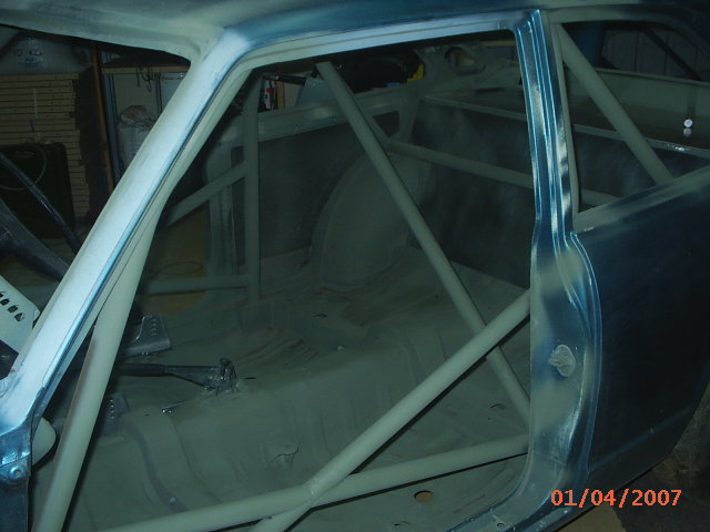

  20. Hi All, Just thought i would inroduce myself and my project for the year. Just updating my KE20 to a better body and make it in line with the rules for Classic Adelaide & Improved Production Racing. My Dad and I have done the classic 5 times in a 1969 KE15 sprinter and it was time to change up to the 2ltr 3TG option. The car is getting a blasting internally at present and then the paintwork can start. It has already been issued with a CAMS log book so i can compete in the IPRASA rounds as well. Will keep some updates coming when things look more complete. DMC
