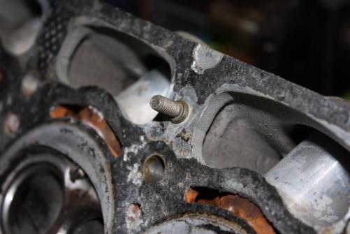

Yes it's quite odd. It actually looks like exactly the same stud as what it used for the sump from the block side. It looks fairly factory and like it should have something attached to it, but never mind! The next question would be, are D dish pistons still available? ACL doesn't seem to indicate any.
5K Head, What'S This?
Thanks for your help folks! Very much appreciated.
Yikes, this would be around 1mm deep. It seems like a lot to have taken off of the head. Anyone know the cc for one of these heads? I get around 16-17cc I've read through the faq quite a few times. Thank you for the offer of help. It's a shame if I can't use this head, the port shape is soooo much nicer than that of the 3k's that I have. Is the 4k head any better??
What sort of depth does it have normally? And I guess this is a good segway into planning what to do with this block. I have most bits, but I don't have any lifters, so it will need some sort of conversion. This opens me to getting O dish pistons and maybe putting a 4K head on it? But then I need to work out push rod lengths. Does anyone have any advice on that topic regarding which direction to head? :) I was planning to bump the compression up to around 9.8 to 10. Cheers
Just for clarity, this appears to be a 5K head. It has the lugs on 1 and 4 and came with a D dish piston block.
I don't quite get that so far. It's a lug, but it has a thread? When I mated the head to the block it didn't locate to anything, it just fell into an empty area in the block where the lifters are, not locating anything at all. Has it been surfaced that much, i.e. is it knackered?? Please say no! :)
Hey folks, Just got hold of a 5K for rebuild (thanks SLO-030). Having a look over the head, and it has a stud in it that points down into the lifter gallery. Just wondering, can anyone tell me what it's for? Cheers Mike
