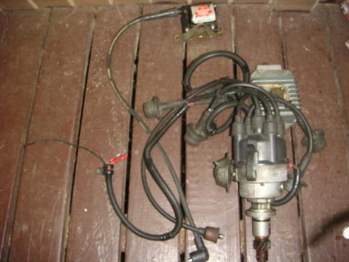

  9. It seems that it is a kit from the '80's. This is good and bad. It appears that parts are probably no longer available, so if ever goes bang that's probably it. On the bright side it should mean that I've still got a suitable 4K ignition curve, so it should run pretty well. For future reference I've attached the installation manual. bosch points conversion.pdf
  10. Legendary work altezza, as always. I'm sure I'll refer to this as I sort my electronic dizzy.
  11. Mine is a Bosch. Does anyone know about the Bosch distributors? I'm actually a little surprised by the setup that I've just received. Bosch body with an optical sensor plugging into what looks like it might be a CDI box? Then it hooks up to a Bosch HEC coil. I always thought that K electronic ignition was Denso and hall effect or similar, not optical. I'm told it works, but haven't had a chance to try yet. Edit: Actually, what I have looks exactly like this. A bit of an initial search and it looks like a Bosch kit, part EK40. Can't find more though. Hopefully that means my dizzy is still from a 4K and the advance hasn't been ruined!

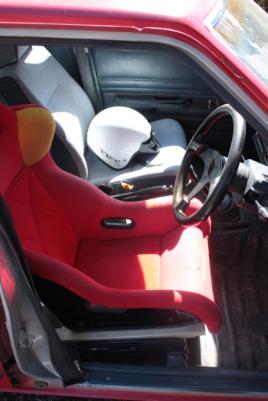

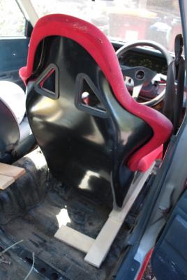

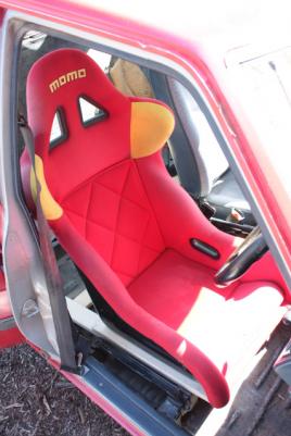

  14. Finally grabbed a few hours this weekend. The wheel is finally on with a new 35mm spacer. Sits much better so I can squeezy my lanky legs in. Picked up the seat and started trying to mount that. I forgot what a horrible job this is! Ended up hacking up the stock mounts to get both lower runners. I'm thinking of removing the rail, using the feet and welding up some sort of steel square frame in RHS and welding the feet on that. I think that will be the easiest way to keep the whole lot level and make it strong. The horn button will go in when I get to centre the wheel. The seat feels very nice though and saves around 5 kilos. Might be less when I give it a decent mounting though! :/ I'm slowly getting the cockpit sorted though, so I'm happy about that :)
