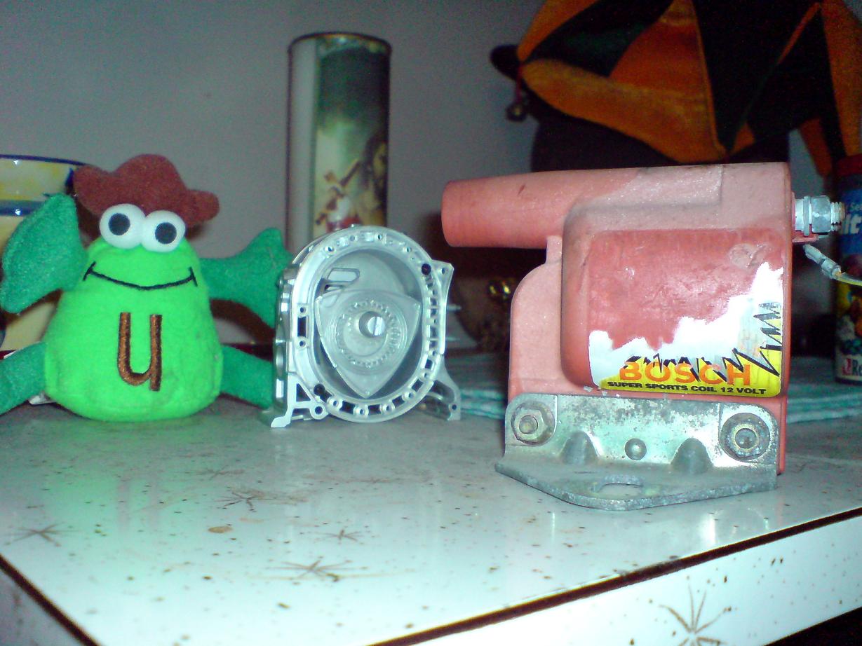

  9. Can I use this coil with my electronic ignition? The car is a KE11 and it has electronic ignition. It looks standard but may have been swapped at some stage. All I know is it uses the same rotor button as the Toyota Liteace (5k) Can I just swap the coils over or is there more to it? Excuse the toys in the photo.
