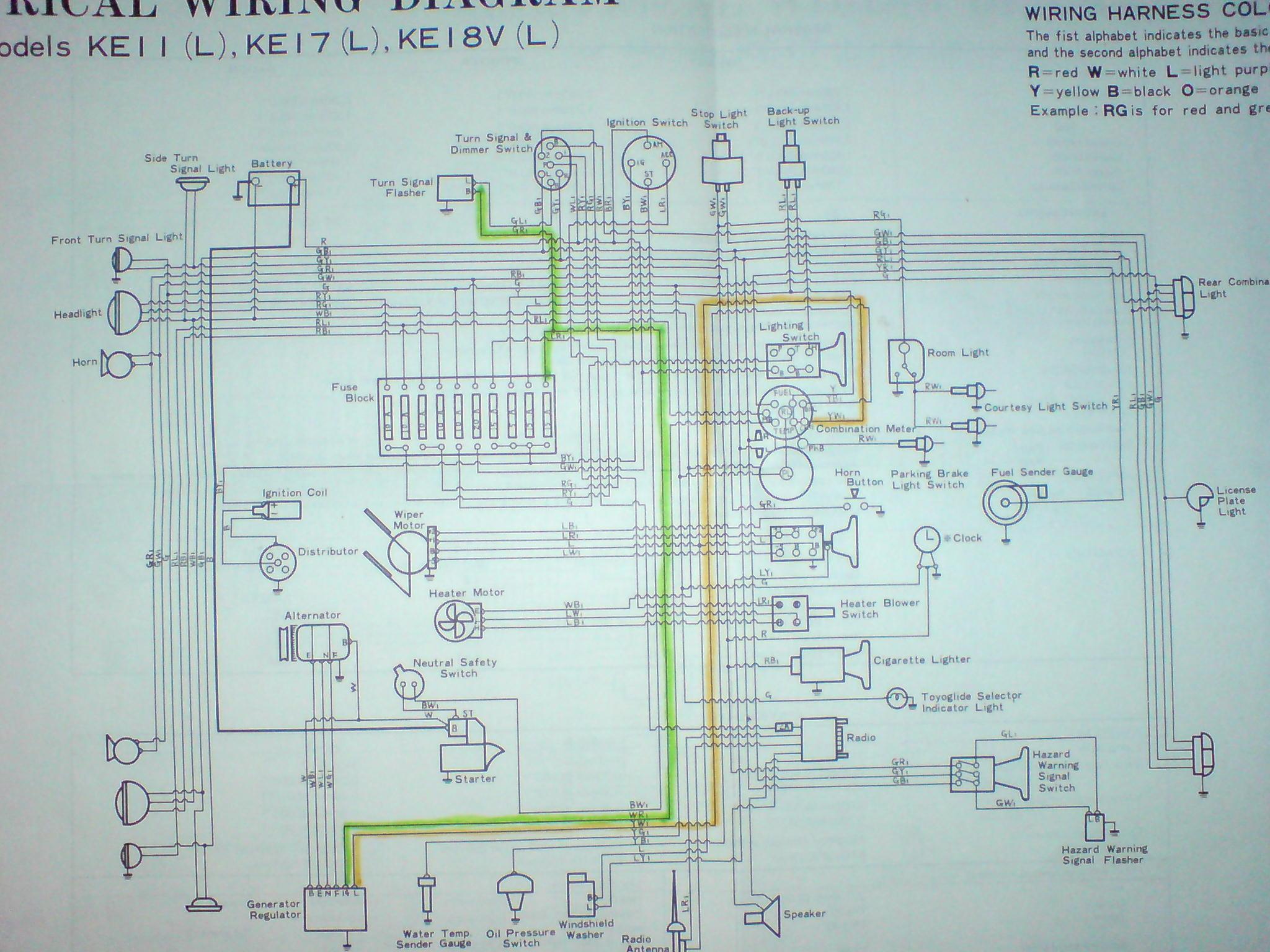

  16. So did you just connect these both to the D+ on the alternator? Thanks heaps for your help. I’m a noob when it comes to electrics.
  17. Thanks a lot for you help. So could I also run the Turn Signal Flasher wire to the D+ terminal or where would you recommend for 12v?
  18. Has anyone changed the alternator in a ke11 from the external to internal regulated type? There is an extra wire going to the regulator compared to other KE’s (I think) which is for the “Turn Signal Flasher” I understand that when changing to internal type reg the Charge Warning Light wire runs straight to the alternator but I don’t know where to put the Turn Signal Flasher wire. Could I just join it to the Charge Warning Light wire and to the alternator?

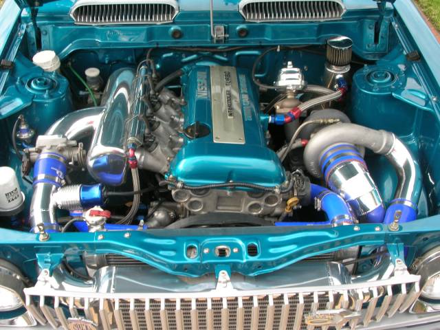

  19. Ooooooo. Pretty. This is probably not too far off completion. Not at the rate you work anyway. Good on ya mate. So ya can’t put a crappy N/A 12a or 13b in there but you can put a SR20 turbo capable of 400hp!!! That’s a bit silly.
