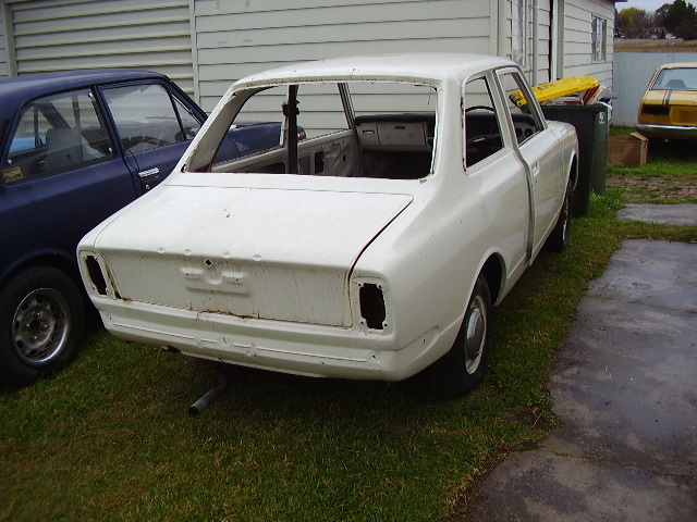

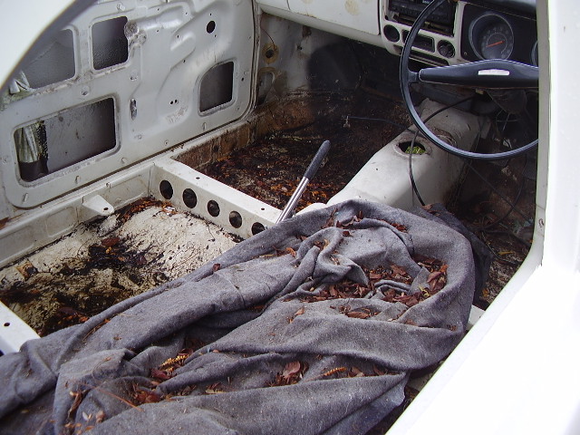

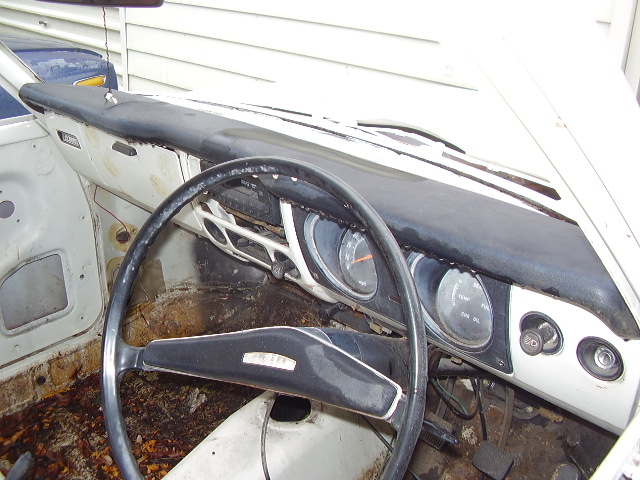

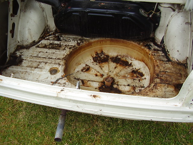

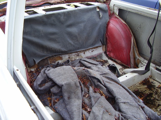

  8. Unsure of build date, haven't had much time to look at it yet! Got the ke10, a ke11 and a load of parts on the weekend. It's a rolling shell that came without an engine and gearbox, and, as far as I know, everything else is there. It just needs to be put together. So the plans are: - Give it a good wash - Get a rubber kit for it and put the windows in it as soon as possible, to stop it becoming waterlogged. - Whack everything else back in it! :bash: Planning on putting an uprighted 4K, downdraft webbers and a t50 in it. Not sure what I'm doing about the transverse spring and all the other quirky stuff, I haven't had anything to do with ke1X's before. Tinting the windows, not sure about the chrome bits for the outside, Putting most of the red interior back in it, whacking in some gauges and a nice exhaust that's loud but not stupid and keeps the gasses flowing. Maybe a straight thru 21/4" or something Anyway, this is just a quick write up for now, I've kinda gotta go. I'll keep updating this regularly, as I am planning on having it together within two months as a daily drive (money permitting) I'm really happy, this is the first car that I have bought that doesn't have a tonne of rust or a f@$ked crash pad! Edit: Ok, so where I had to be, I didn't have to be! Um, so continuing on, I am going to be buying some classic loop pile carpets (black) and I am more than likely going to have to reupholster the front door trims as they have had holes cut in them for the speakers, and I don't want to put the speakers there. I am also going to have to repupholster one of the front seats. It only had a couple of cracks in it, but my naughty dog decided it looked tasty and knawed holes where there were once cracks. He was in very big trouble! The glovebox lid needs a new coat of paint, and the whole car needs a really good clean out as it was sitting for I don't know how long. I'm also after the grille type panel that fits between the bonnet and where the windscreen wipers are located. If anyone could help me out with this it would be great :y: Do other ke1X owners on here still have the original seat sashes? I was considering putting in the safetly retractable seat belts in, but Robert reminded me that that could be a real engineering drama. Also wanting to get more of the wheels that are on it and put some redwalls on it! Anyway that's all I can think of for now

  10. Name: Kylie Barling Car: ke10 Corolla Shell Motor & Driveline: None at the moment, blank canvas! Suspension & Brakes: Stock Wheels & Tyres: Stock Interior: None! Planning on putting the red interior back in it, minus the front seats, which I am going to replace with racing seats Body: Nice, straight body. No rust, pretty good respray in original white, needs a couple of bits fixing. Other: This is a rolling shell - all parts bar engine and gearbox came with it and I am in the process of sorting out a rubber kit for it so it stops becoming inundated with rain!
