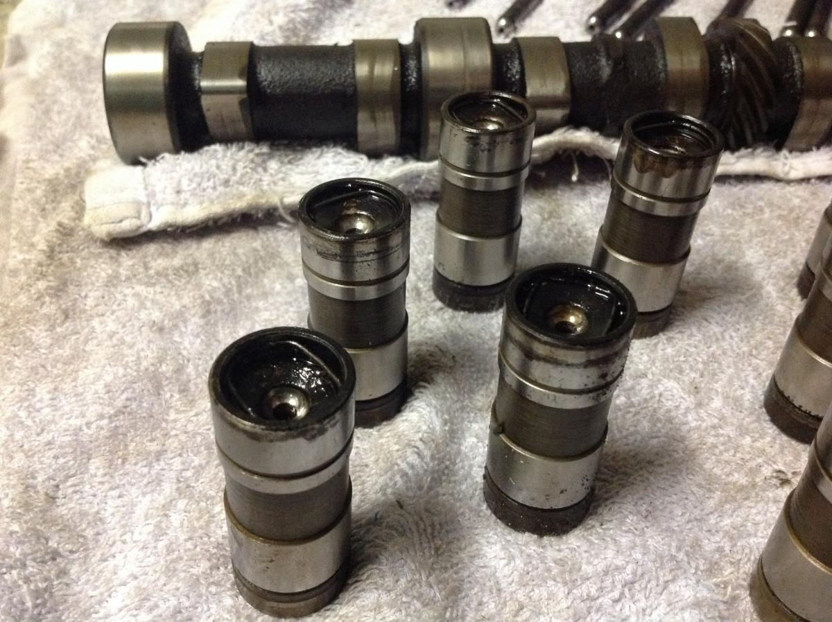

  16. If the gutted 5k lifters and 3k rods work, use it. or you could run chev solids with a12 rods. The could be machined down.
  17. You could even have to a12 pushrods machined down a few mm as they are a solid item.
  18. If you we're to put a 2mm shim under your 4k adjustable rocker posts and used the a12 rod and chev combo you may have the clearance and adjustment to get away with it.
  19. This is a lot to get you head around at first but you can work with it. There are 2 hydraulic 5k's & 1 solid 5k. Yours. Deep piston, 76mm shallow combustion head(same as 4k-u), hydraulic lifters, 150mm ball & ball pushrods. Mine. Shallow piston, 82mm deep combustion head(same as 4k-c), hydraulic lifters, 156mm ball & ball pushrods. From all data I've come across the 3f solid lifter is assumed to be the same as the 5k solid. I have not seen or read anything that has confirmed that tit bit. I've never seen one or seen images of the 5k solid lifter/rocker gear. It could almost say it's mythological. Datsun a12 pushrods are 152mm and work great with chev small block solid lifters. People say 202 solid lifters but all 202's ran hydraulic lifters. Anti-pump hydraulic lifters were designed to replace hydraulics in performance applications to eliminate lifter float at high rpm. My set up is shallow pistons, 4k-c head, 202 anti pump lifters, a12 pushrods and adjustable rockers on a solid cam. I run 0.10mm valve clearances. Any more and it rattles. In my next build ill run hydraulic. Any rocker adjustment required due to cam lift will be countered by shaving or shimming the rocker posts accordingly.
  20. You will need ball and cup pushrods 150mm long.
  21. You need 150mm pushrods and non-adjustable rocker assembly to run hydraulic lifters.
