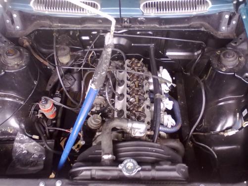

Yep just waiting on induction and i've gotta wire up the dizzy. Otherwise just a couple of bits to fit and its brappin. Then i'll have the interior to worry about.

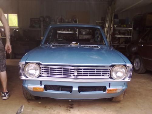

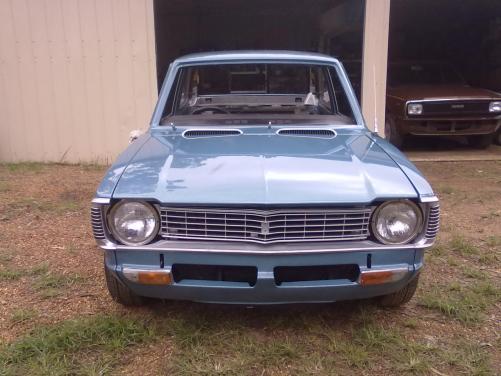

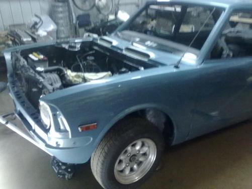

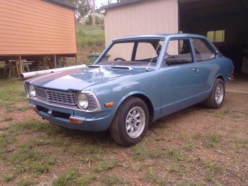

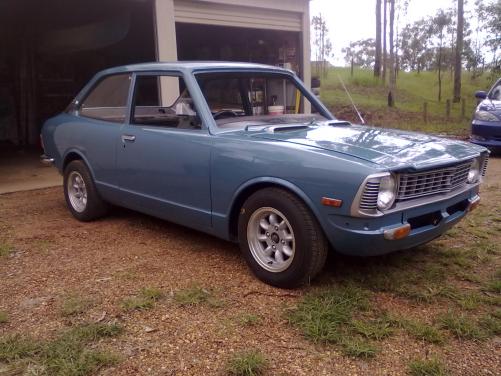

Most of the front end is on now. Including the bonnet & catch. Still have to straighten the grill as it looks on the piss, clean up the front bumber or find a new one and clean up and fit the bonnet garnish. Everthing in the front end has been fitted or redrilled and fitted with zinc plated M8 bolts and nylock nuts. I think it looks PHAT!!!

I'm using a redline manifold with solex carbs and I have about 45mm between the the strut tower and the cylinder 3 runner in the ke20. -

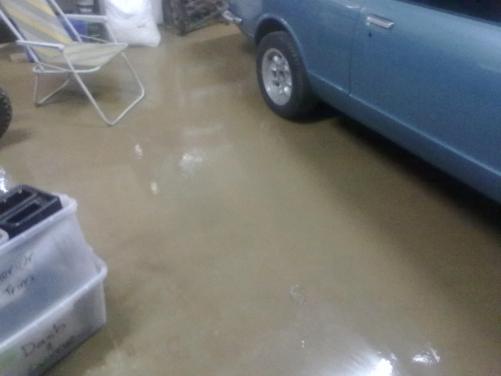

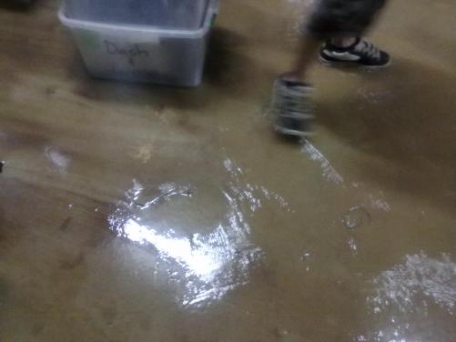

The Logan river has risen about 8m up my end the river way will take a 10mm rise before it goes over but towards to the coast its over. About 1:30 we got a downpour that lasted 30minutes. 15 minutes in, the water outside had risen up and above the level of the concrete and flowed in under the corregated iron. Happens whenever riduculous amount of water comes of the sky in a short amount of time because the drainage systems here are f@$ked, so everything of value is off the floor and all my gear is in the big containers you can see in the pics. Good thing dad's house is on stilts too....

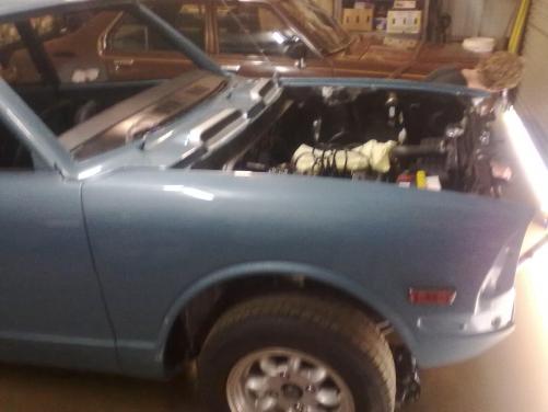

Tieing up some loose ends today. Fitted two missing gearbox bolts, the gearbox cross member bolts, fitted the selector and fitted a plate over the big hole where the select use to be. The rear half of the carpet is down. New heater hoses, and radiator cap. Got my roof mounted aerial fitted to the guard... uber cool. Painted up the bonnet hinges and stand. Fitted the fender indicators and beaver panel. Then the flood came and put an end... ...to everything.

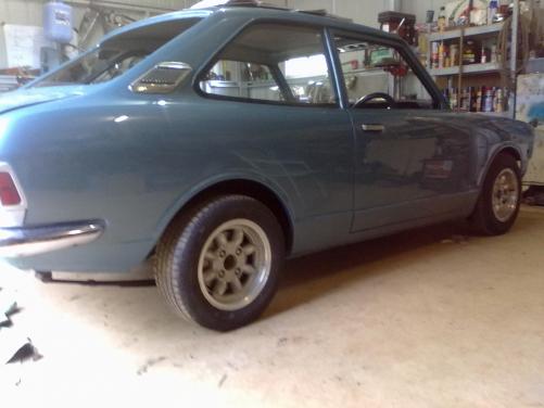

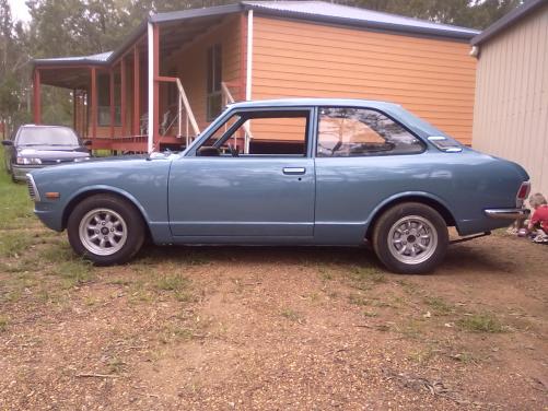

I think he's just talking about the rear shock absorbers. If he is talking about front strut inserts, I think pedders do a comfort ride short stroke insert but only to suit 38mm lower and there is no straight forward strut swap for a ke20. Modified control arms would be required. The struts would then need to be shortened to maintain the ke20 geometric stance. The struts would then required shorter inserts and springs. Not cheap. I went 55mm lower in the front but the suspension shop had to shorten the strut leg. Kings only make a 38mm lowered spring so mine were recoiled to suite 55mm. No one makes a short stroke insert to suit a 50mm lower spring so 'Boge' VW golf mk1 short stroke inserts were used with bump stops. Its more like a half coil over. The rear I used 50mm lowering blocks ke55 leaf springs and 'Boge' ke55 shocks. It went like this...
I used Boge ke55 replacements. Solid as. Had use a 2mm sleeve inside the lower eye. You could also drill the lower shocky mount to suit the 16mm eye on the shock...

1 1/2 inch lowering blocks for the rear - $90 or so. 1 1/2 inch kings springs for the front - $125 or so. if you want to go lower your looking at $250 for 2inch because they don't make springs lower than that for the front. they have to be recoiled. It cost $740 to have my struts shortened, short stroke inserts and recoiled 1 1/2 inch springs to 2 1/4 inches and that lowered the front a total of 55mm. you can get 2 inch lowering blocks for the rear also, but i'd recommend upgrading to a ke55 shocky to add a bit of hard to the rear end and there about $160 a pair depending on brand. you'll also need a sleeve for the lower shocky eye because the 20 shock uses a 12mm pin and the 55 uses a 16mm pin.
