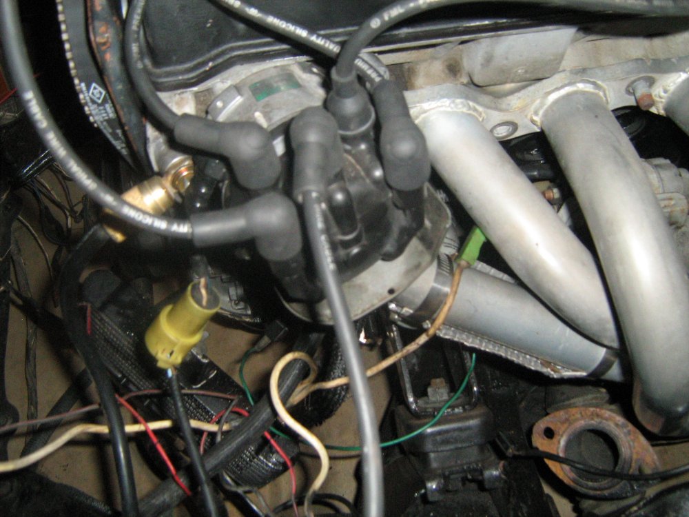

Well lastnight i said to myself 'I'm getting the van running tomorrow' so i took the 4ac points dizzy and one of my 4age dizzy's and swapped the gears over so that the 4ac dizzy would fit so i can start it, This is only a temp solution until i buy a 4ac electronic dizzy, I didnt worry about indexing it as its just sitting in there, After a few hours of playing around this arvo and getting it to spark good it finally fired and ran for 10 secs, I would of liked it to run longer but its a bit hard with no throttle linkage hooked up and a K motor fuel pump being used by hand to fill the carbs, I will try to get a vid of it running tomorrow.

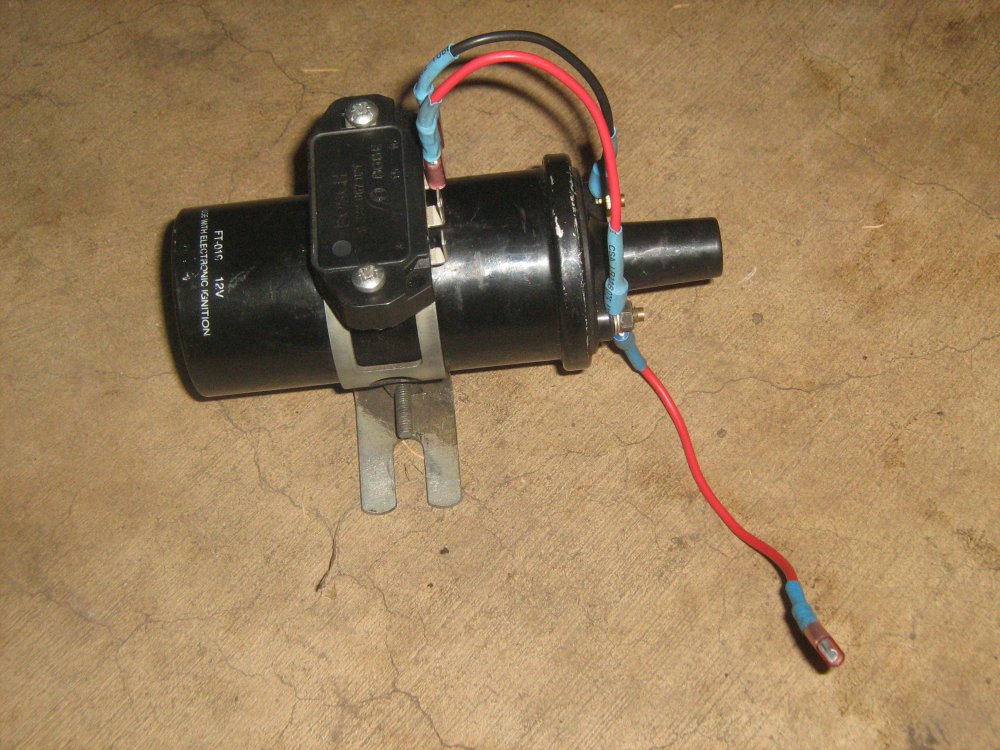

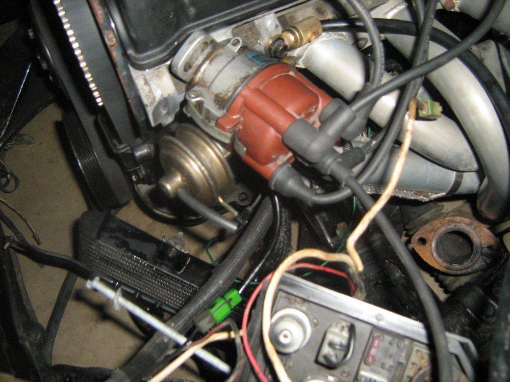

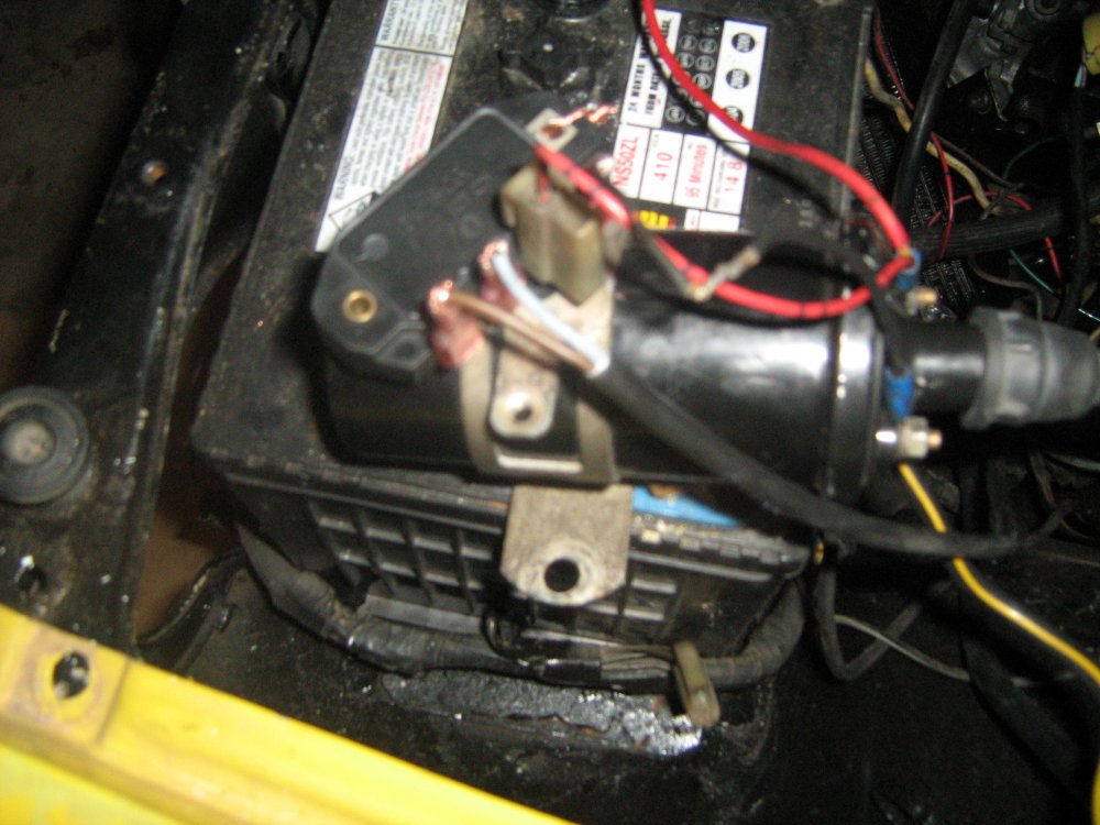

Decided to get rid of the points dizzy and go with the 4age dizzy/coil setup and use the ignition control module out of an ae82 electronic dizzy, I don't have advance but who gives a shit, I might buy a controller at a later date, The spark i have now is way greater than the points dizzy even with a shitty earth to the engine and ignition system, Here are some pics of the setup and a short vid of the spark:

I also took the coil and ignition module to work and situated it where the ignitor normally sits and make the wiring pretty:
