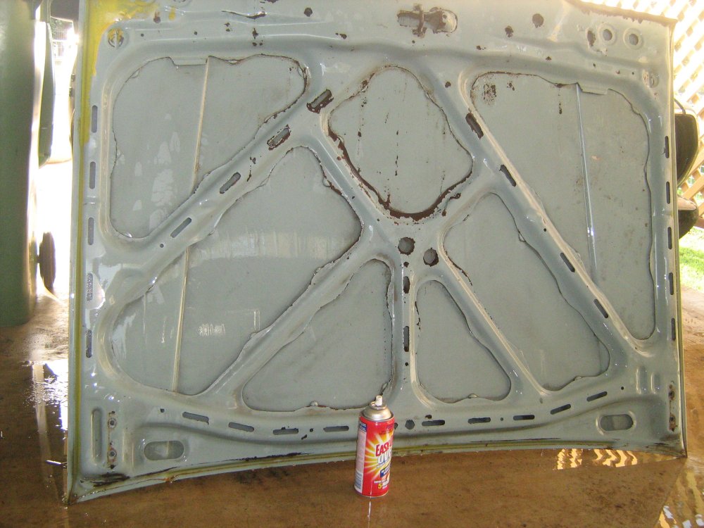

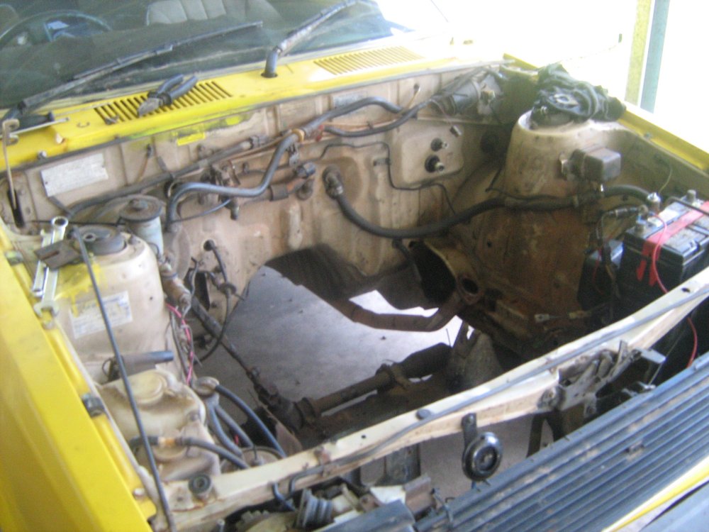

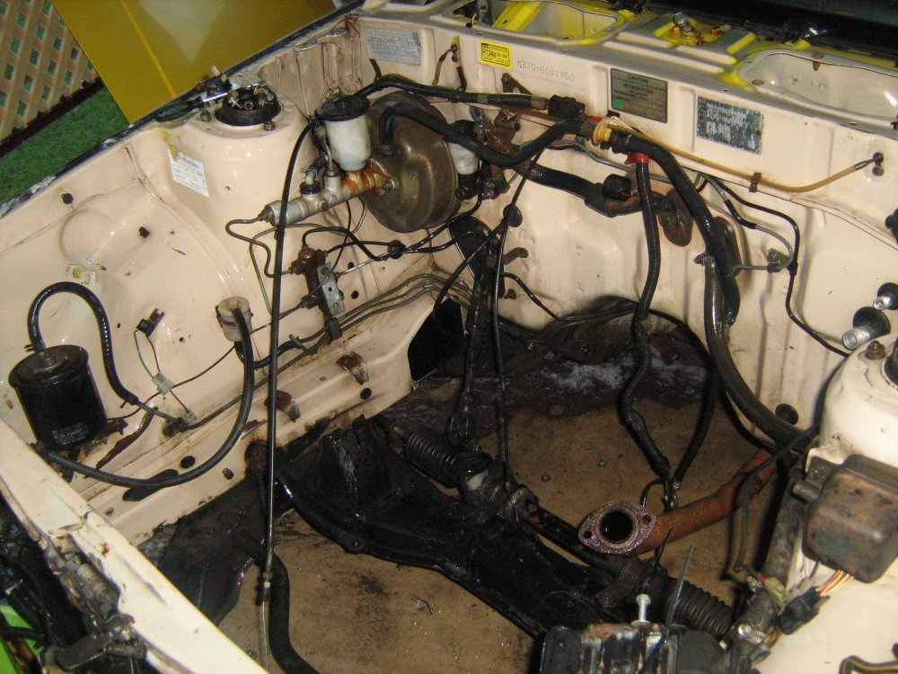

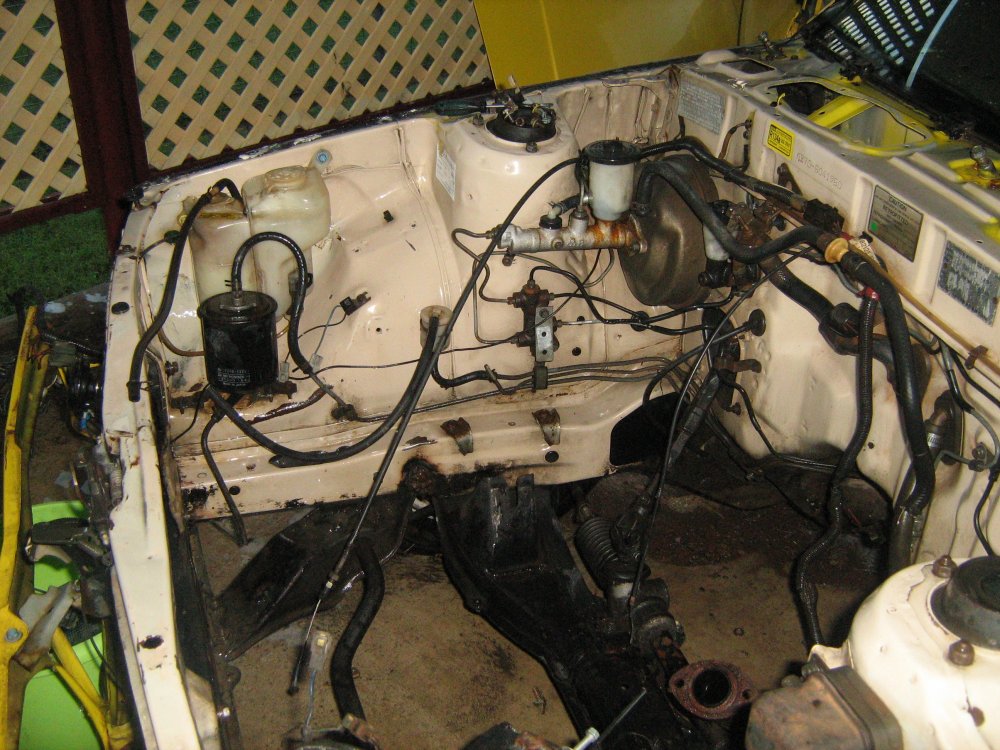

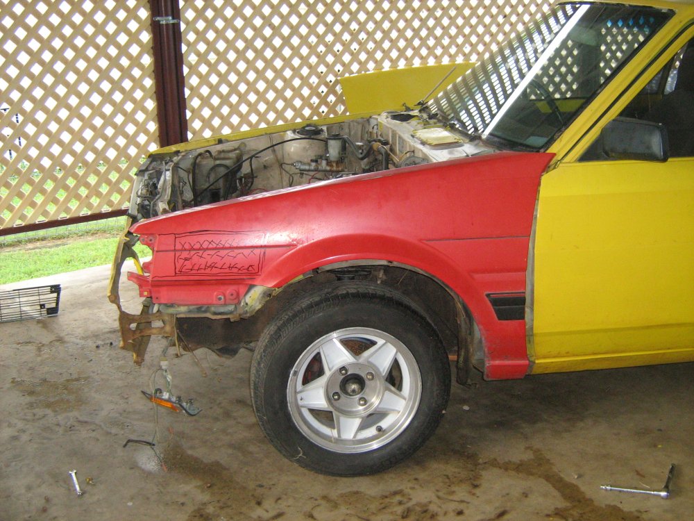

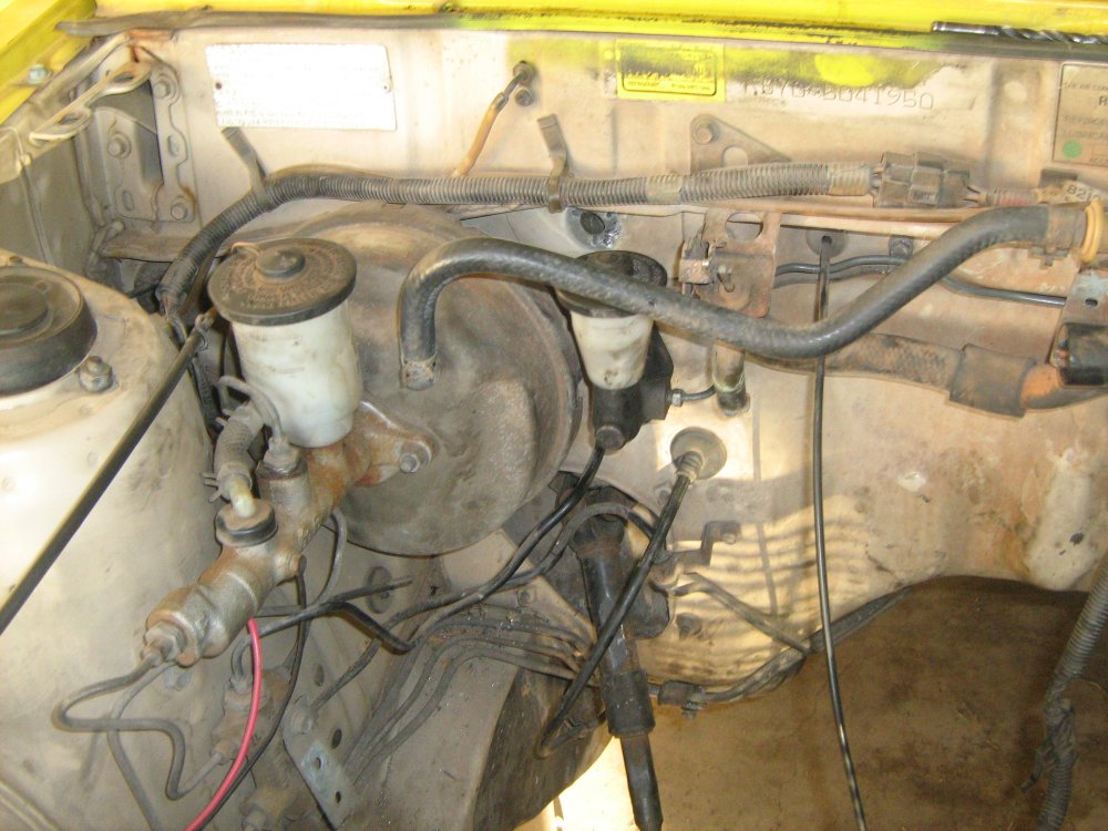

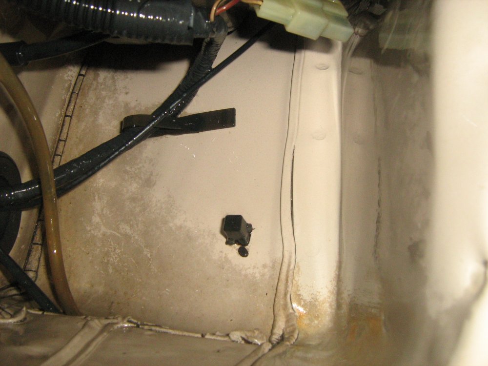

Trev Posted January 29, 2008 Author Report Share Posted January 29, 2008 Yeah you could of but i thought id stir you up for getting be outta bed so early. Today was more cleaning and if this 4AG leaks oil i will be pissed off, I removed the guards and cleaned under them, I now have most of the engine bay scrubbed just gotta do the battery holder section, While I'm at it I'm going to get another stonetray and bonnet support as they are very twisted, Oh and AE82 guards don't fit :hmm: Heres some pics... This is a before shot of the engine bay: Once i finish cleaning the rest i will get some really good degreaser and give it a good soak. Link to comment Share on other sites More sharing options...
Des Posted January 29, 2008 Report Share Posted January 29, 2008 it was 8:15am. Looks f**kin clean :hmm: Link to comment Share on other sites More sharing options...

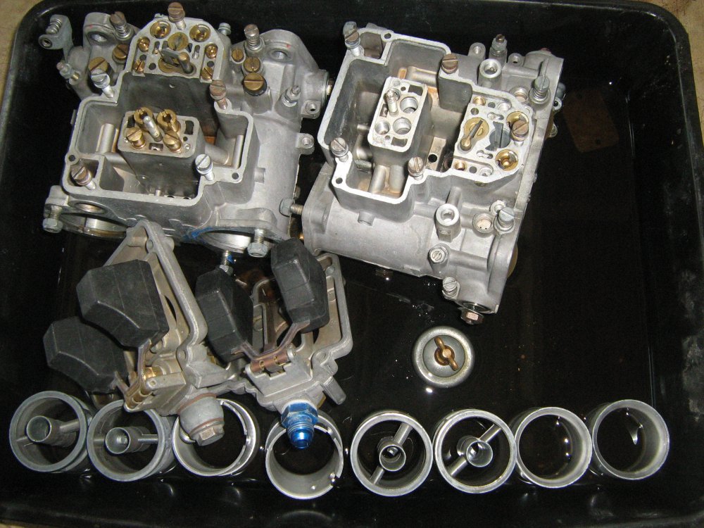

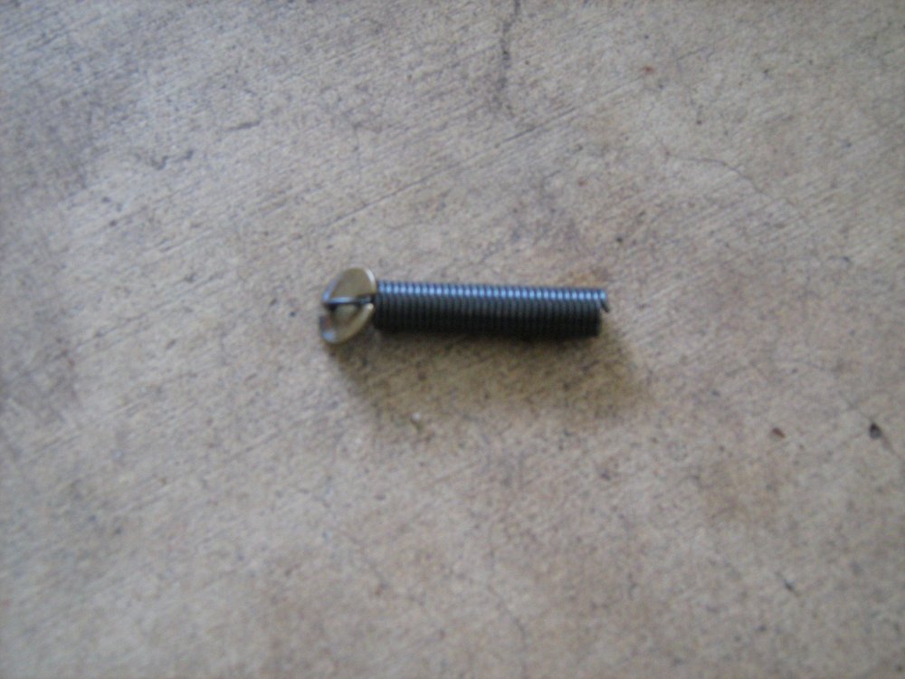

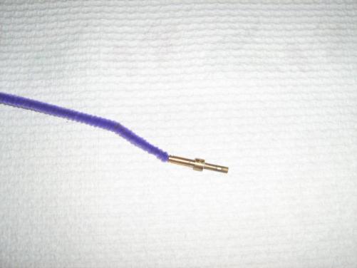

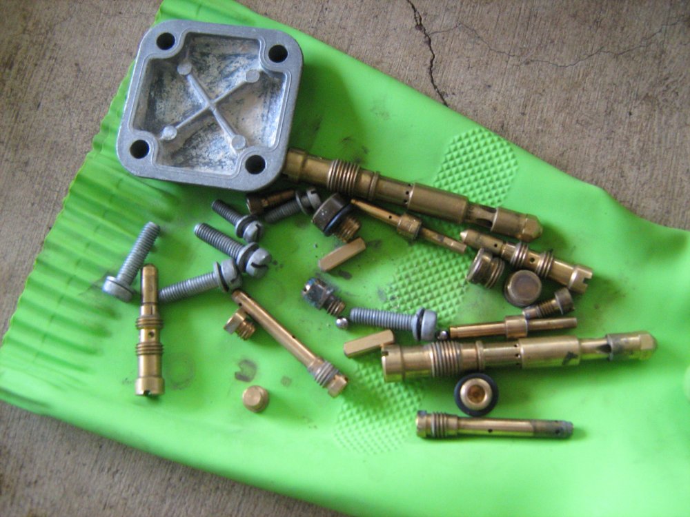

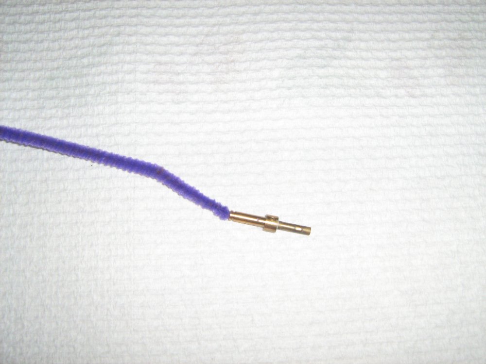

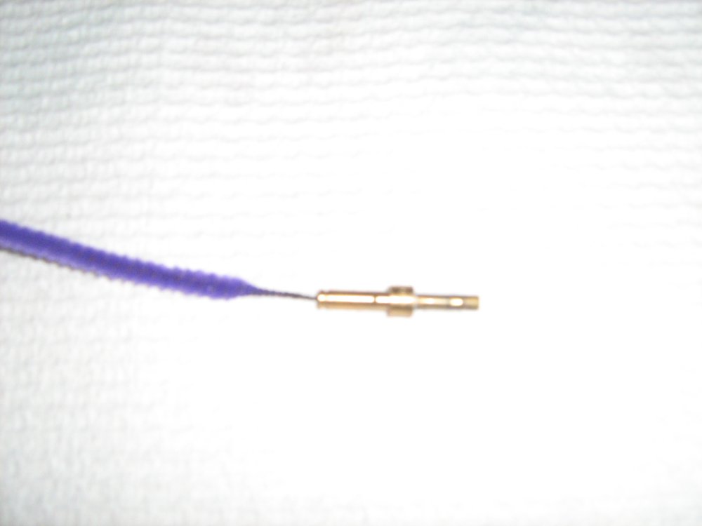

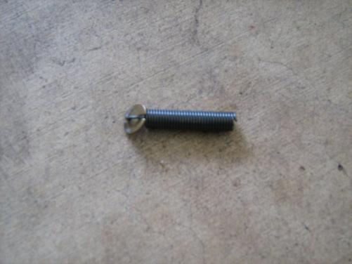

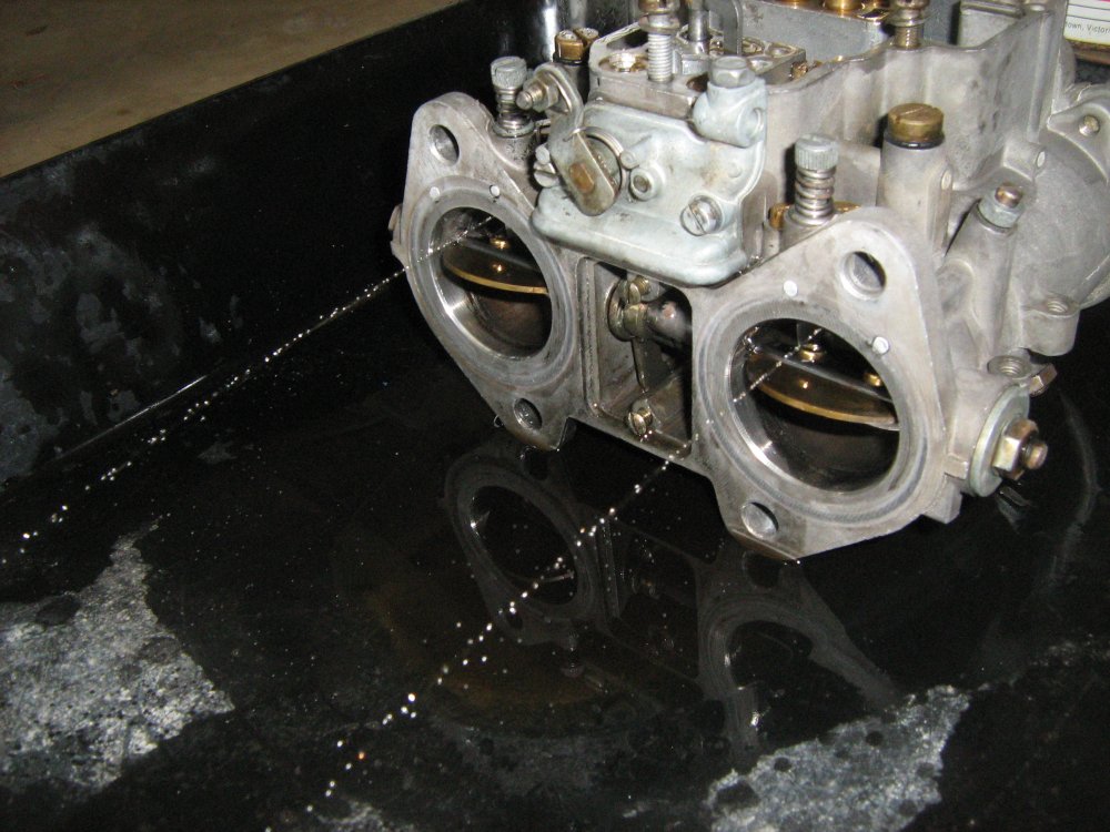

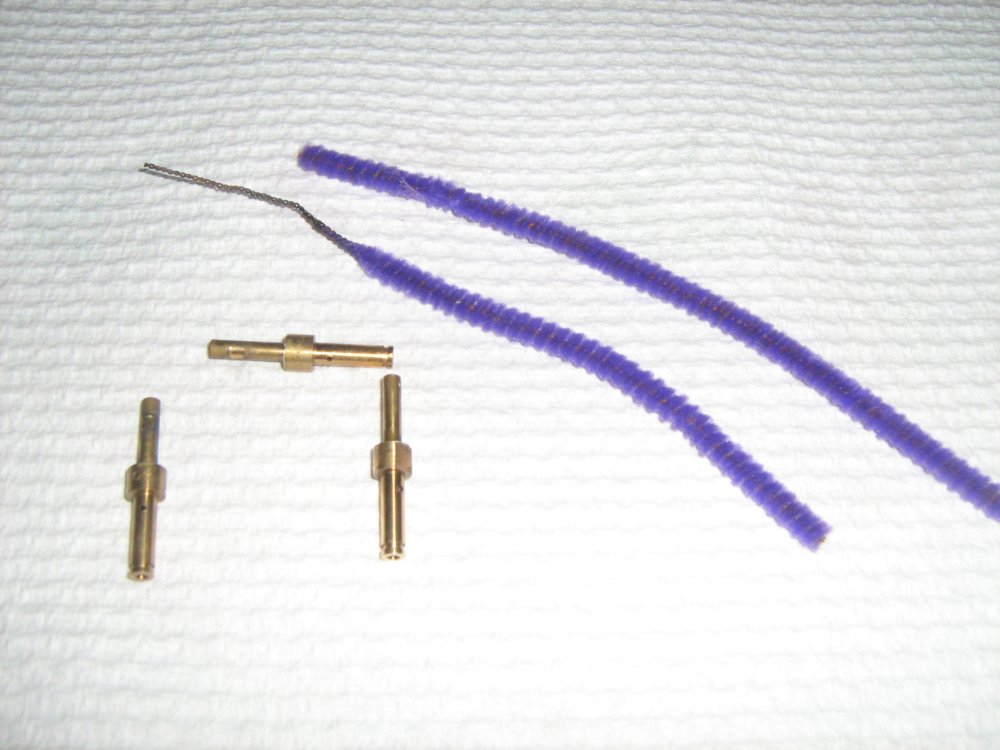

Trev Posted February 1, 2008 Author Report Share Posted February 1, 2008 (edited) Today was more cleaning as I'm very keen to get this thing going, Someone once told me that ovenclean is the best automotive degreaser, Well its good shit but there wasnt much in the can so i only did a little bit, Dunno wether or not to buy more ovenclean or to get an actual degreaser: Yesterday i started with cleaning the webers up with petrol as they had a bit of crap in them, So they got fully stripped and i also cleaned the jets out, I think that the weber is the easiest carby i have ever worked on: I also found out why one of the carbies wasnt returning from acceleration, It had a broken internal return spring, I know it prolly doesnt matter when they are joined together but I'm gonna fix it: This is how i cleaned the jets out, Pipe cleaners come in handy: I melted the end on the cleaner so i could get into the tight bits: Then in went the fluffy bit: They were followed with a blow out. This is the carb with the broken spring fully opened up and i released the plunger: Just gotta buy 2 gasket kits and they are good to go, i also got the numbers from the jets and the chokes: Jets = 40 Primary chokes = 45 Secondry chokes = 36 (I think i have them 2 names correct) Also this is why I'm trying to sell my manifold: http://cgi.ebay.com.au/ws/eBayISAPI.dll?Vi...N:IT&ih=005 Edited February 1, 2008 by Trev Link to comment Share on other sites More sharing options...

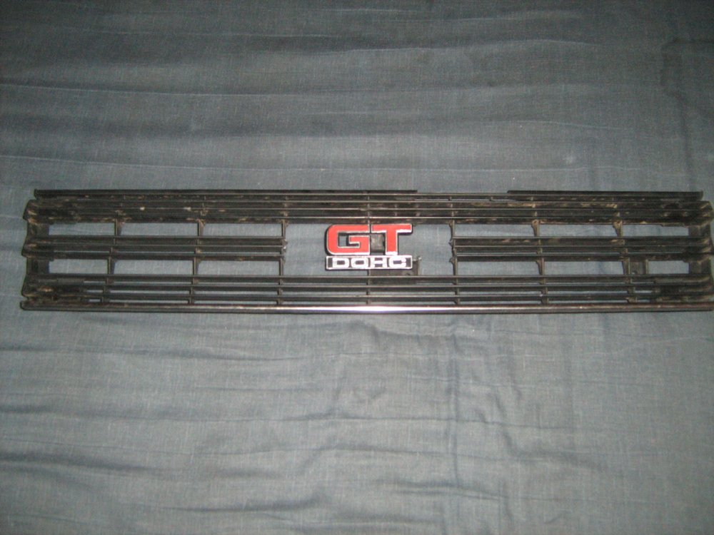

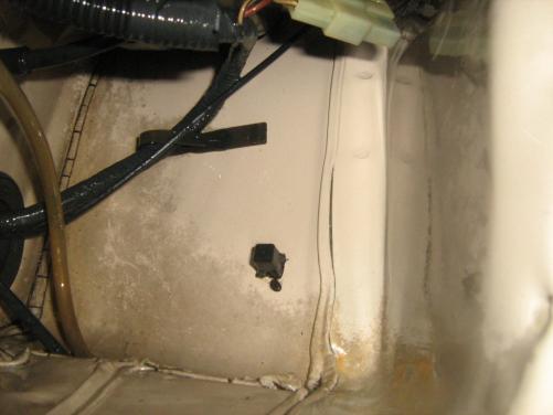

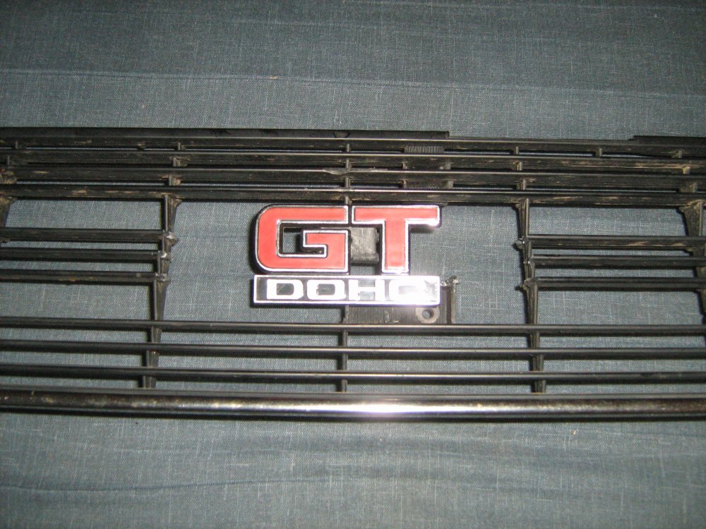

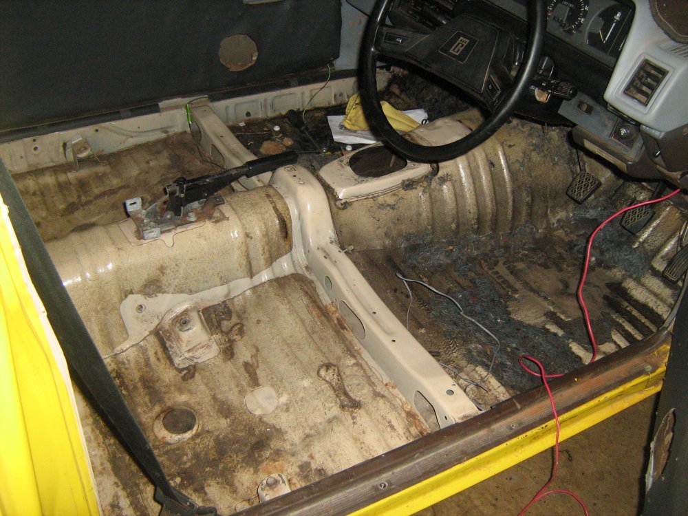

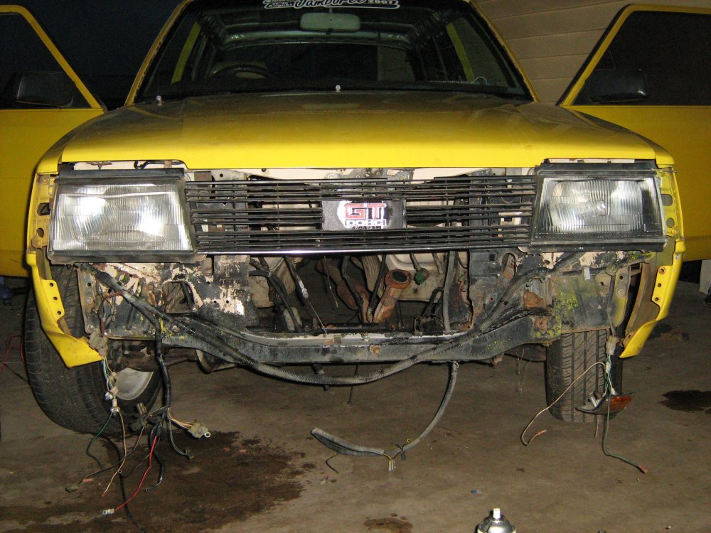

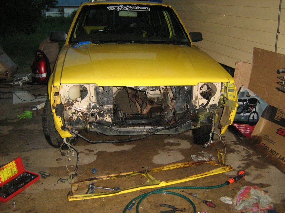

Trev Posted February 1, 2008 Author Report Share Posted February 1, 2008 (edited) Got some more ovenclean later today: Pulled the house carpet out as it didnt even cover the floor, Just gotta get the other carpet: Got another yellow stonetray lined up so i took the bent one off and aligned the front better: What do you guys think of this: I wanted to use the badge but didnt wanna stick it on the sedan, Its still got a bit of work tho. Yes i put last years jambo sticker on it today, I didnt want it to go to waste. Edited February 1, 2008 by Trev Link to comment Share on other sites More sharing options...

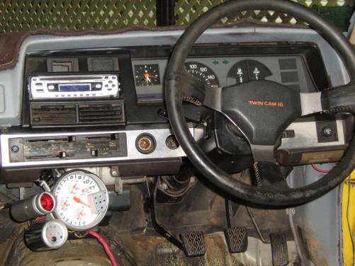

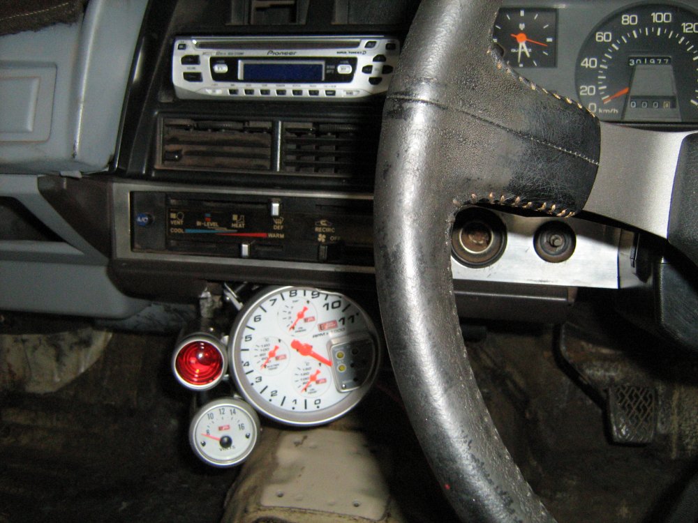

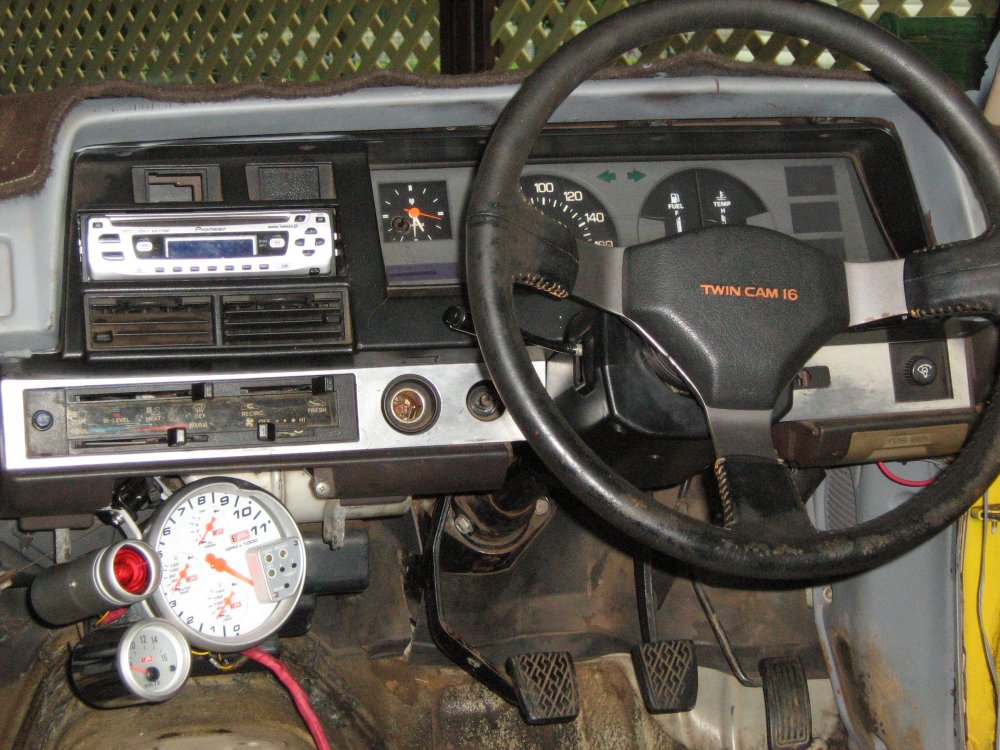

Trev Posted February 3, 2008 Author Report Share Posted February 3, 2008 Did a few more little things to it again today, Cleaned the floor of dirt and excess underlay and put the tacho and volts guage in that i had laying around along with my twincam wheel: You can actualy see the tacho quite well and the light is pointed at my face, Matt (LRS) has a sandwich plate for me, Gotta get the carpet off Teddy and i just gotta get the manifold i won on ebay the other day, I don't have extractors as yet but i can borrow some to fire it up. Link to comment Share on other sites More sharing options...

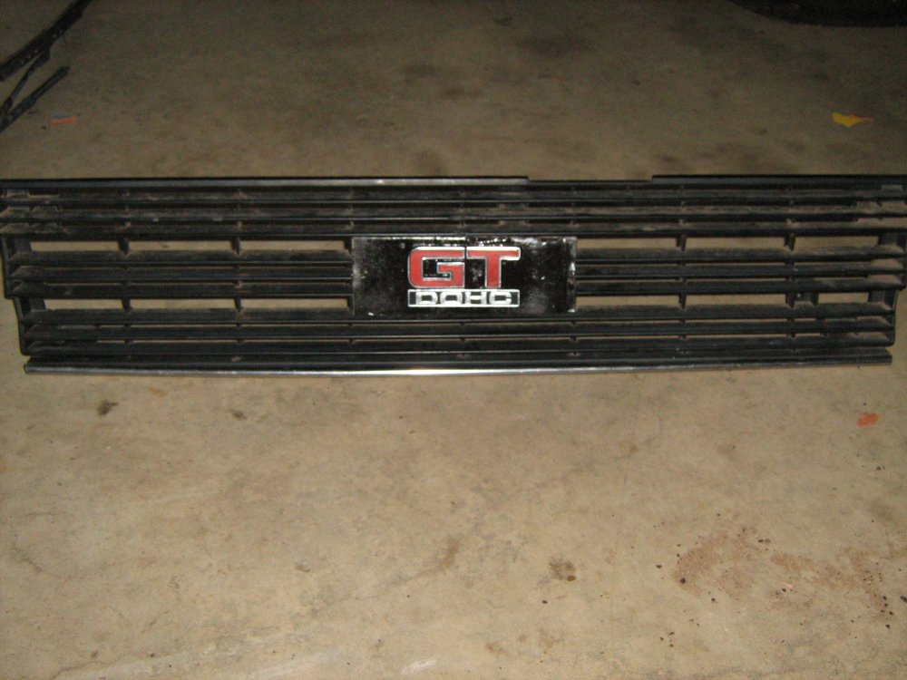

LittleRedSpirit Posted February 3, 2008 Report Share Posted February 3, 2008 Looks tidy trev. Ill drop off the sandwhich plate one arvo after work as I'm passing through. don't know where I could get a Twinky wheel like yours do you? Cops say my face grater has to go.... The badge looks cool, I'm really starting to like mine on the front too. Dunno about the removed bit though.... Link to comment Share on other sites More sharing options...

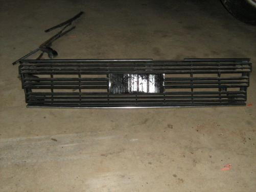

Trev Posted February 3, 2008 Author Report Share Posted February 3, 2008 Looks tidy trev. Ill drop off the sandwhich plate one arvo after work as I'm passing through. don't know where I could get a Twinky wheel like yours do you? Cops say my face grater has to go.... The badge looks cool, I'm really starting to like mine on the front too. Dunno about the removed bit though.... yeah no worries mate i will have the dosh here, Nah i took that one off my seca for the time being, I know slim has one that i asked for the other day but i dunno whats happening with it. Yeah i forgot you had yours and noticed it again when i posted in your thread, I woulda just ziptied it or something (just wasted a perfect grille), What i wanna do with mine is fill the space with some perspex so its flat and inserted and then mould it in so it don't look so weird Link to comment Share on other sites More sharing options...

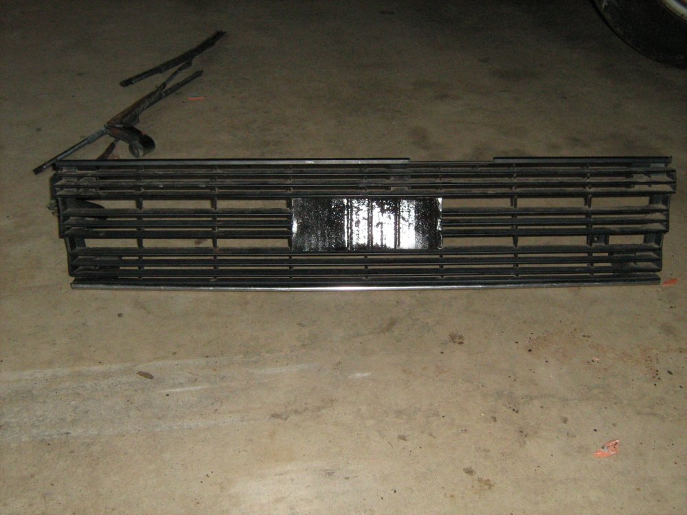

Trev Posted February 3, 2008 Author Report Share Posted February 3, 2008 (edited) I just did a quick carboard cutout job with the grille insert and painted it with blackboard paint, Once i get the grill done it will be all repainted. So if anyone here is in brisbane and does plastic welding you will come in handy :jamie: EDIT: I slapped a few front panels together to see what it was like, I reckon it will be the goods when its all done properly and the car is put bac together. Edited February 3, 2008 by Trev Link to comment Share on other sites More sharing options...
marvis Posted February 3, 2008 Report Share Posted February 3, 2008 Looking sweet! Link to comment Share on other sites More sharing options...
Medicine_Man Posted February 3, 2008 Report Share Posted February 3, 2008 Black out the radiator support panel from the front, Will make it look a million times better.. Link to comment Share on other sites More sharing options...
Trev Posted February 3, 2008 Author Report Share Posted February 3, 2008 Black out the radiator support panel from the front, Will make it look a million times better.. Yeah all of the inner guards, Front of the radiator support and inside the car is going black. Link to comment Share on other sites More sharing options...
