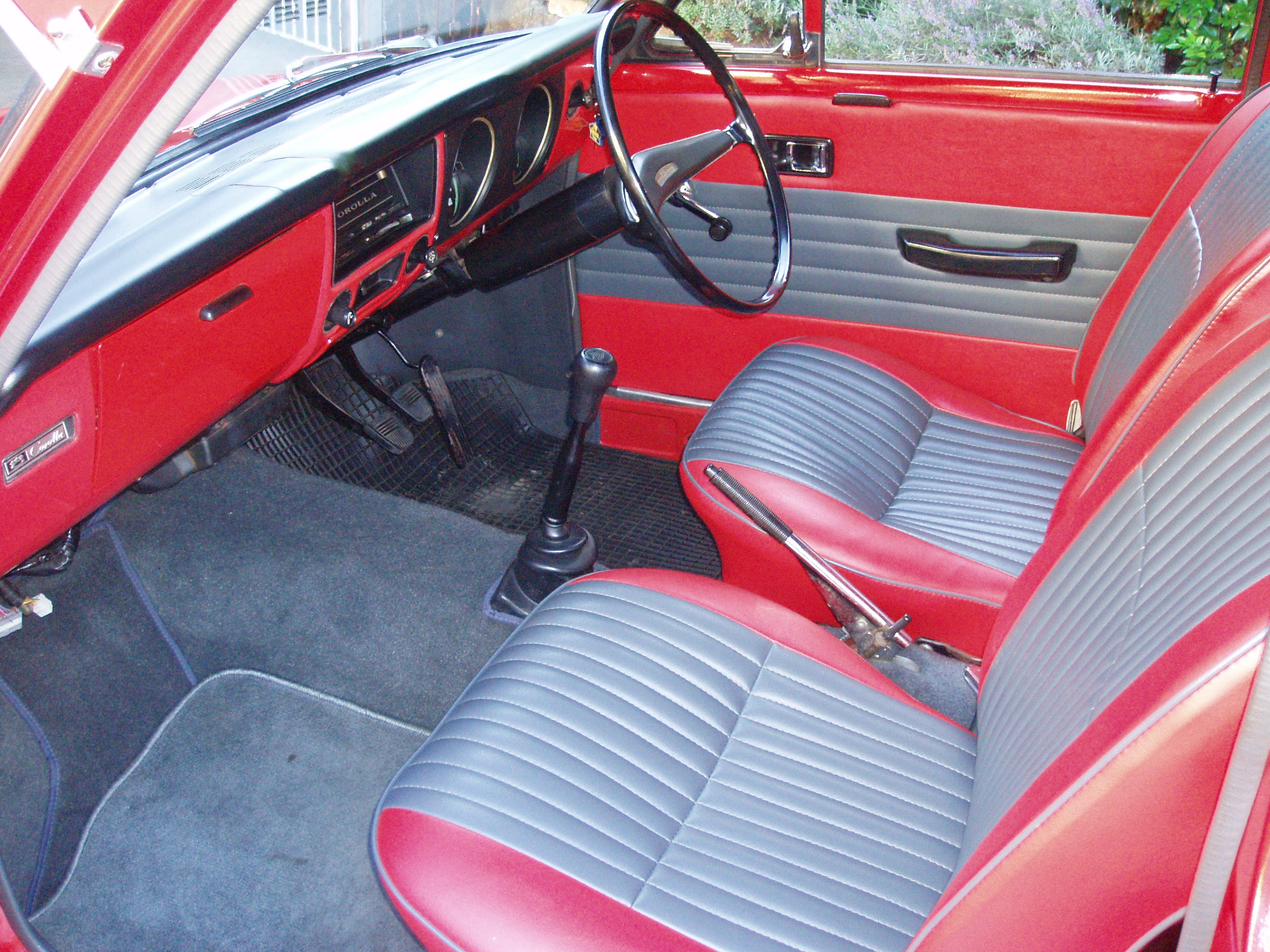

Absolutely rapped with the interior!!
Thank you K&B Motor Trimmers!
