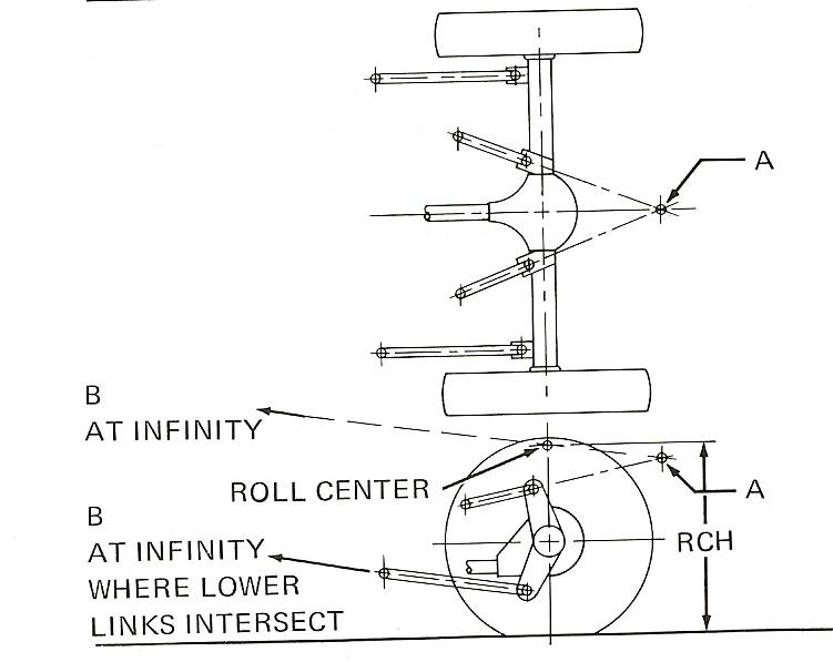

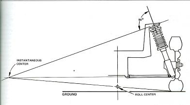

Rollcenters, as a car goes through a corner, it will lean, the inside of the car will extend and the outside will compress its supension. If you could picture an imaginary point about which the car rotates, this is the roll center. Rollcenters can be changed depending on suspension types but the best way to measure change is on a track. Making a sprinter have adjustable rollcenters is not overly difficult, we all know about front roll center adjusters and having several different thicknesses of rca will alow you to try different settings. The pic below shows how to work out front roll centers, this must be done on both sides to find the actual rollcenter where the lower lines intersect. As pictured, changing the angle of the strut or the track will effect the roll center but changing the angle at which the LCA sits will cause the most change. Now generally speaking, raising the roll center will cause more roll, lowering it will cause less. However, having no roll means that the cannot roll onto its tyres and will understeer, having it to high will cause the car to roll over to much and also cause understeer. A sweet spot must be found through testing of the car. There is no right or wrong here as different ride hieghts and driving styles will mean different sized RCA's.

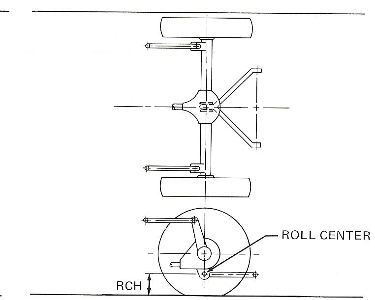

For the rear it gets more complicated as the angle of the 4 link bars from front to rear has a bearing on the roll center as shown in the 1st pic below and much like the front, rear roll centers are dependant on driving style, horsepower levels, and ride height. the easiest way to make the rear system work properly is to make the 4 link bars equal length, parrallel with each other and the ground. This dials out all roll steer and as shown in the 2nd pic below, makes them no longer a factor in roll centers. Once this is done then a panard bar arrangment that can be moved up and down at both ends, or an adjustable watts linkage setup, can be used to adjust rear roll centers. The only other thing to remember when running a panard bar is that if the bar is not parallel with the ground (as in both end mounts are an even distance from the ground) the roll center will move left to right with suspension movement, it will also change to a different location between left and right corners, and cause left/right diff movement through suspension travel. Again there is no right or wrong here, a high hp car may run a higher roll center in the rear to force the cars weight onto the drive wheel in a corner and provide better drive where as a drifter might run a really low rear roll center so that the rears don't load up and cause eccesive grip or tyre wear.

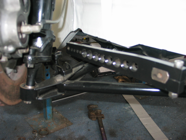

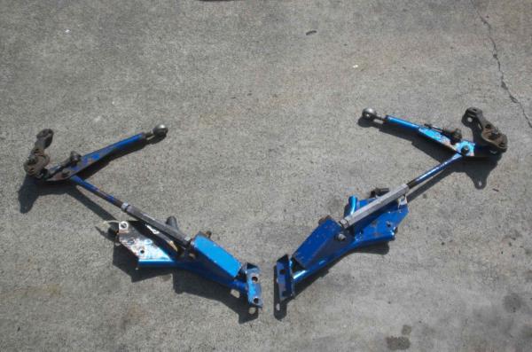

Another thing i'd like to throw out there.
I'm currently trying to figure out a way to at least reduce the scrub radius problems that a KE70 has, i have my own ideas but if anybody has any thoughts i'd really like to know. Basically the way I'm doing mine at the moment, the ball joint will be replaced with a spherical bearing as will the inner LCA bush. The castor rod will be rosejointed and there will be a pivot point where the castor rod currently bolts to the LCA. Similar to the below pics.
The only way i can see to improve the scrub radius problem is to move the balljoint closer to the wheel.
Please, discuss.
