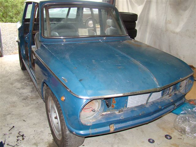

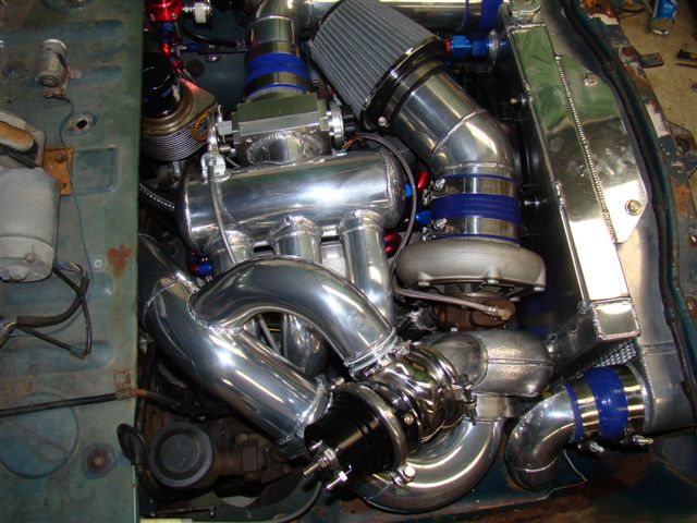

curly Posted June 2, 2010 Report Share Posted June 2, 2010 my job on this is to make it handle and stop, is it possible Quote Link to comment Share on other sites More sharing options...

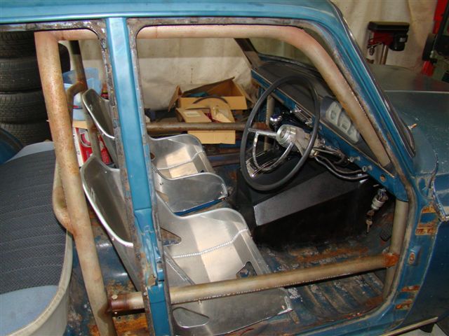

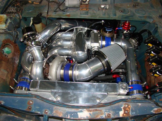

curly Posted June 2, 2010 Author Report Share Posted June 2, 2010 couple of extra pics Quote Link to comment Share on other sites More sharing options...
Karllos Posted June 2, 2010 Report Share Posted June 2, 2010 thats one.......interesting setup........... a lil over board, as long as it works well tho who cares Quote Link to comment Share on other sites More sharing options...

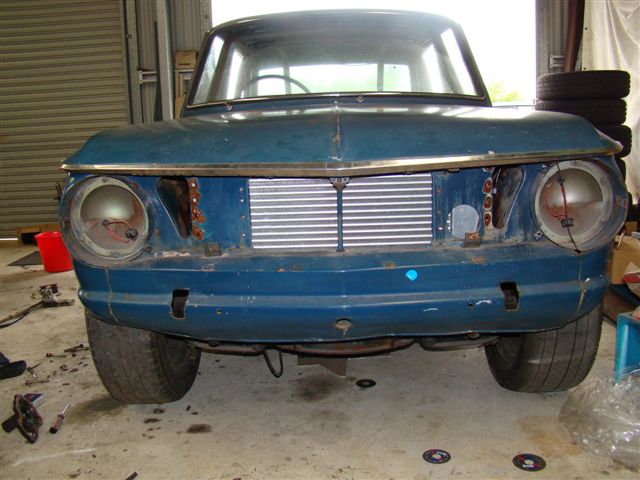

white_sandshoe Posted June 2, 2010 Report Share Posted June 2, 2010 YEBEJESIS! Â I want one!!! Â Handling=full nolothane bushings, try RX7 struts etc, and I'd even go so far as to corner weigh her and get the required spring rates spot on. Sway bar the hell out of her. Â Stopping=RX7 brakes on the front, whatever will work on the rear, depending on diff upgrade? I'd suggest a B series mazda diff or an F series toyota... Hilux diff in this case will give for too much unsprung mass to handle well... Â Â Please tell me that this is being granny specced on the outside??? Pentultimate Sleeper! Quote Link to comment Share on other sites More sharing options...

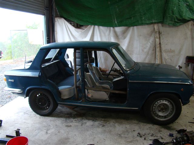

Redwarf Posted June 2, 2010 Report Share Posted June 2, 2010 Shoe horns are available in aisle 5. :D Â Is it going around corners, or just in a straight line? Quote Link to comment Share on other sites More sharing options...
Taz_Rx Posted June 2, 2010 Report Share Posted June 2, 2010 haha Yes I do like!!! Very cool. :D Â My guess would be straight lines Red. It would have a manual if it was a track car. Quote Link to comment Share on other sites More sharing options...
curly Posted June 2, 2010 Author Report Share Posted June 2, 2010 All wrong Street car Quote Link to comment Share on other sites More sharing options...
white_sandshoe Posted June 2, 2010 Report Share Posted June 2, 2010 All wrong Street car   to quote my mate when he saw the pics... "someone likes hospital food..." Quote Link to comment Share on other sites More sharing options...
clubby2084 Posted June 2, 2010 Report Share Posted June 2, 2010 All wrong Street car  Jeeezus !, which side of the street/footpath/kerb do you intend on driving this monster, or are you willing to let the car make up it's own mind. Keep us updated with this little beauty (I'm sure the local news station will keep us all informed once it's on the road :D )  Dead set love it... Quote Link to comment Share on other sites More sharing options...
Des Posted June 3, 2010 Report Share Posted June 3, 2010 That pipe work is awesome. Quote Link to comment Share on other sites More sharing options...

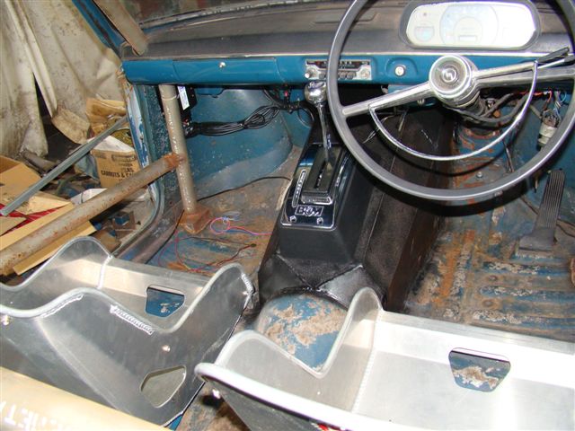

curly Posted June 17, 2010 Author Report Share Posted June 17, 2010 one word INSANE!please do tell us what else is the plan for the car? OK the car so far, 1964 mazda 800 sed, unbelievably bood body and chrome, the mechanicals, series 6 bridge port, to4z, jatco trans with stally and trans brake, b&m shifter, g series hilux with full spool( f series would never hold this) my jobs are custom alloy front hubs, BA discs undecided with calipers, our rear disc conversion, upgrade the shocks and springs but everythings custom as there are no listings for them, undecided on the rear as the power will turm these springs upside down, probably some sort of tramp bar setup? The body is staying original except for 15in wheels, late corolla on the front and EL rears widened out to 8in, and sitting slightly lower than std. CUTE hey Quote Link to comment Share on other sites More sharing options...
