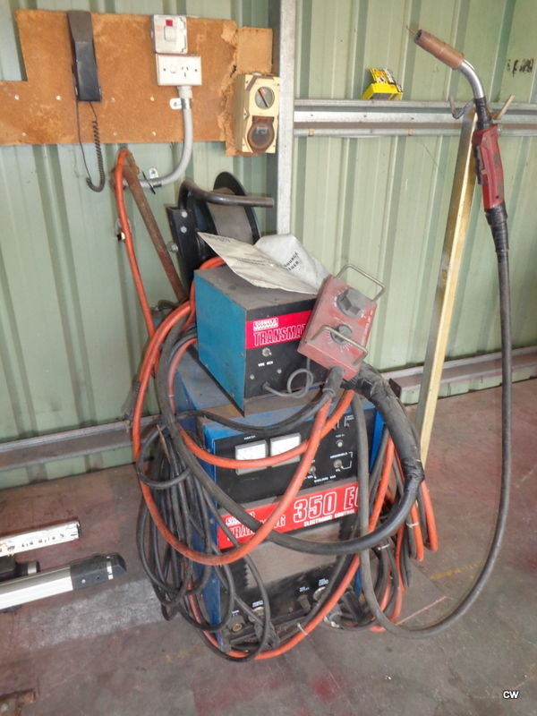

OK, I was looking around for which welder to buy.
I have purchased a cigweld transmig 350ec. It comes with remote control and wire feeder, torches and reg for $500. Being a small to medium 3 phase welder it wasnt as desireable as a 200 ish amp single phase as backyarders with no 3 phase power arent keen to buy it. Hence the sweet deal. Its about a 3 grand welder I think, but it was listed and relisted and came down to a very affordable price. I hope it doenst need much in the way of maintenance.
Now I can get on with all the small things I need to do like welding up some cracks in the body, repairing damaged threads, finishing off the diff mount bushes, rust repairs, you name it. Its on.
Today i didnt do much, but I did remove and paint the exhaust and die grind any burrs away from the unions. I love how Rick made it in two sections, its super easy to remove even with the diff in the car.
I also collected a welder. I bought a cigweld 350EC Transmig. It does stick, mig and tig. Can weld stainless, steel and aluminium if need be, its just a matter of the right wire, wheels in the feeder and the right gas and voltage. I need to buy a mask, and some argon and argoshield.
I need to fit a 3 phase plug and test it out. I might even buy a rusty ke70 to practice doing rust repairs on. Then move on to the ae86 afterwards.
I also had my bigger compressor wired up. Its a sweet unit. Its good day for machinery. :clover: I still want a hoist. Then I think Ill be right for a while. I'm definitely in the market for a 2 poster to install at my shed. I have ample power, may as well.
Nice buy with the welder, a few things I learnt along the same path might be of some use...
The little bottles are good for a one off job but its worth getting the big bottle if you are going to learn as the
gas goes pretty quick... best to use with no wind conditions so you can turn it down as much as possible.
BOC can supply these in an E size which is pretty big for something like $100 a fill but you have to rent the bottle
as well for around $100 a year or so. Don't go gasless, the wire is 4x the price and its not great to use...
Grab a good automatic mask, they are really worth it and a pair of mig pliers. Other handy bits are a 4 inch grinder
with cut/flap/grind/wire discs and long welding gloves/shirt/pants/boots/sunscreen etc A few clamps and magnetic squares
can also prove useful when tacking the piece if needed. Tig for sheet metal, mig for thicker steel/aluminum and arc
using stainless rods is one way of doing things that works well. Best advice is to practice on scrap long before you weld
the actual piece and get those settings and technique down first... Distortion is a bitch... tacking, preheating and stitch
welding can reduce this for less hammer and grinding afterwards. Most thicker stuff can be welded by cutting a V into
the joint to increase heat penetration. Make sure you get a good ground clamp on the piece as well to avoid problems,
clean the weld area with the grinder so its clean and anti spatter spray is good stuff for easy spatter cleanup.
You have to practice the motion of the weld path first before you pull the trigger, it can take a while to suss it through...
Good luck, welds go from birdshit, shit, pretty shit, looks like a weld, I think its welded, average, half decent and proper :P
All good advice. I have seen some bit larger disposable bottles at the bulk tool shops in Bris, only good for small stuff probably though. A tig can weld alloy and steel with pure argon. Mig can only do alloy with pure argon, needs a different gas for steel. Feel free to pm for any help at all, there are plenty of things I wish I knew sooner, happy to pass on what I can.

Hey thanks guys. i intend to do all kinds of welding eventually. Id like to be able to make exhausts and headers, weld panel steel, fabricate averagesteel stuff like frames and benches for work, and to also learn how to weld aluminium eventually. It would be awesome to not have to rent a bottle but I'm fairly sure they changed the law in qld about it and now they cannot fill bottles they don't own or some other such business lobbied bs that forces up the cost of everything.
I thought it would come with the reg but it didnt. It did come with a couple of bags of tips. I need to buy a few things.
Regulator and gas.
Earth clamp, as the welder has a bar bolted to the earth lead as old mate just used it to build a trailer and had his earth bar welded in.
A rusty car to practice on.
Welding helmet
I'm not totally new to this but Ive done more stick than mig welding.
Ive also got to find some air hoses and lines to run as Ive just had a compressor installed too.
