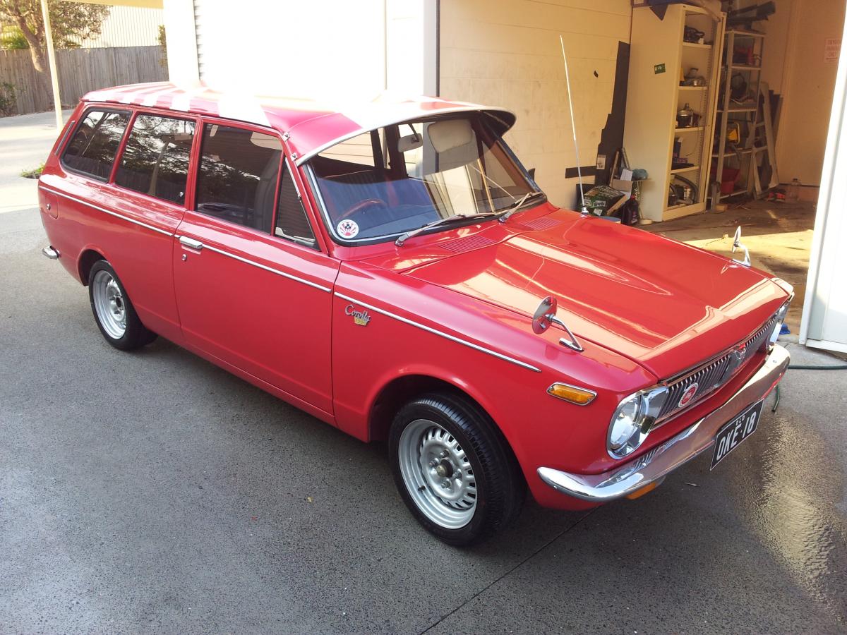

Got home, getting it ready for the Kawana car show.
Washing it, chilling. BANG.Alarm starts going nuts.
Fffffuuuuuuuuuu......
Run inside to grab the keys, ass over on the tiles because foamy water feet. Limp back out to disarm it.
WTF, wont disarm.
OK, pop the hood and turn it off with the key.
THE FCUKING TOOTH ON THE KEY IS SNAPPED OFF!
RAGE!
Managed to turn the lock with a jewellers screwdriver lent to me by my neighbour.
Dunno WTF is going on with that.

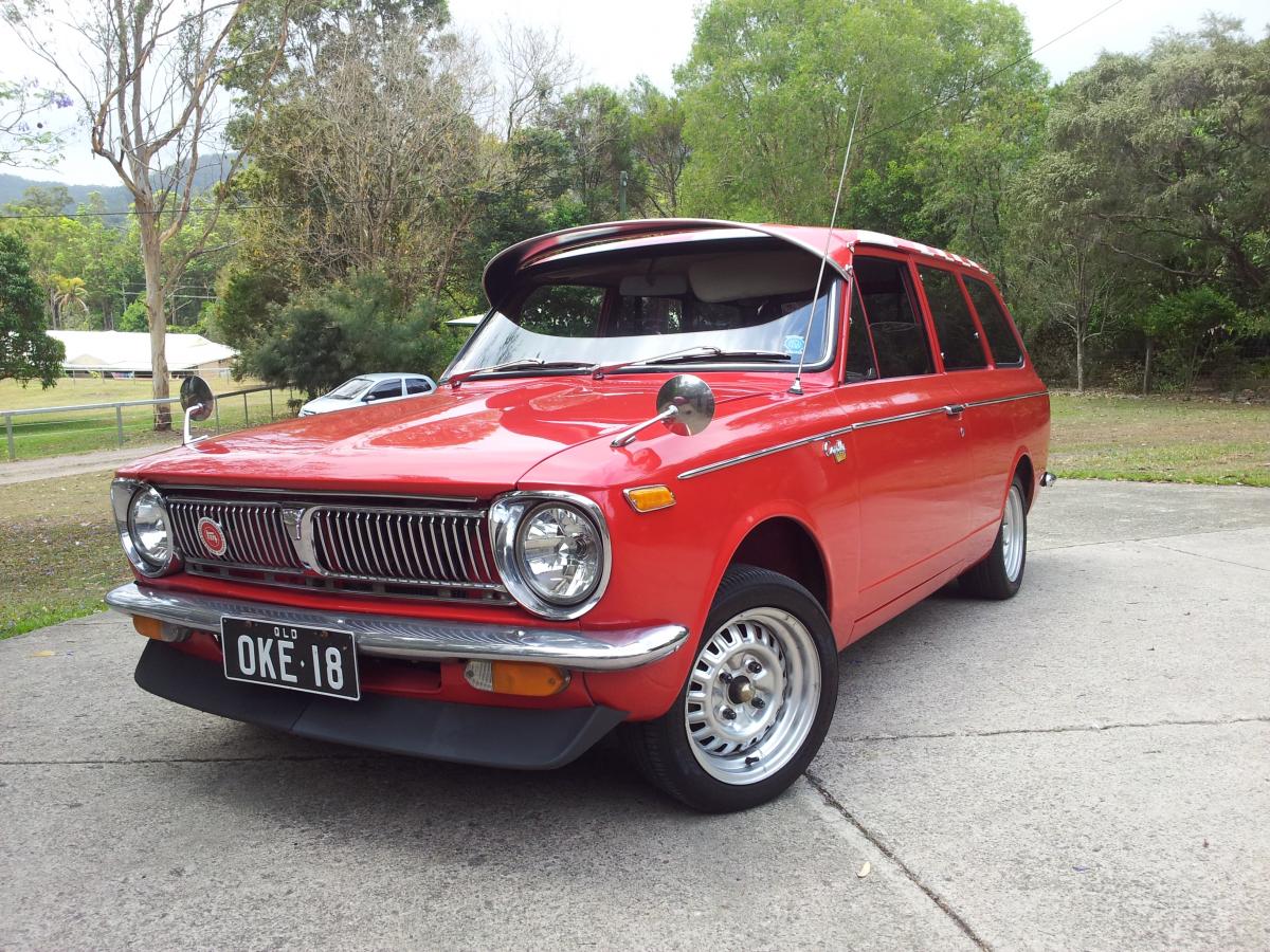

Anyway ended up looking sweet for the meet. Got a heap of love.
so are you bringing the 18 camping tomorrow
Hey man, ever thought about putting some whitewalls on her? I thought about it at work today (is it weird that I thought about your car?), thought it'd look sweet!
I reckon this would look absolutely bawwwws times infinity if you took the visor and roof sticker off
And then sticker bomb your entire windscreen with illest stickers.
Edited by rian
Front lip = Win
