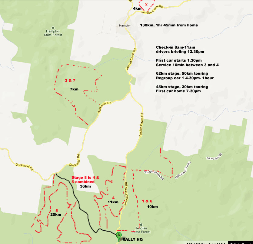

Friday they should be down here in Otrange, and Saturday we are off to the Jenolan Forest for an afternoon/night rally.
If you want to watch, it is just South of Hampton, near Lithgow.

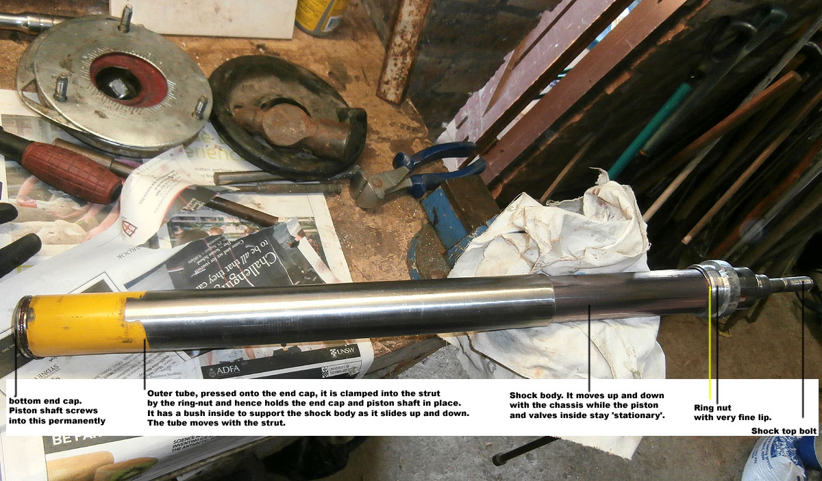

Ah well... Steve ran into a little problem putting a Bilstein back in the strut when the ring-nut didn't engage the outer tube to hold it straight, and when he did it up it crushed the outer tube and stripped the thread. After an hour or two of panicked prying the outer tube straight he assembled it all, only to have the nut pop off when they loaded the truck!
That's how it arrived in Orange on Friday afternoon, with plans to screw it back in and tack-weld it in place, Woolshed Style!

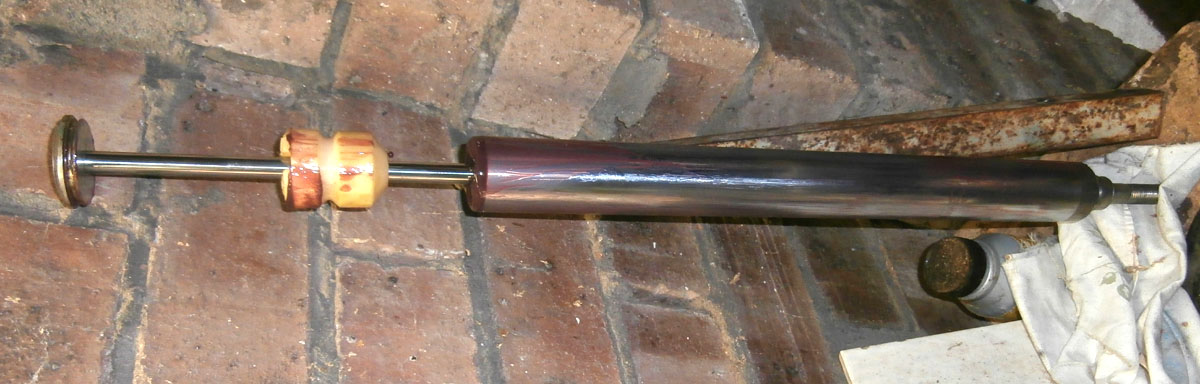

Anyway, we stripped it out and cleaned it. The Bilstein is upside-down compared to most shocks, a very clever idea as it puts the weak thin piston shaft down inside the strut where it doesn't move, and the large strong outer shock body sticks out inside the coil spring and goes up and down.
We cleaned up the end of the tube so it fitted the ring-nut nicely then put it back together, but it stripped as we tightened it. The very fine threads on the ring-nut were worn and the end of the strut expanded a fraction of a mm.
We tapped the outer tube off the bottom end cap, and then it looks like a shock, complete with bump stop.

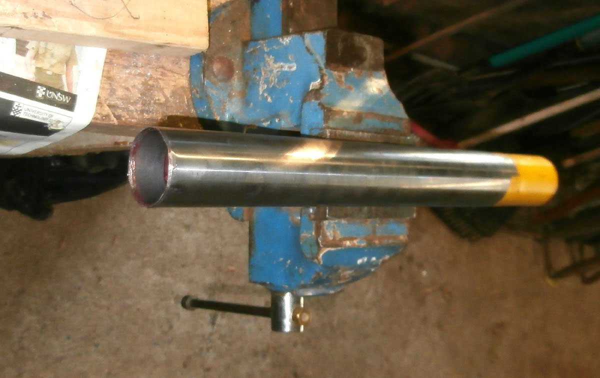

I cleaned the threads up on the strut & the nut, screwed it all the way in and found it went in 3mm more without the tube on before it reached the end of the thread.
Obvious solution, I took to the tube with a hacksaw, much to Steve's horror!
I cut 1.6mm off with a hacksaw, checked it & found we still had a bit more to go, and took another slice off.
Then he held the strut down on the vice while I hammeed all around the top with a ball-peen hammer!
When we put it back together it seated right down and did up tight, the extra clean threads working fine.

Thanks for the pics of internals ,they look good gear compaired to shit ive got.
rob
nah- we don't need to, but we would if it was needed! The ring-nut sits right down snugly in the strut, whereas it was 6mm proud before, and it holds the shock in tight. On the list is "buy new ring-nut" and "prepare new struts as spares" and even "heat-shrink reinforcing collar onto outside of strut top"! but these lists never seem to get finished with a rally car!
