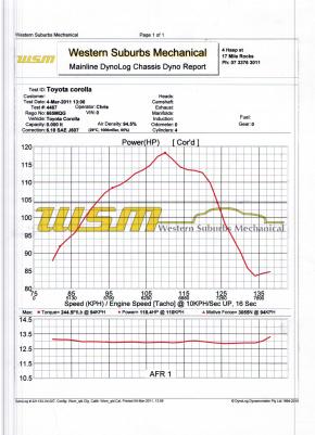

Made a graph as best I could with the 2 dyno sheets. I know different dynos different day etc but was as similar as it can be under the circumstances. It seems to show what I was looking for. It drops away after making a stronger peak. I'm faced with the choice of opening up the inlet some more and trying to get it more air for the last 1500rpm of the band, or shortening the rev limit by 700 rpm or so to avoid running where there is no point anyhow. Its clear the bigger throttles before breathed better at the top of the rpm band, but this setup does a lot more work before it even gets there. Decisions, Decisions. Now I need to revise part throttle maps. Wish it would stop raining, the arse dyno fails in the rain. :cool:
Ok, just got back from some dyno time. We did a power run, found it was a bit lean right through, just about half a point average. It appears my interpretation of a happy sounding motor is one pushed close to the edge. Added a lot of fuel aspecially from 4000-6500rpm, as it wanted a lot more and just kept making more torque in that range. Its an interesting chart, and it confirms that my modifications to gain torque have worked. Compared to my old dyno chart I am making a lot more power earlier. It also made 88KW on their scale, it made 85kw before. So it has made more power earlier, infact, with the combination of a 2 inch exhaust pipe, 4-2-1 extractors, and 30mm long 42mm diameter trumpets on silvertop throttles, it makes its peak power at 6550rpm, a full 600rpm sooner than it used to. So to summarise it makes more power earlier. This means the area under the curve is quite large compared to the old system. I will plot the 2 graphs onto a shared scale for comparisons sake to exemplify the point more clearly. Its making 100hp at 5450 rpm. Thats sure putting ts power down differently than before. See chart below. Videos to come when I tube em.
