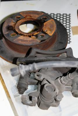

Cheers Jake, but wont need to trouble you as they are pretty close to perfect on both diffs. The only thing that's a bit shit about this diff is I detected that one calliper slide has play which gives a little noise right as the car stops, Ill just swap over the calliper I think.

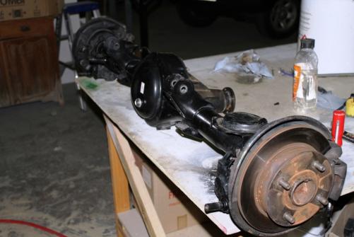

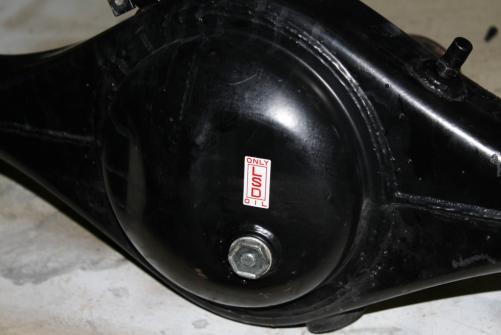

OK. Progress! Today I collected the diff housing, freshly cleaned of course, and the freshly assembled centre with the 4.5s from diff lapping. I get their full warranty since I had them clean the housing as well. They removed the baffles and everything and did a wonderful job of cleaning it. No more sand I tells ya! The post mortem on the whiny gear set in the second diff revealed symptoms of low oil in the diff for a long period. The teeth were exchanging metal back and forth from crown wheel to pinion and vice versa. They evidently had gotten very hot and were black at the edges. Thankfully the 4.5s lapped up and assembled perfectly, the lsd was fine and the bearings I supplied were all correct. A bit of a rundown of expenses to freshen up a t series, provided your lsd is in useable condition: Rear wheel bearings, Koyo - $95 a side with retainers and seals included. Bearings for the centre, unsure of brand but were japanese made - $200, there is 4 of them, 2 pairs. Diff lapping to refresh worn gears - $105 Sealant - $13 If you need a crown wheel and pinion a new one is $500-$600, different ratios are different prices usually.

Today's instalment of the diff saga... I decided to get diff lapping to build it. I asked around, and they are widely regarded as the better diff people in Brisbane. They quoted an average build labour fee of $385. I was a bit shocked by this. I decided f@$k it, its a long term expense so may as well do it once and do it right. I dropped them the complete whiney as f@$k centre, new bearings for it, a better condition tailshaft/pinion flange, pinion seal, crush washer and they already had he diff gears after lapping them. They rang me back tonight at 5pm to say the centre was all ready to go. Pretty damn fast turnaround. Only 2 hours labour to pay for aswell so only $200 plus the lapping and the housing cleaning fee. Wonderful. I will collect it tomorrow and re-assemble on saturday. I just have to go get the bearings pressed on and off the axles. I noticed that both diffs have the same splines on the axles. So both the same series. Vernier Calipers will confirm whether its a zenki or kouki style once and for all tomorrow.

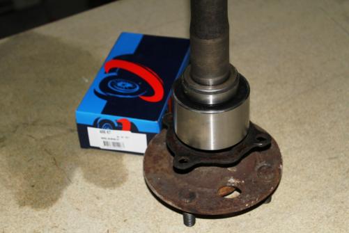

I bought the axle bearings for both diffs today. $400 later. Ouch. Got a call from diff lapping, the 4.5s are ready. $105 for that. $40 to clean the housing for me in their bath. Then I guess hopefully tomorrow I can swing by diff lapping and collect the gears and the housing. Then I will drop off the gears, pinion seal, centre bearings and the centre with the broken gears to the mechanic to build the diff centre again. Ill drop off the new bearings and axles and retainers with the mechanic I usually use and he can press them off and on for me. Then I'm back in business with a overrated 4.5:1 TRD 2way limited slip rear end.

Diff saga continues. Pulled the centre and axles out of the second diff today. Took about 15 minutes all up. Getting good at it. Axles overrated, brakes overrated, wheel bearings rooted completely on one side, gonna change both and be done with it, lsd is overrated and appears to be another trd 2 way. Took the whiney gears to diff lapping, they are absolutely worn out beyond lapping or anything. Oh well, I have a bit of time to get the gears I need for diff number 2, as the 4.5s should be ready tomorrow, then they go off to be coated and then built into the centre with the lsd. Then I can chuck it all back together and drive, hopefully it will be the quietest diff I've ever owned. It appears I got all the leaves out yesterday, as only about 3 or 4 tiny fragments came out of the diff, and I cleaned the housing out pretty well while it was in the car. I might even splash out and get a one piece tail-shaft made so I can start tuning the pinion angle properly. Id also like a lighter unit to spin, and a smaller diameter one to clear the exhaust resonator, which rubs the tailshaft rear half as the car rises. Just FYI, an OEM japan made KOYO wheel bearing kit is $92 plus gst per Side! I'm getting 4 sides to do 2 diffs, ouch. On the plus side it includes seals and retainers for the seals to run on. That is great because mine are rooted from the sand in the first diff, and always leaked. I'm yet to measure the axles but I think they are both kouki judging by the bearings. I need to find my vernier calipers to confirm the axle thicknesses to be sure. My original housing is in the diff bath at diff lapping tonight, and will be flushed in the morning, so hopefully it comes up overrated with absolutely no contaminants.

What an interesting afternoon. I've discovered there were a few small issues with the diff which led to it becoming noisy. The wheel bearings were seizing and one was rough as guts like the balls were smashed. The rhs axle had 4 mm of end float, I honestly cannot explain why, its a mystery. It looked fine when it came out. All the bearings in the centre seemed fine, however the pinion was MISSING 2 TEETH! lol. I pulled the carrier out of the housing, looked in and saw the teeth sitting in the bottom, no other metal fragments, just two whole teeth in there that came out of the pinion! Its weird because it never lost drive, had a major bang or significant event that killed it, maybe it was all the reverse roll starts I did recently when the battery was shitting me. So once that was pulled apart, I pulled the whole other disc to disc rear end out of my AE86 and fitted that to my AE71. I decided to use the brakes that were already on it instead of swapping them over the the ones I had been running on the first diff. They were new rotors and new pads, and not a leak from the calipers, they seem to work better than my other brakes. So with that rear end fitted it was time for a test drive, the diff is definately an lsd, locks so tight it feels like a new one. The ratio is 4.3 which is a fantastic bonus, when one door closes (or snaps off 2 teeth, lol) another door opens I guess. The weird thing was when I changed the oil in the new diff two leaves came out. WTF, f@$king Boonah bush mechanic spec. The thing whines loud as f@$k between about 45 and 90 klm/hr, but is quiet before and after those speeds, I think ill just go see my diff guy and get him to pull out the centre and adjust the crown wheel and pinion so its a bit quieter, I'm going to get him to fit a new pinion seal as well so may as well sort it properly, then I can check for more shrubbery in the housing at the same time! It doesn't have much slop, less than the first diff, feels like a tight rear end except for the whine. So that took all arvo, I might have to go in tomorrow to change to the shiny new trumpets and fit the new single row crank pulley. Cheers to Timbo for dropping by and helping me bleed brakes. Your car looks overrated mate.
Dropped the 4.5s at diff lapping today. Should be done in a few days. He didn't think they were very damaged at all. Will swap the diff tomorrow. Yet another diff swap! Might go back to a stock rear swaybar and stock rubber bushings and put in the new handbrake cables while I am under there aswell. I'm a bit over sliding now with a bit more grunt in the mid revs. I pray the diff I put in holds its oil as its sat for a long time, might have to put in 2 new axle seals as well. I'm gonna pull an axle out to see if its a zenki or kouki rear end anyhow, because I want to know which it is. I might fit my rebuilt brakes to it aswell since the other diff has to come apart to begin with. Will be a big arvos work.

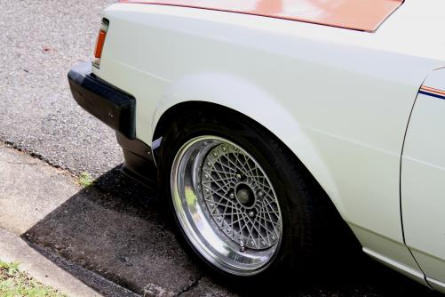

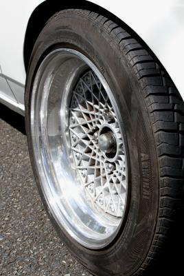

Ill chat to you about it when I see you next week mate. Terry (Mungi Mods) is the man to see. Have you purchased some wheels yet? Terry Reckons 8.5 goes good under minimal gaurds. There is a little room behind them that the perfect offset would fill. Mine are 8 inch -6 rear offset / -8 front offset. You could probably have much the same fitment with 8.5s at +5 rear and +-0 front.
