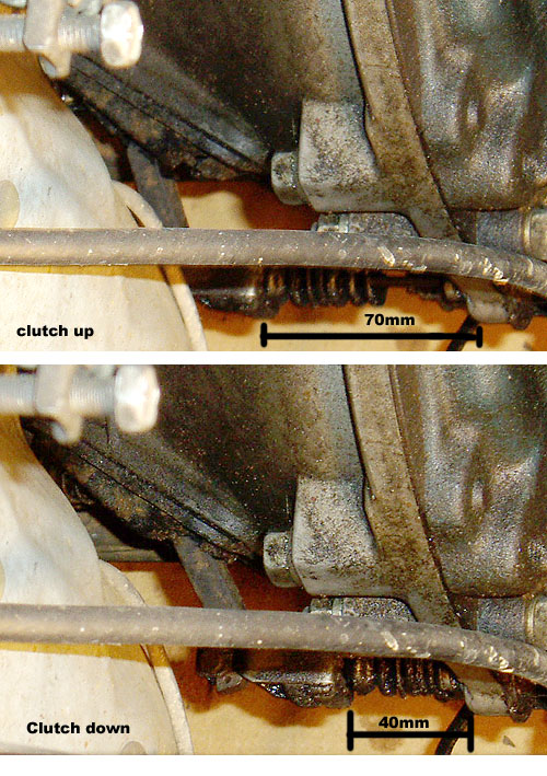

Ke70 Typical 4Age Clutch/Extractor Problem.
altezzaclub replied to B.L.Z.BUB's topic in KExx Corolla Discussion
Wrapping will slow the heat transfer for sure. It will still happen when you idle after driving hard, but much much less than no wrap. (I've got it on the Altezza and the KE70) If the brake fluid actiually boils you will have no clutch until the bubbles collapse so the higher the boiling point the better. I don't know how fast water contamination lowers the boiling point, but the manufacturers migh have those figures. I'd do both. -
