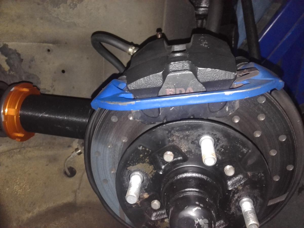

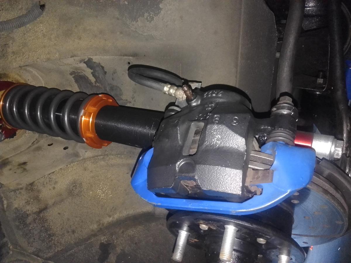

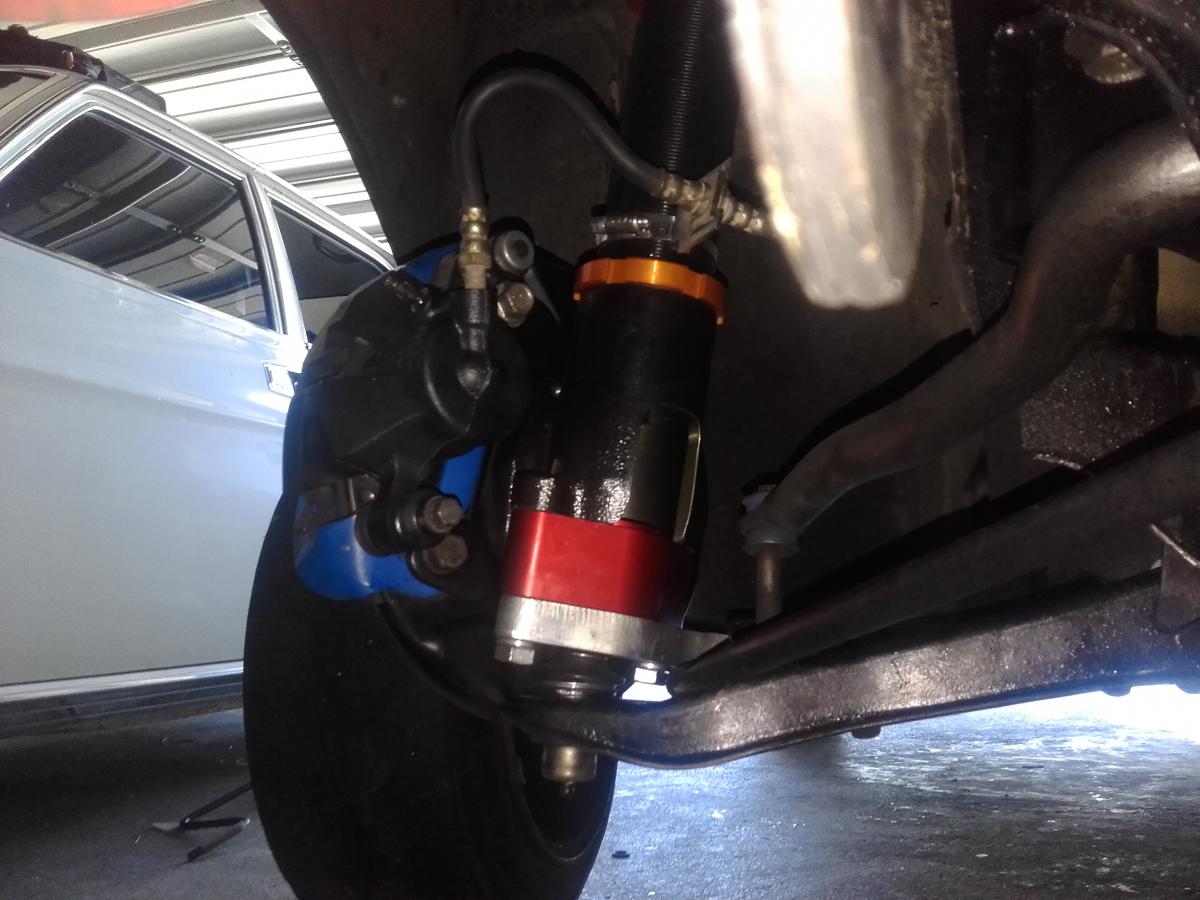

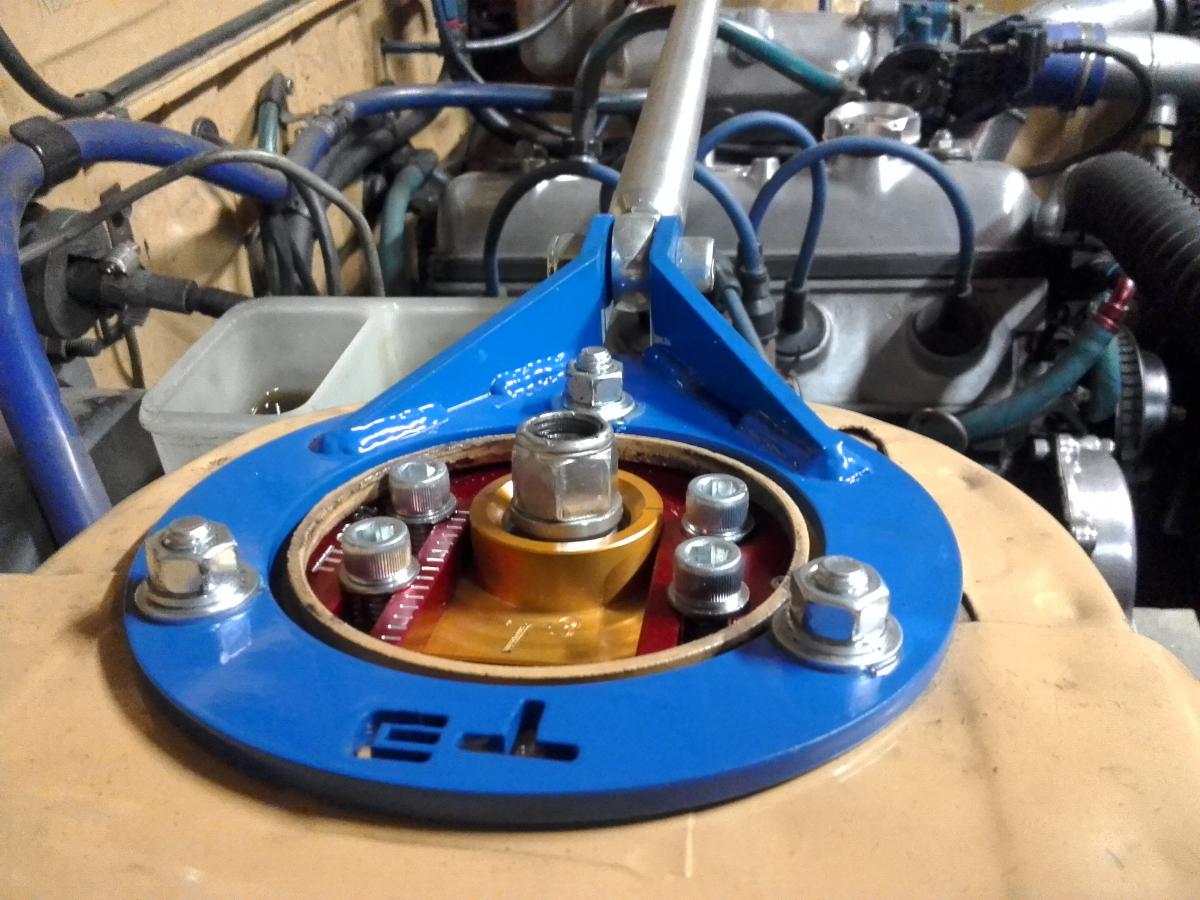

So I didn't get around to putting the specs list up last night....
Front:
Shockwoorks 86 base height adjustable coilover, 6kg springs, inverted 45mm 15 way adjustable dampers.
T3 86 steering arms
T3 roll centre adjusters
T3 camber plates
T3 strut brace
All new bushes and ball joints
Ae86 brakes with slotted and dimpled rotors
Also did the rear a couple of months ago but didn't update, is now:
Reversed eye main leaves
Shockworks base height adjustable 15 way dampers
All new bushes

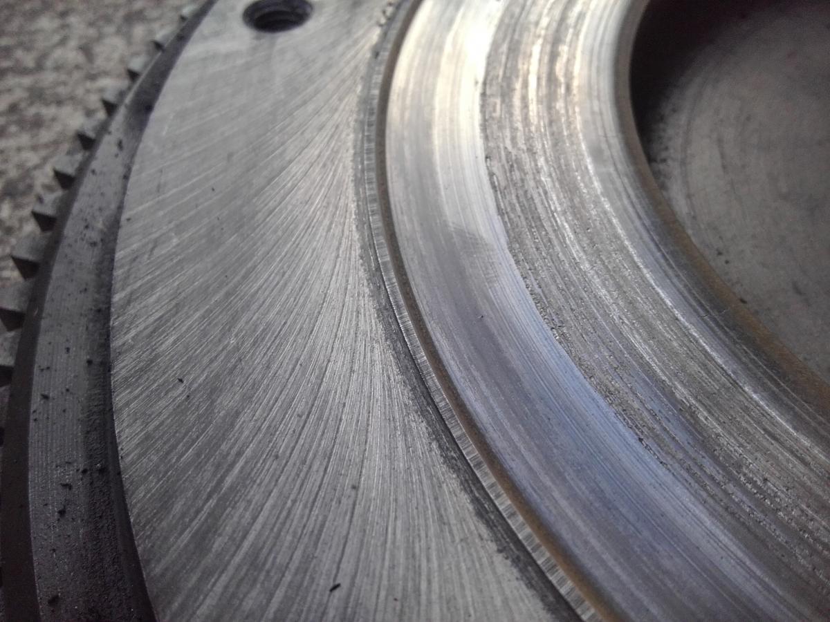

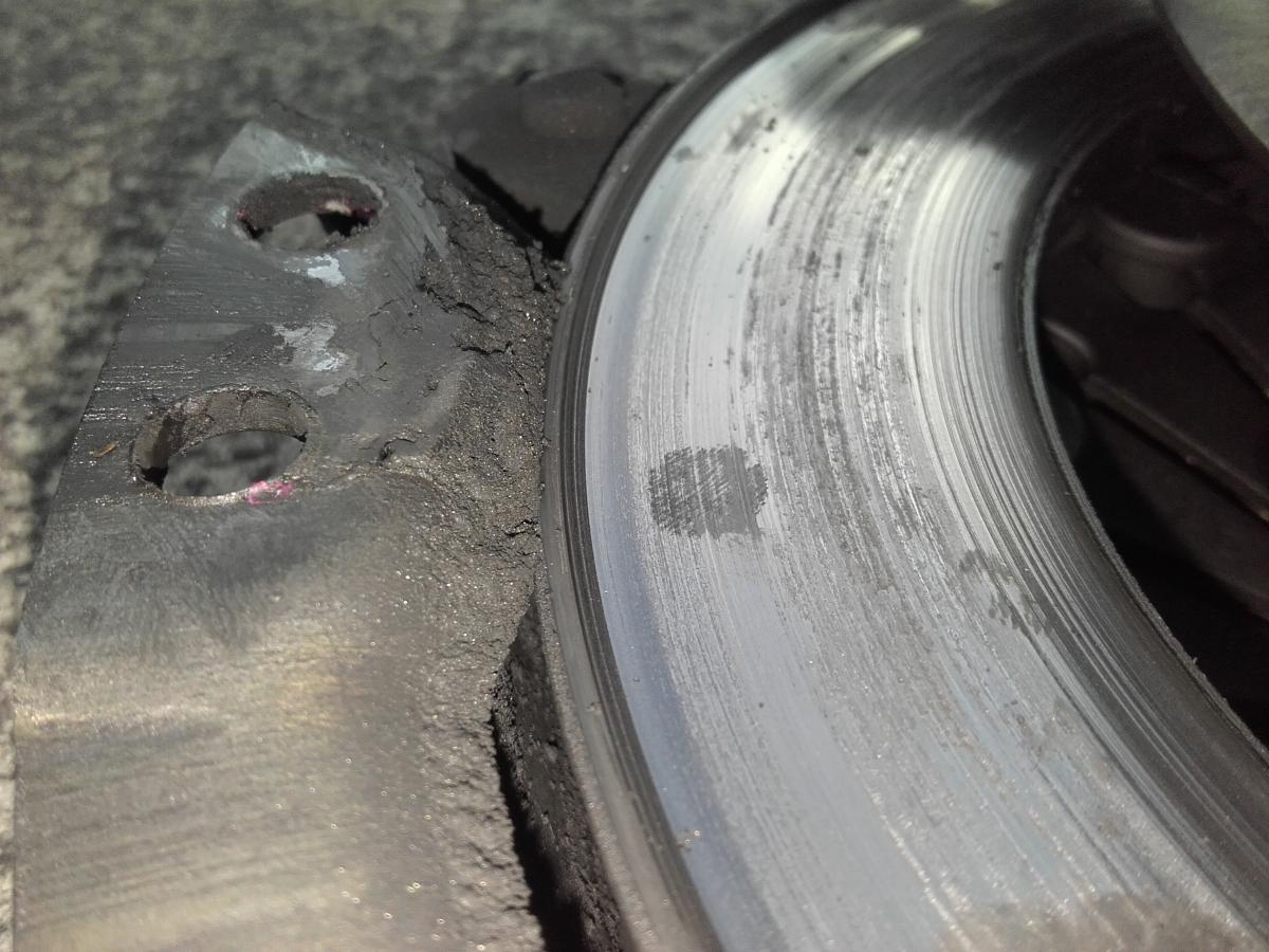

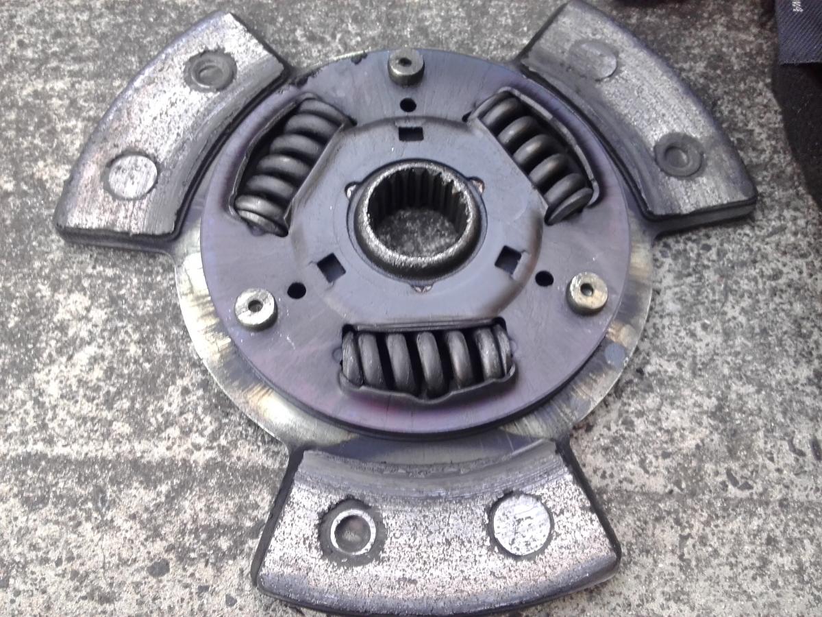

Got the clutch swapped out on Thursday/Friday. here's the state I found my flywheel in....

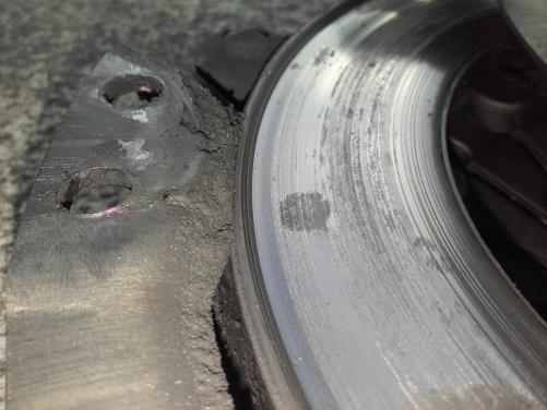

Pressure plate wasn't any better and the plate was well down into the buttons....
All nice and shiny and ready to go back together. Finally got around to weighing it while it was out..... a rather anorexic 4.8kg!!
Big thanks to Andrew (pozza123) for the hand in getting it back together. Would have been a much longer night otherwise. :y:
So good to be able to boost again. just need to get used to the new bite point and pedal feel now.

Looking good Si, that is a sexy strut brace you have :)
