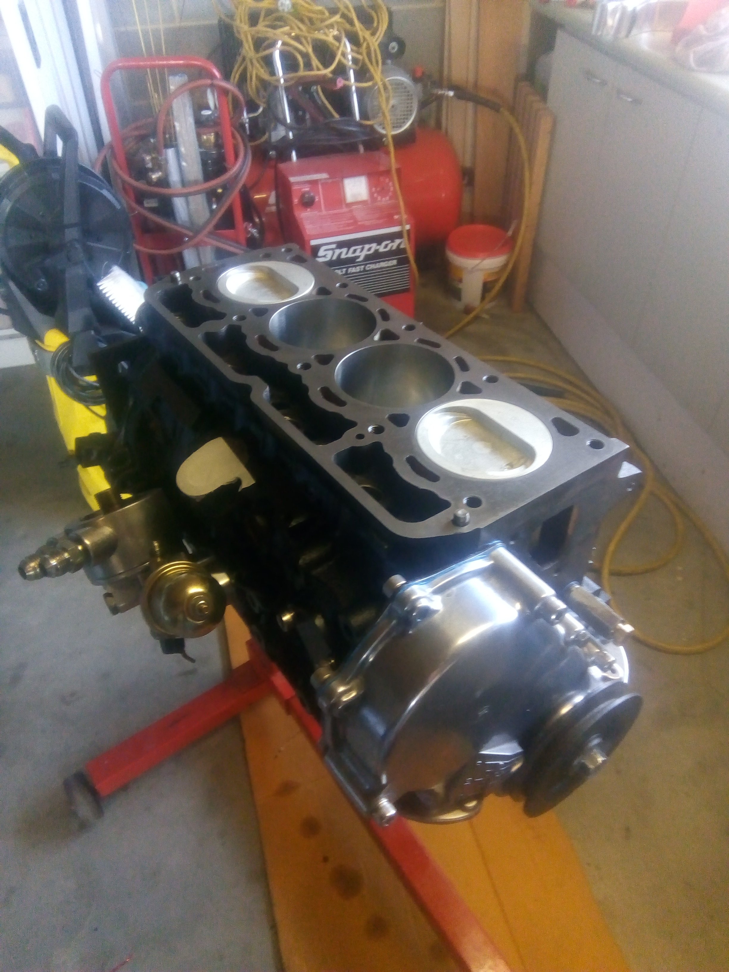

  • Looks a bit more like a motor again! Tried to bolt the manifold on this afternoon and managed to pull a stud out of the head 🤬 will have to wait until Monday now to get a helicoil for it. Once I'

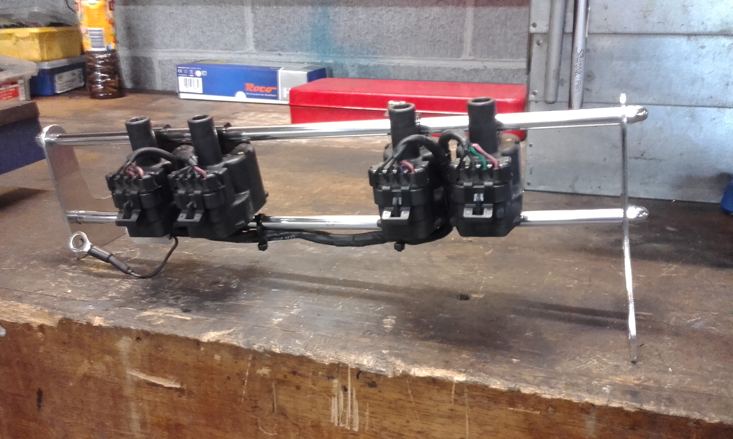

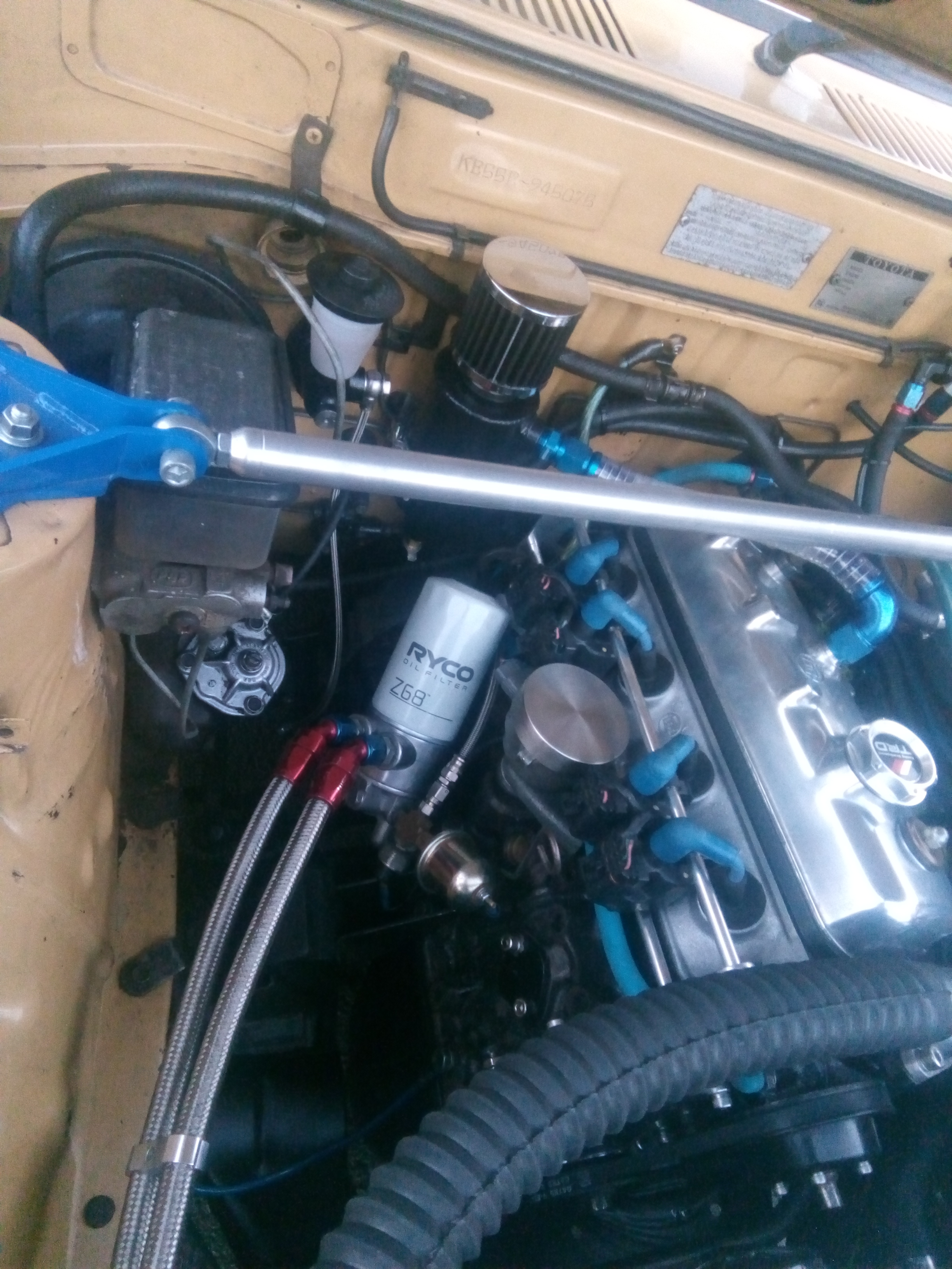

Looking tidy mate. Running full sequential?
Yeah mate all full. Still got some tuning to do, but due a rough double of the old fuel map is running pretty good.

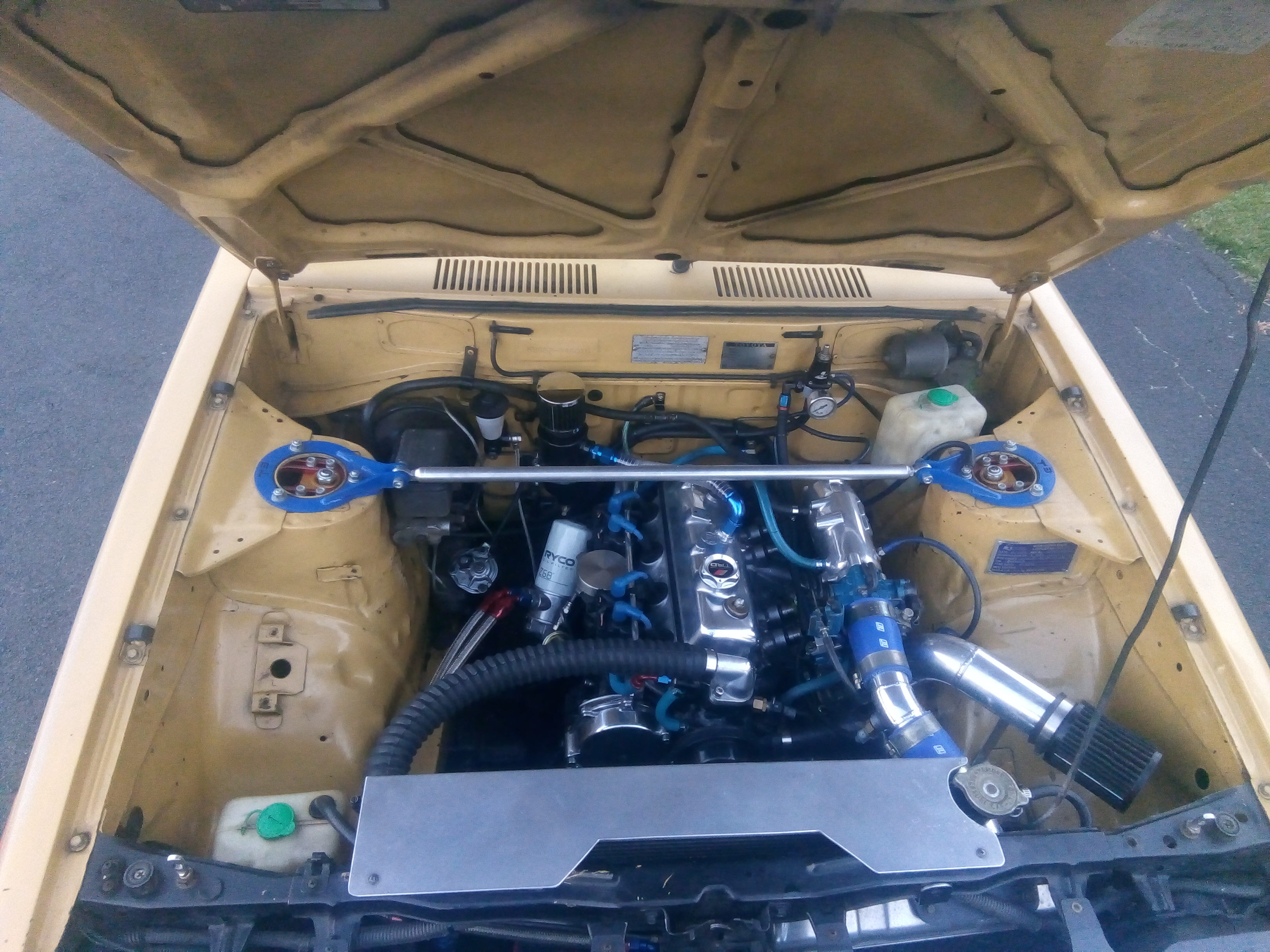

Lovely Simon !
Love those dishies.  Looks all sooo clean, you could almost put your bake beans in those dishes & have breakfast, whilst working on it !

Love your work.
Cheers Banjo

Had the junior mechanic on the job. Head on, and he helped me do valve clearances. It's looking more like an engine again now.
Everything has been cleaned and painted again. Then once it's back in the car I'll give the alloy a polish again.
Main changes this time are;
Another half mm over (now 1mm from stock)
Full balance
New hdcb exedy - t18 200mm kit
Pulling the 315cc injectors and dropping in some 550cc, since last time it was on the dyno we maxed them at 16psi
