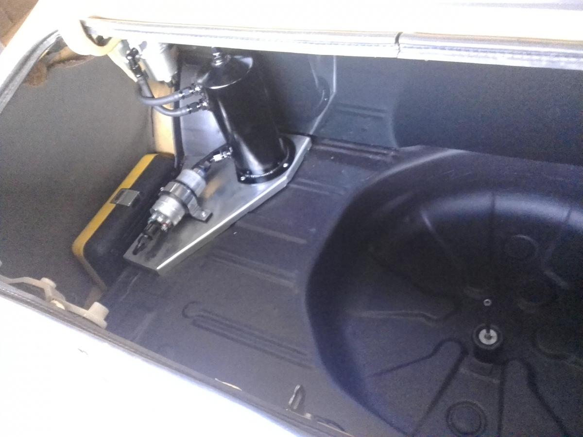

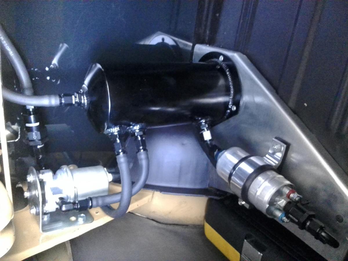

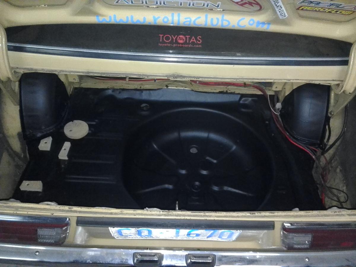

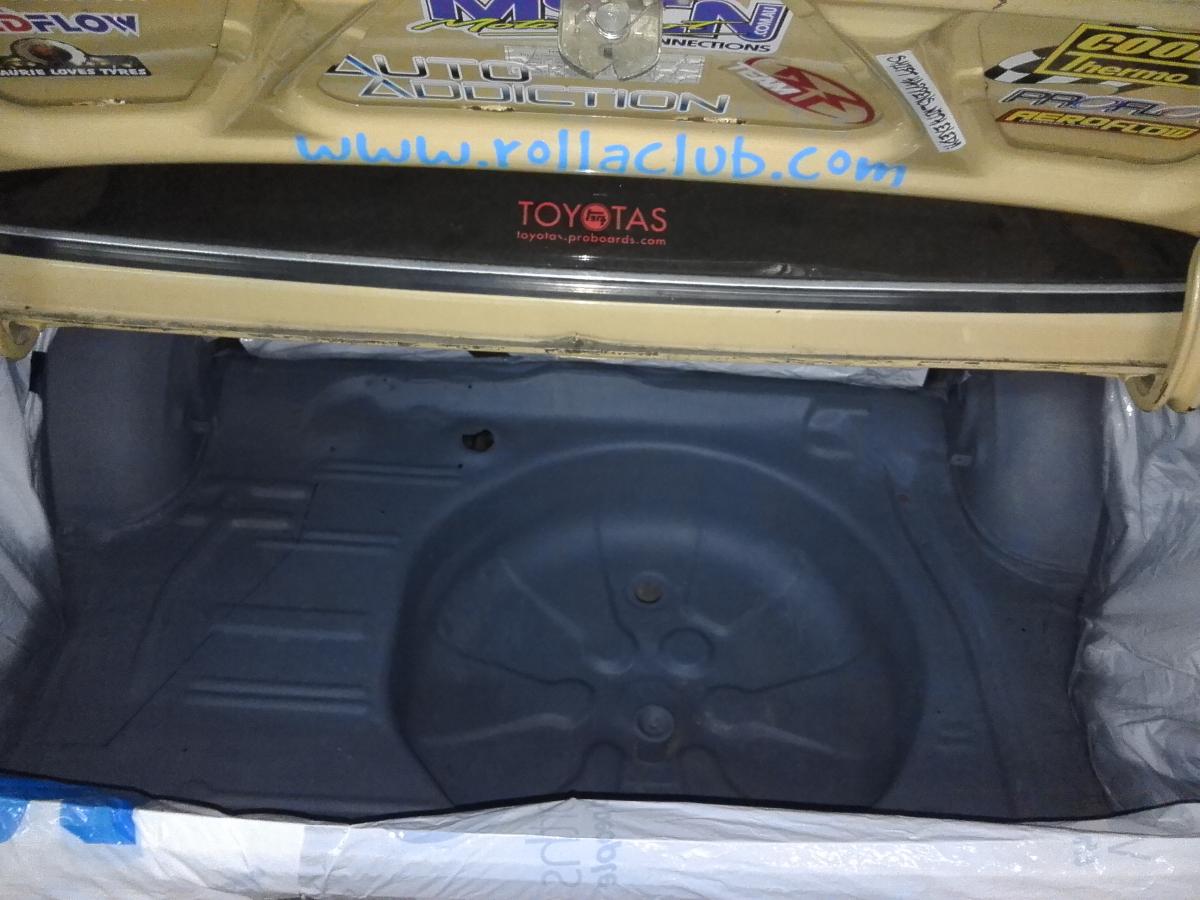

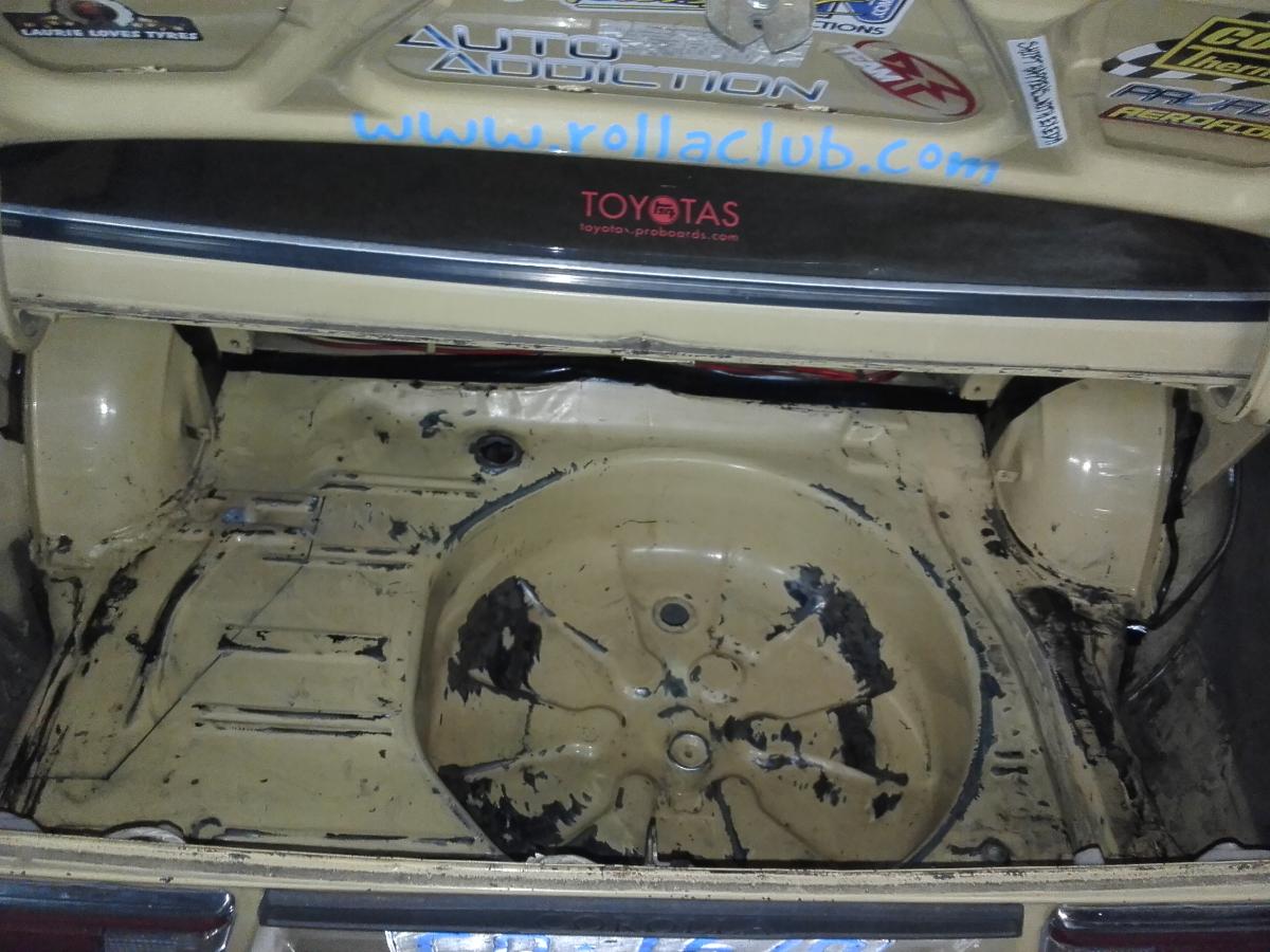

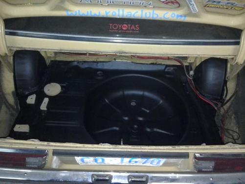

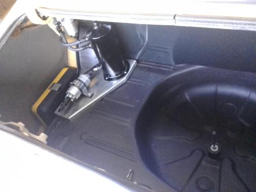

Just finished off my new fuel system. Now consists of a original tank with aftermarket level sender, Carter 4070 lift pump with an aeroflow reusable filter, aeroflow surge tank, Bosch 044, and all line/fittings in aeroflow -6. Things didn't quite fit how I originally planned so there were a few changes in configuration. While I had the boot all stripped out I gave it a coat of primer and some textured under body sealer for durability. When I fix some little rust holes in the lower rare quarters I'll paint the rest out too. Also made up a new panel for behind the tank, scored the material free from work. Its maybe a little to shiny but the price was right. For ease of mounting I also made up an alloy plate which the surge tank and 044 mount to. That tidied things up nicely too.
Stripped....
Primed.....
Underbody on....
System all finished....
Just waiting on some wheels to arrive now and then I can get my inspections done.
