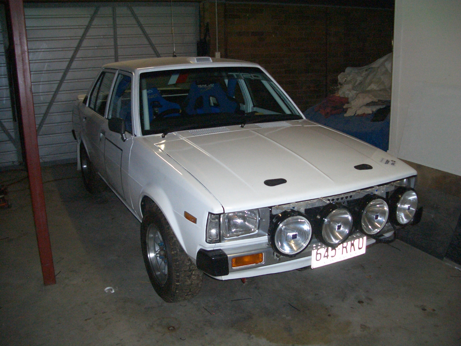

  • Very tidy, under 800kg is awesome. What do you reakon is making the rear right side a touch heavier?
  • far out that is cool!   wanna hang onto those scales untill saturday? ive always wondered how heavy mine is.   mine is currently in full "comfortable" street trim. (ie grosely overweight...)
Please excuse my french, but f&*k yeah!

The Corolla got weighed last night at scrutineering for the WRC and it came in at 809.1kg's with the lights on.
Fark! Looks like you boys know how to handle a hole saw and alloy bolts, well done!
Thanks mate, I'm very happy with that because it still has to have a fiberglass bonnet and boot as well as Lexan windows.
So hopefully 750 with all of that done. :o
But 809.1kg's with the lights on and ready to rally is very very good. :dance:
