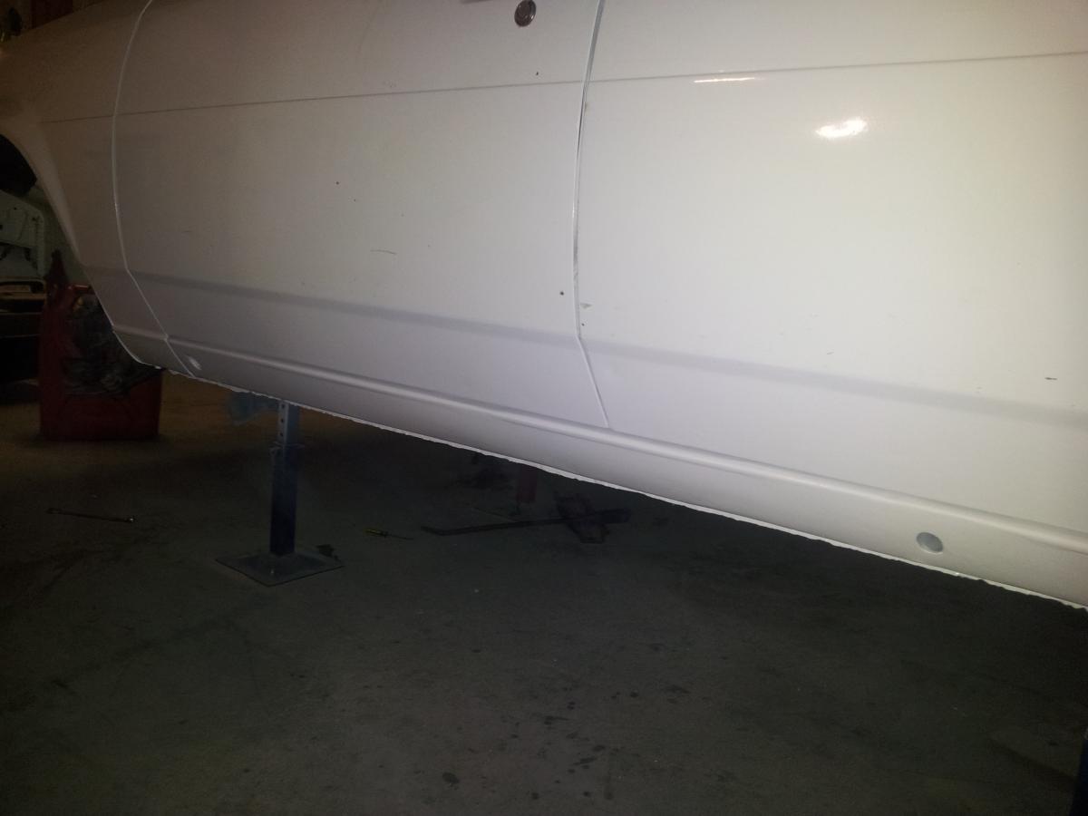

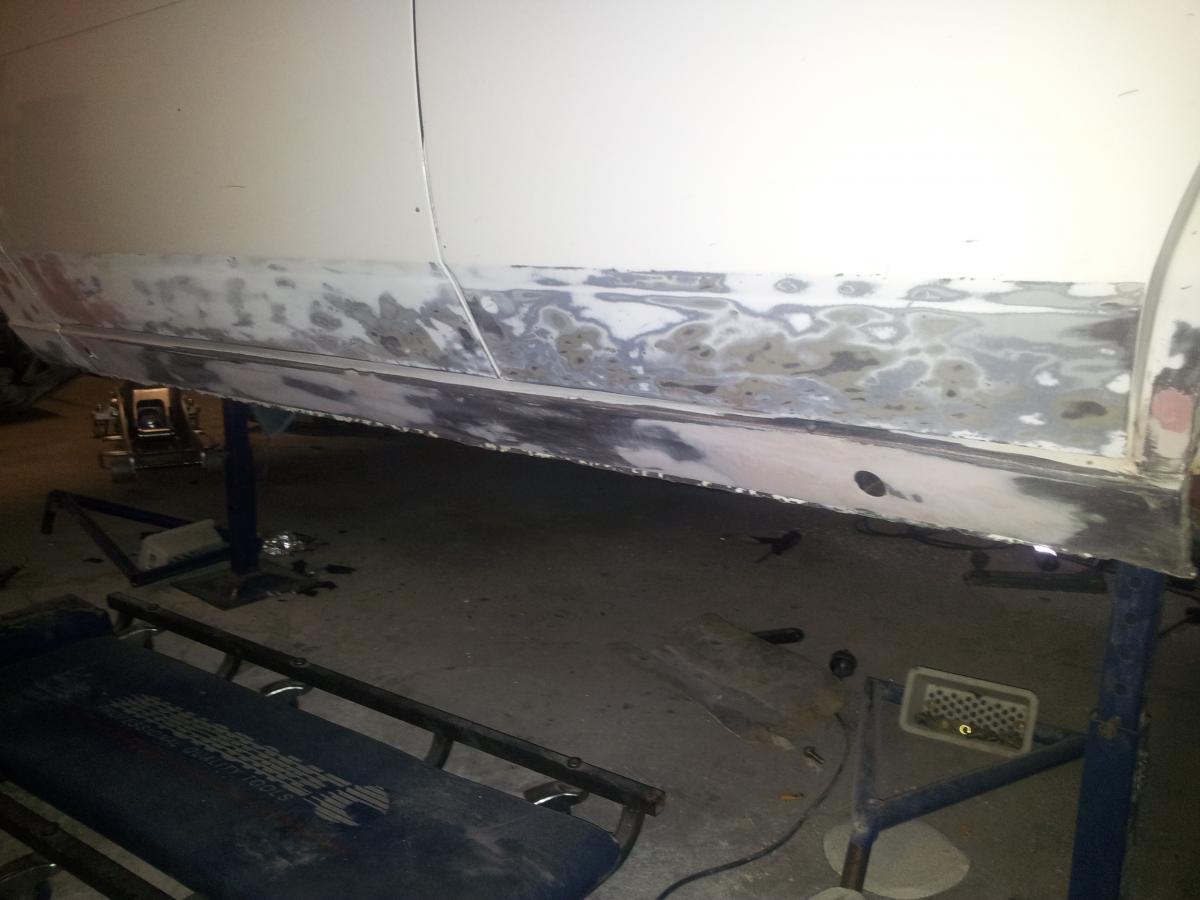

Doing some body repairs at the moment.

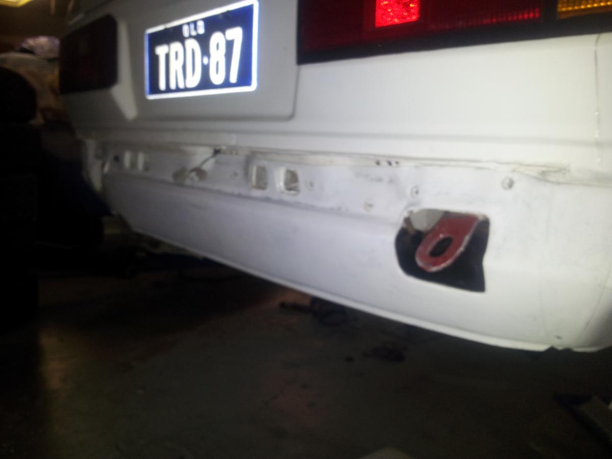

Sills had some damage. and the back panel had been smashed off, lucky it's fiberglass and we have a mould. New one all made and trial fitted to the car.

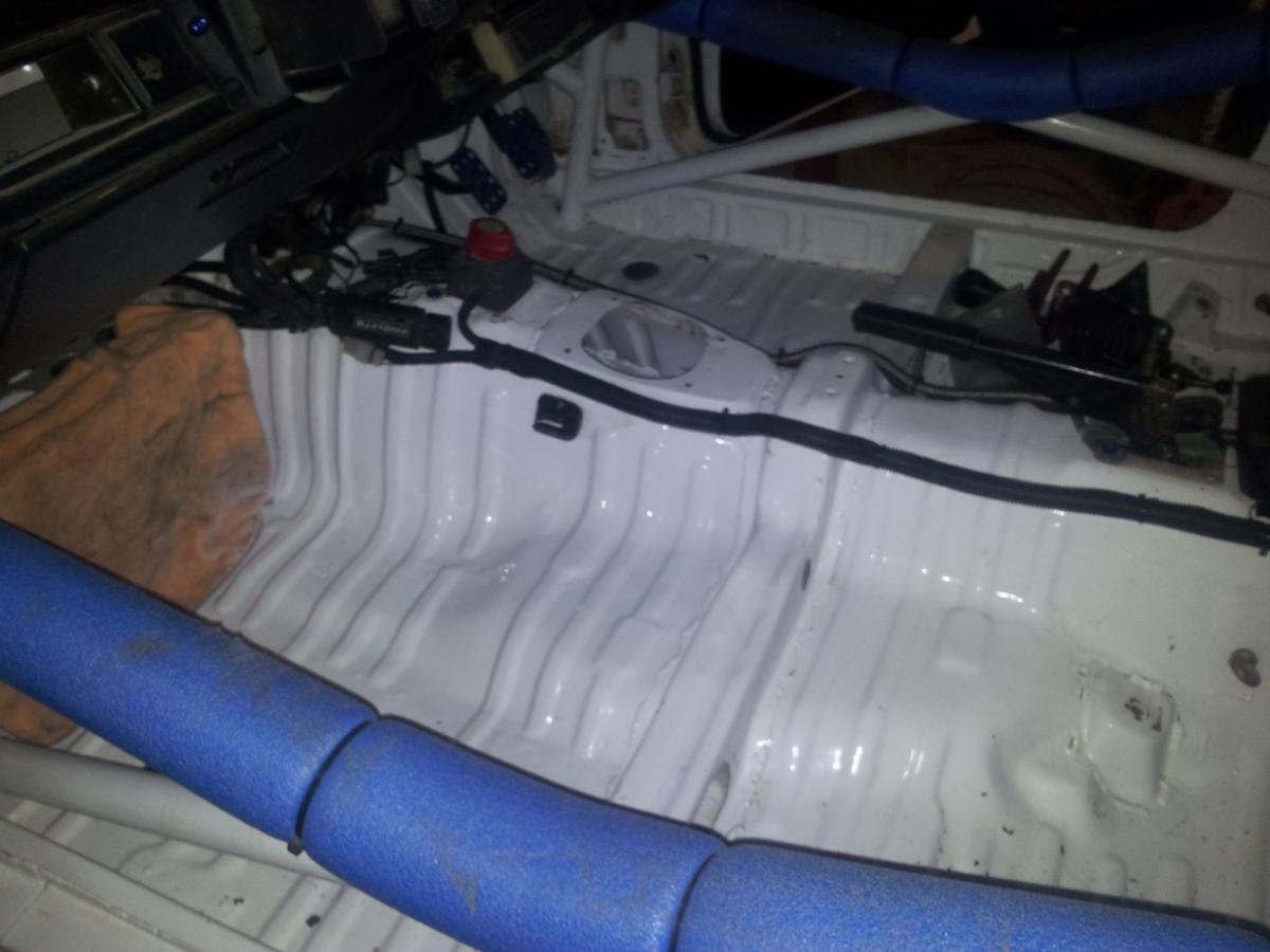

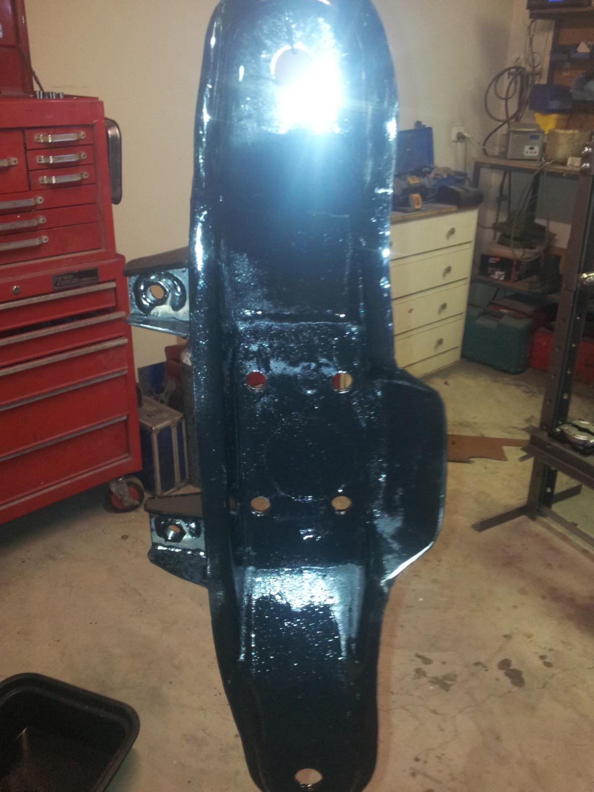

Inside floor tunnel all painted after the mounts been relocated.same with the under side.

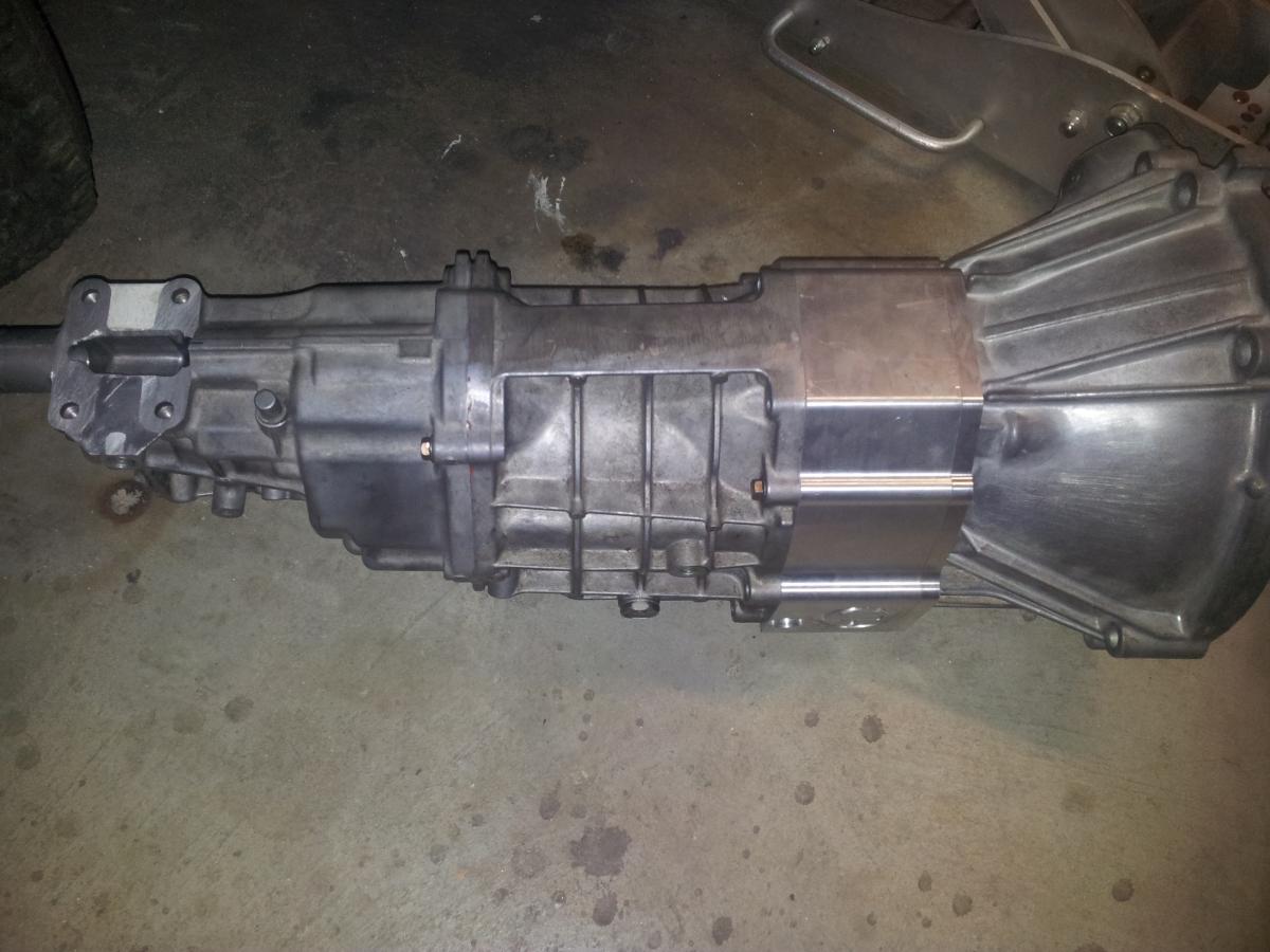

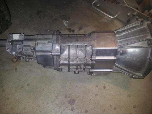

Tony's has finished the modifications to the gearbox, now just waiting on the close ratio kit turning up.
Should be here by the end of the month.

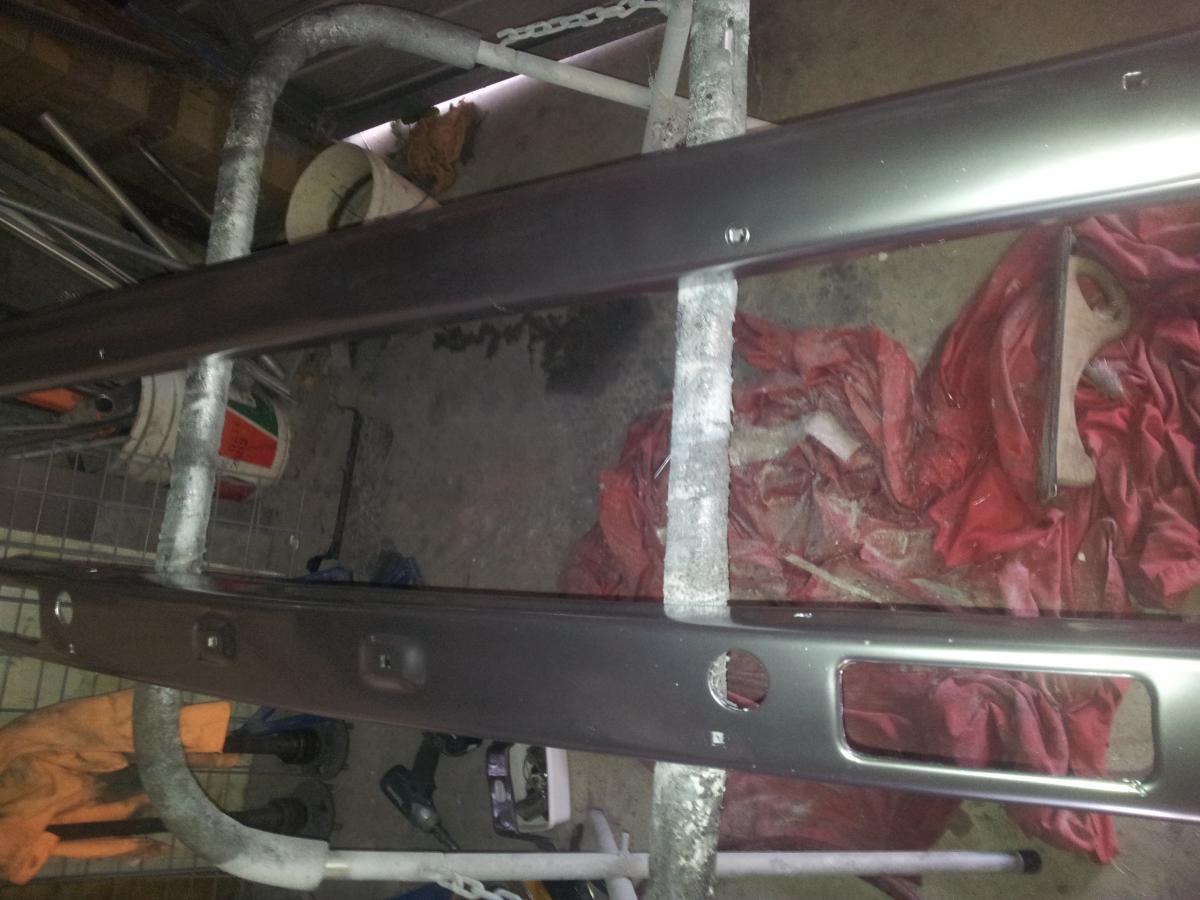

Decided to clean up and repaint the bumpers, they were full of stone chips.

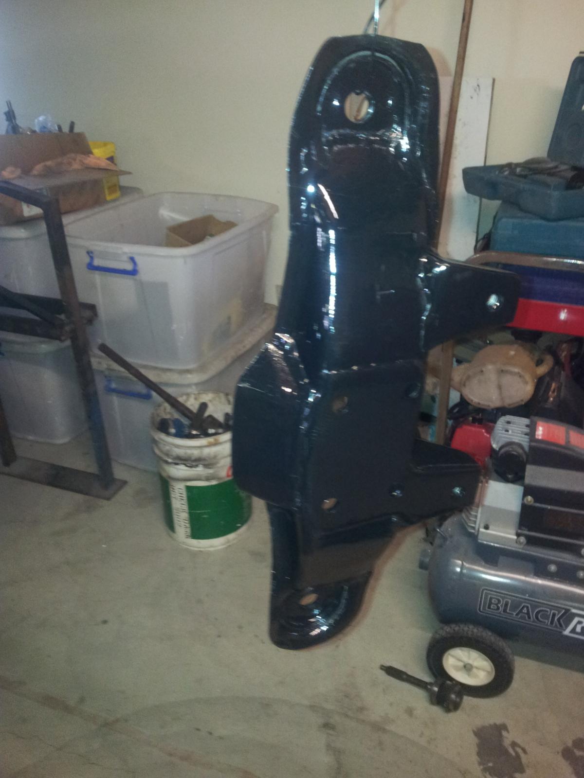

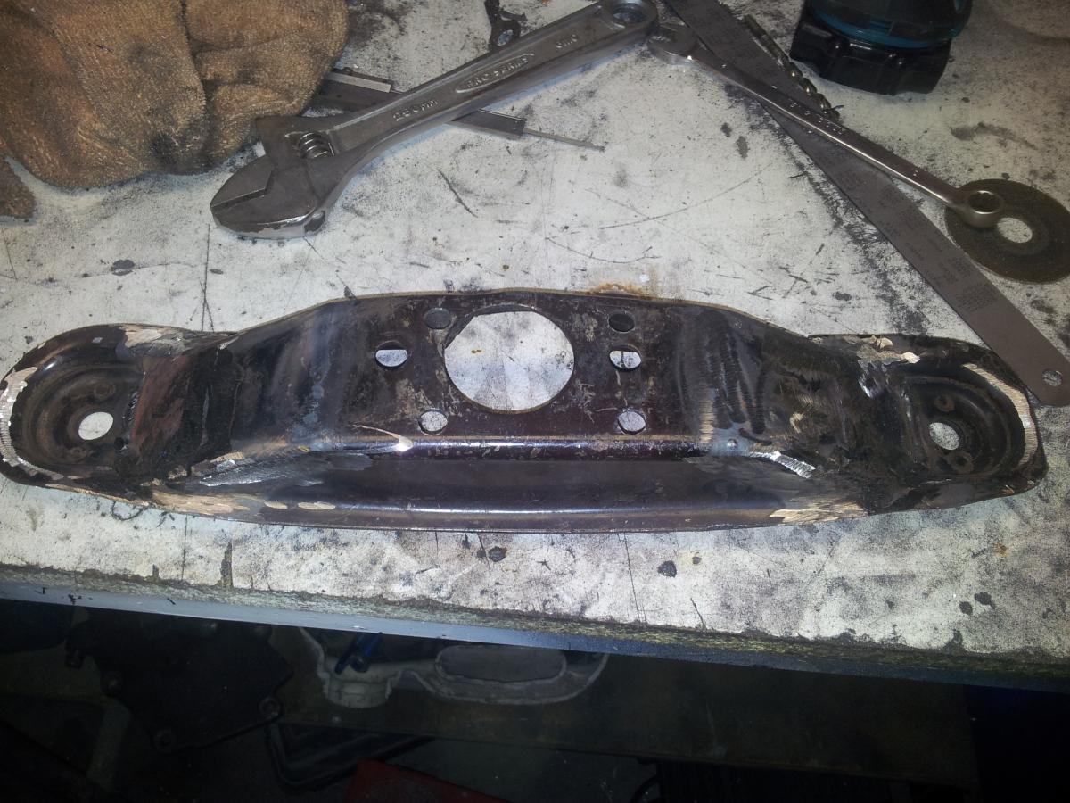

Half way through making the gearbox X member, biggest problem will be attaching the sump guard to it.

Have finally finished the gearbox cross member. :yes:

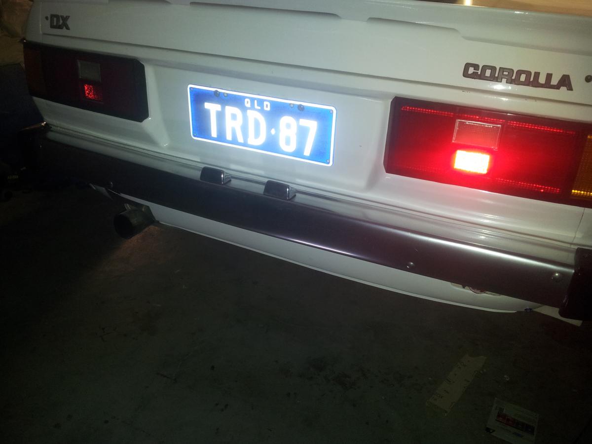

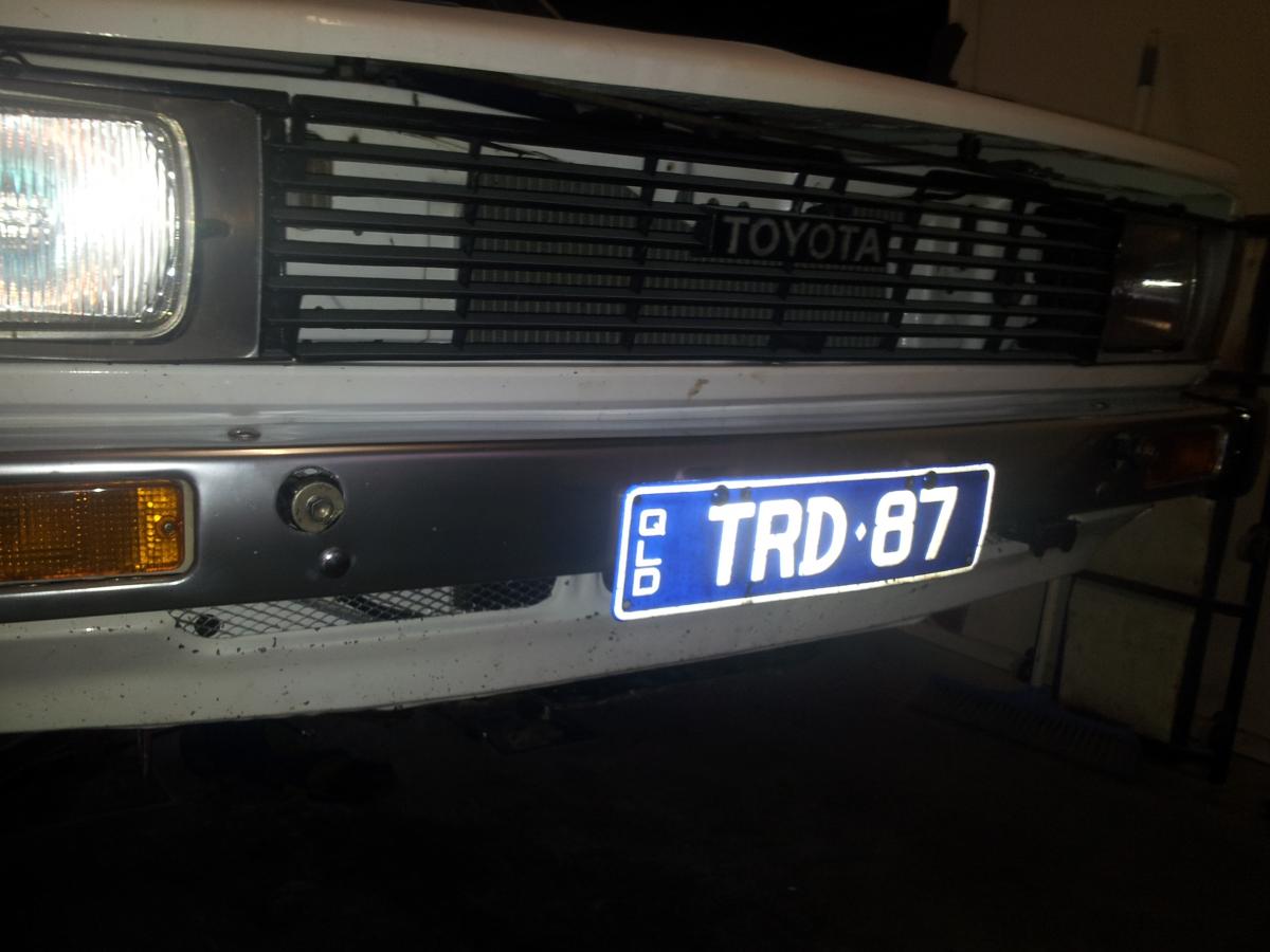

Front bumper is back together with new lenses and back on the car.

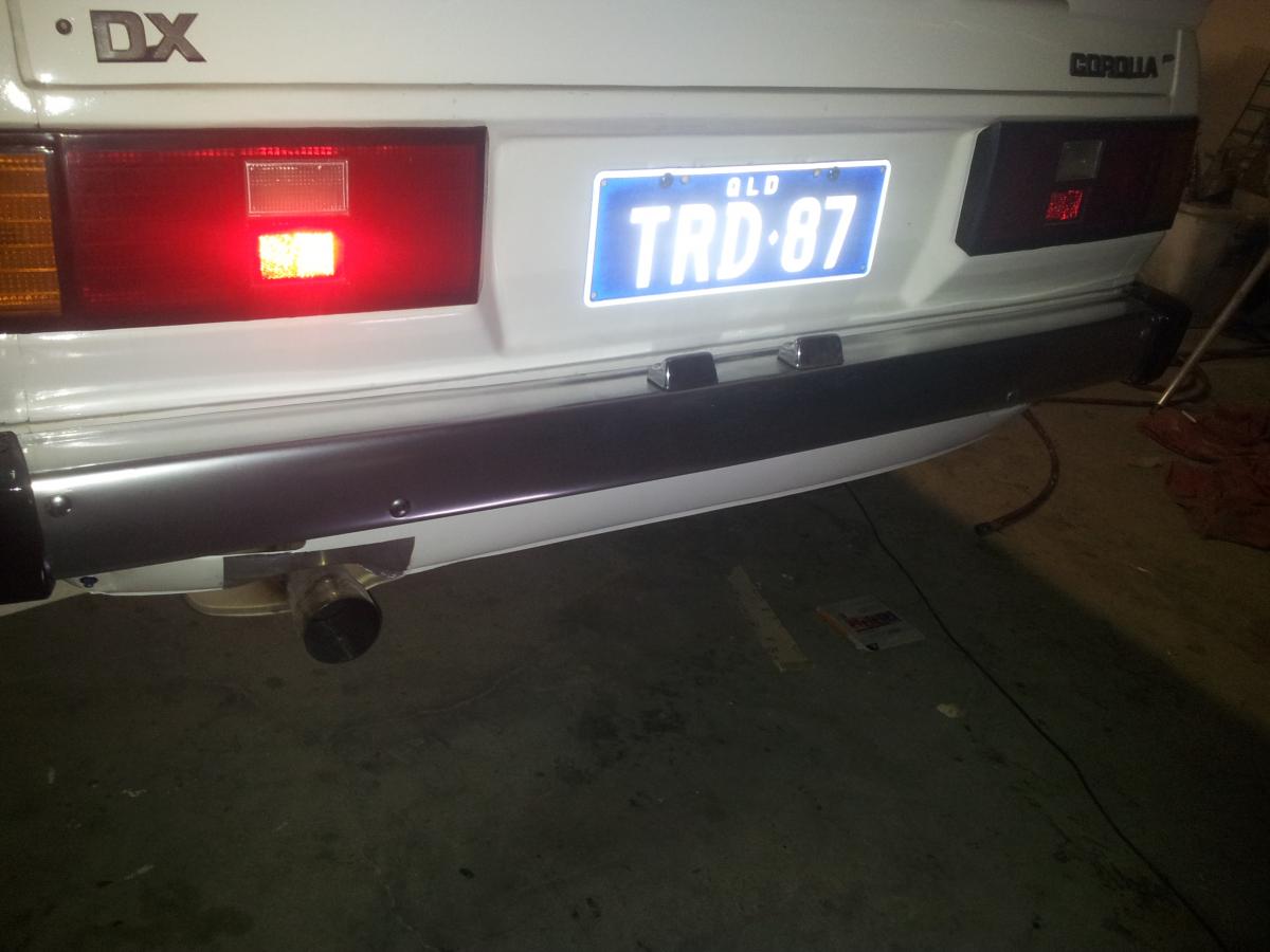

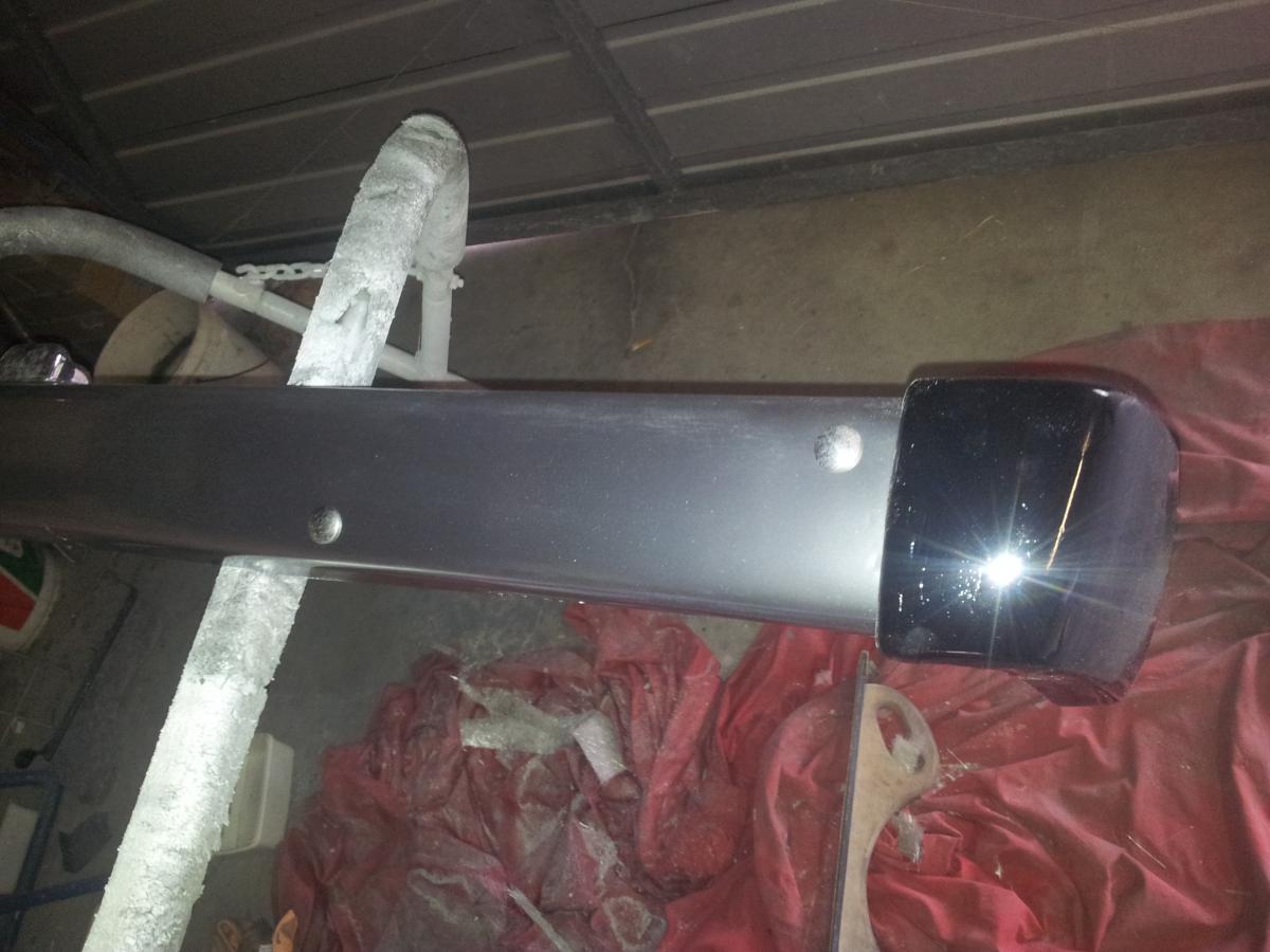

Rear one has been painted, bar ends repainted and bolted back onto the bumper, just waiting for the paint to dry on the rear panel and the bumber can get refitted.

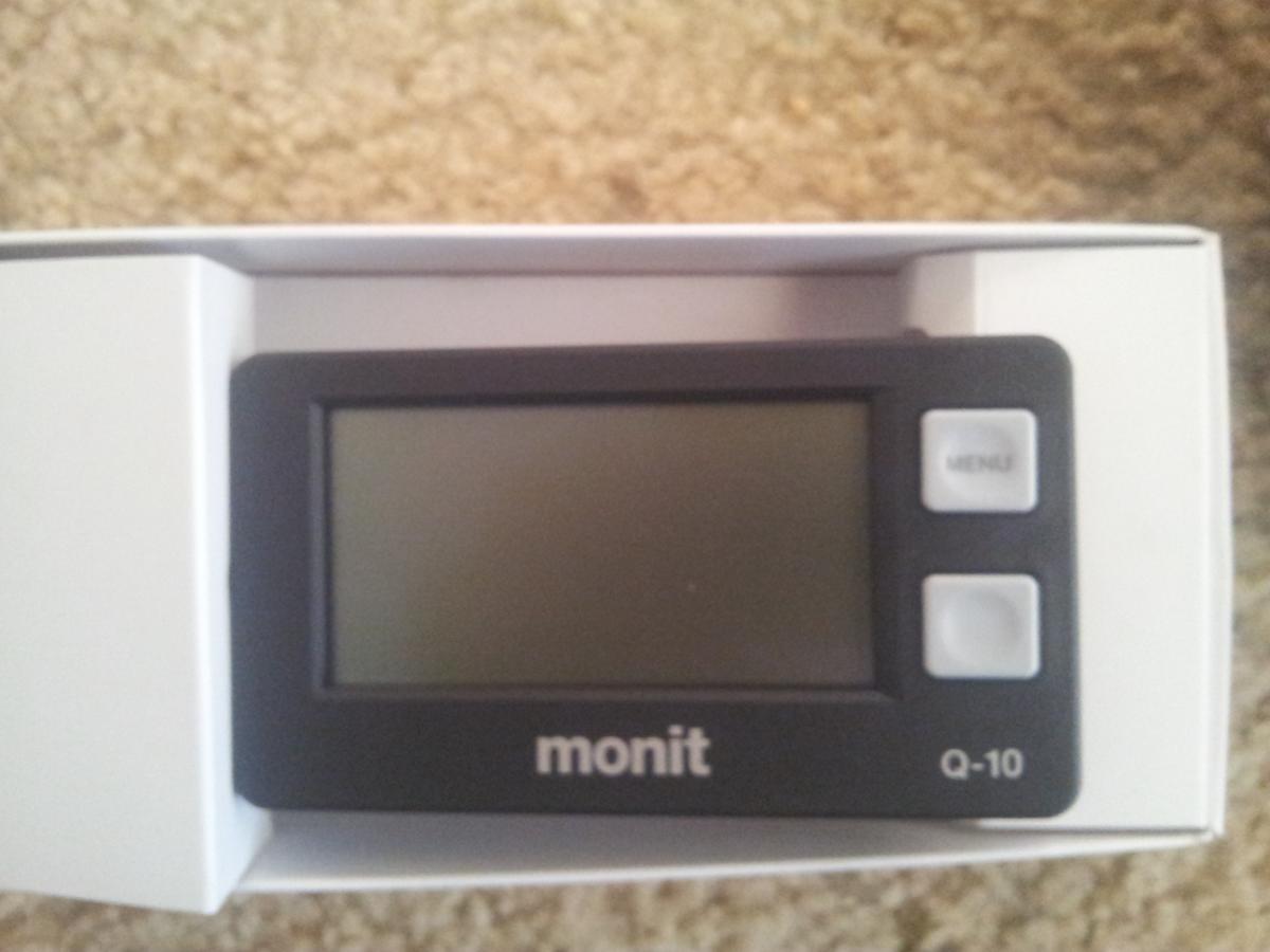

The old Brantz (rally trip computer) has done a great job since 1988, but it was time replace it with sometime better.
Lighter and easy to use. Weighs in at 26grams!!

Sills repainted, back bumper with new fiberglass stone tray all fitted up.

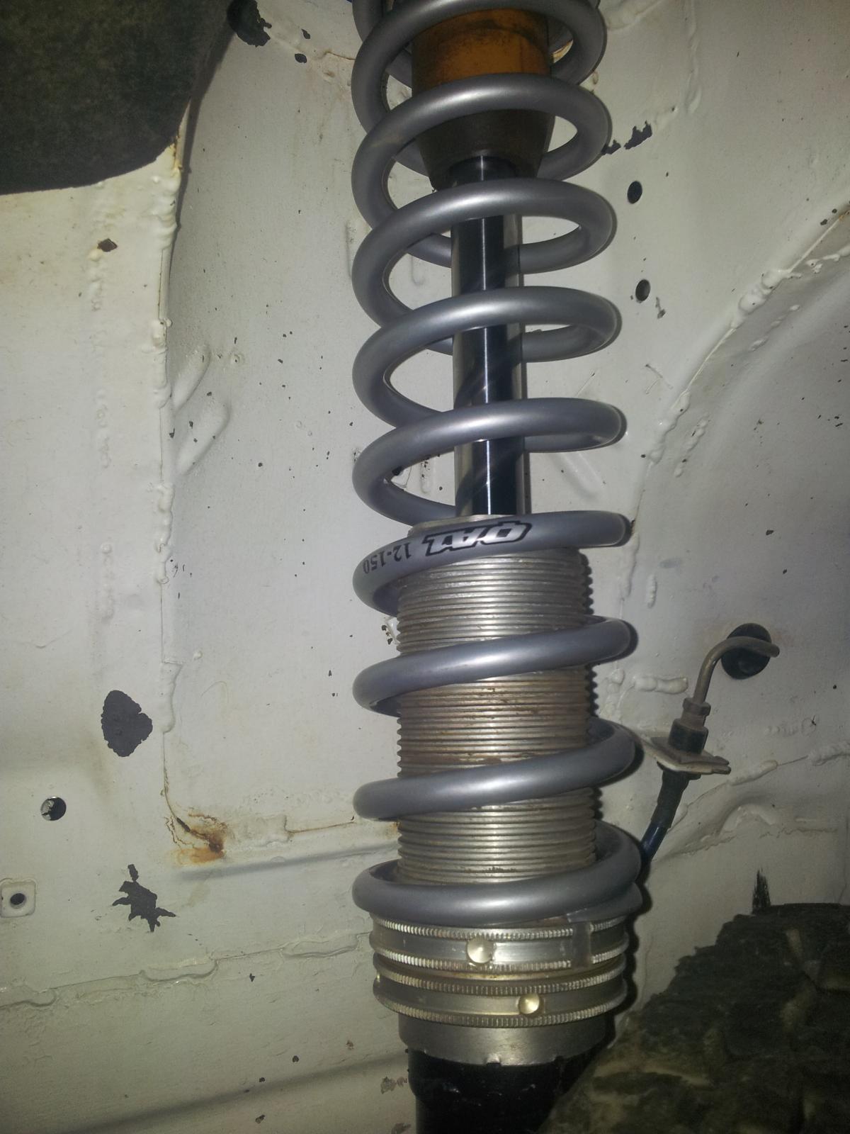

Now onto rebuilding the TRD shocks.
We've almost finished rebuilding our TRD shocks.

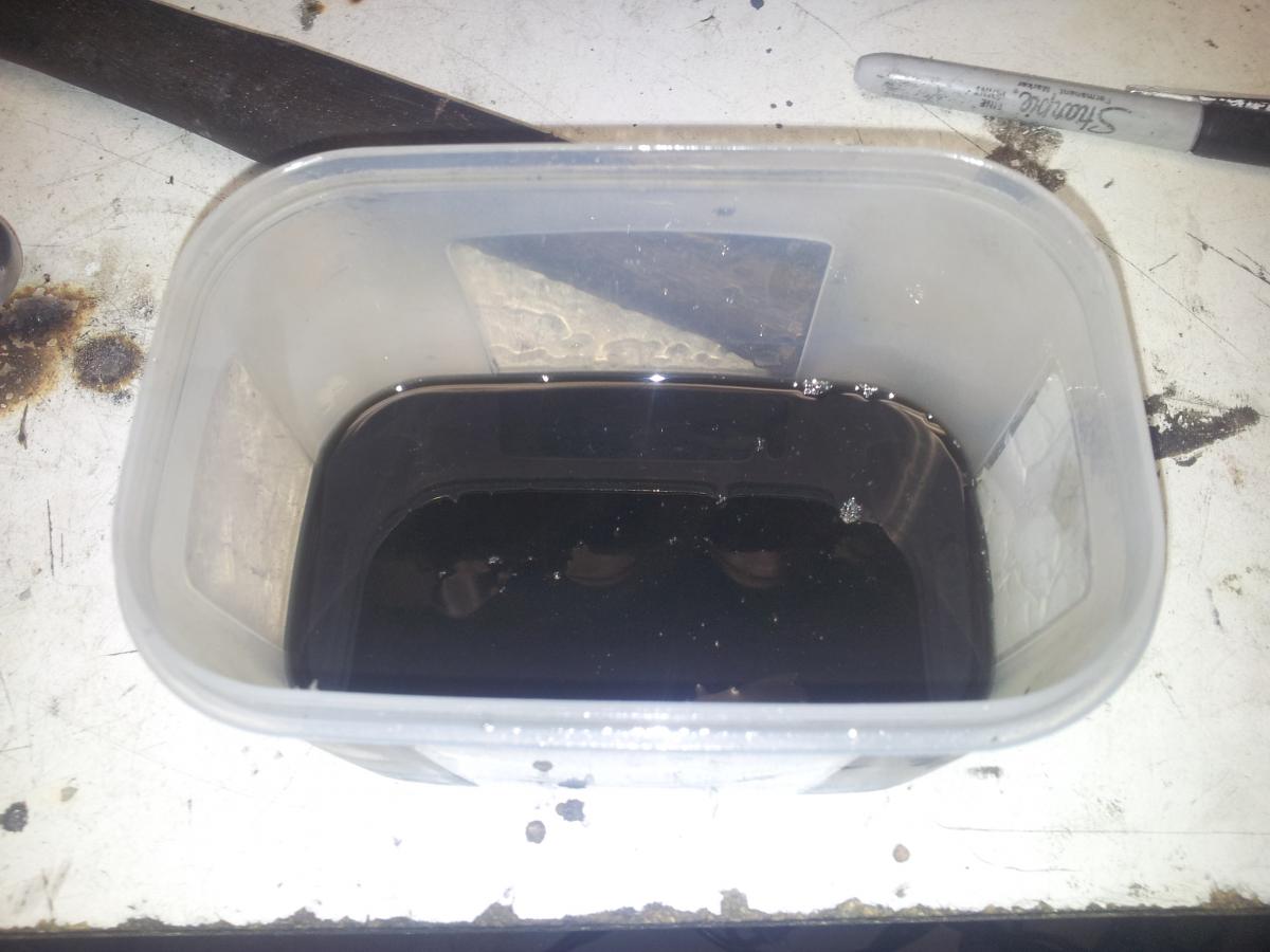

Pulled the last front one apart tonight and this was the oil that came out of it.

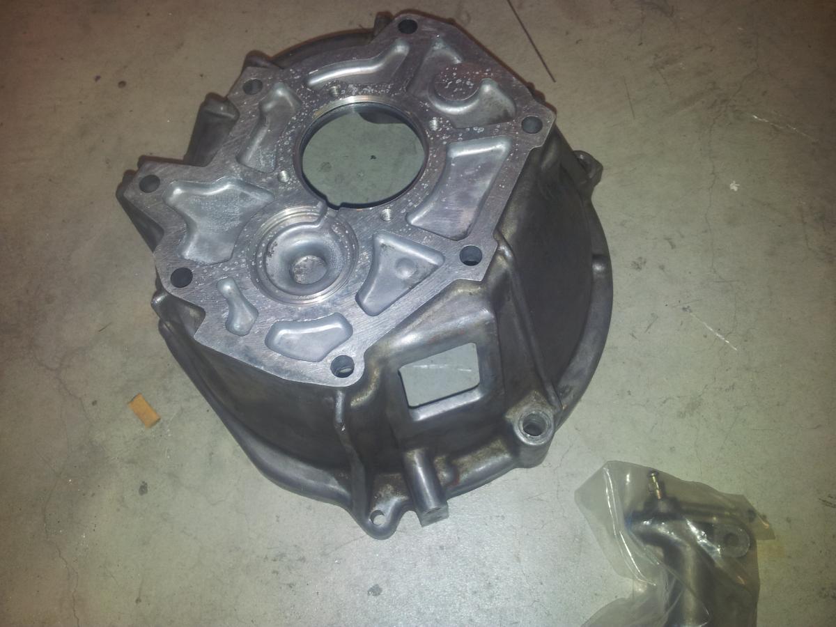

Had a great score in the weekend, thanks to Andy for the JDM bellhousing, cost a big FAT ZERO, just a little welding.
Assembled one of the rebuilt shocks with it's new 300mm springs, now has 50mm more travel.

Ohh I'm going to claim alot more welding for that bellhousing.. Ill bring over the dog next time!

Craig, because the corolla is a General body it's only got 2 x member bolt holes, where the old one had 3 been a japan corolla.
Yes it was painful.

Matt, those are still fiberglass bumpers, tony just gave them a clean up and painted them, they do look good.
