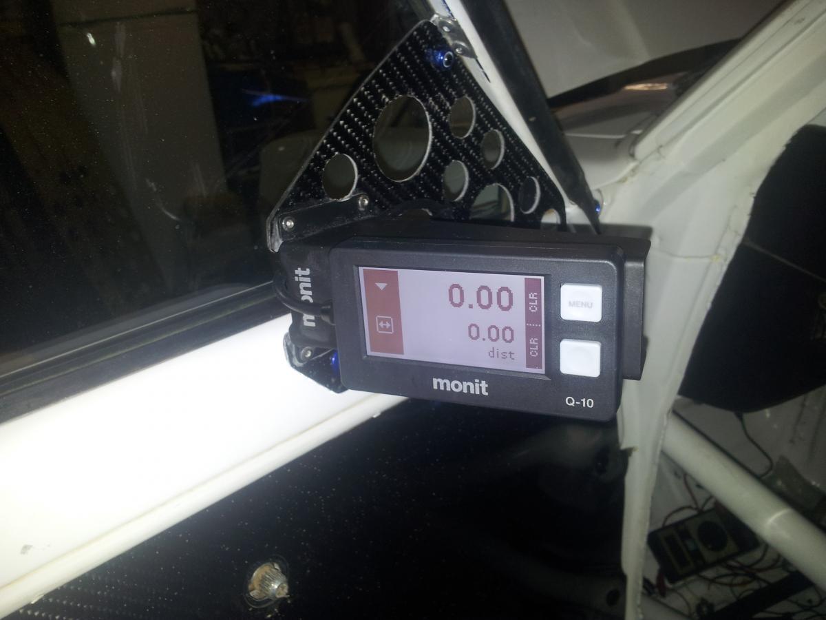

Mounted the Monit today, hopefully the co-driver will be happy with where it is.
Nice bit of kit!!!

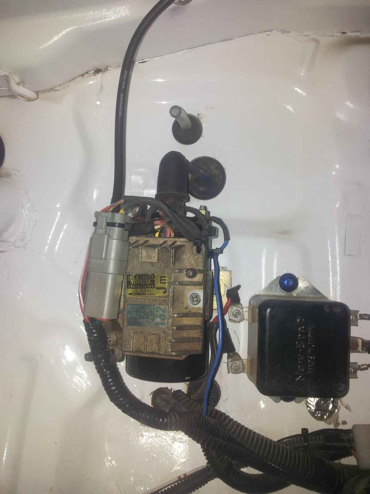

Got a few little jobs out of the way today.
Changed the igniter and re-wired the connection to the dizzy, now using a shielded cable, hopefully this will sort out the hi rpm miss.
Removed the speedo cable, as it's no longer required. The speedo runs off a sensor on the drive shaft and the Monit runs off the VSS(speed sensor), more weight out of the car. ;)
