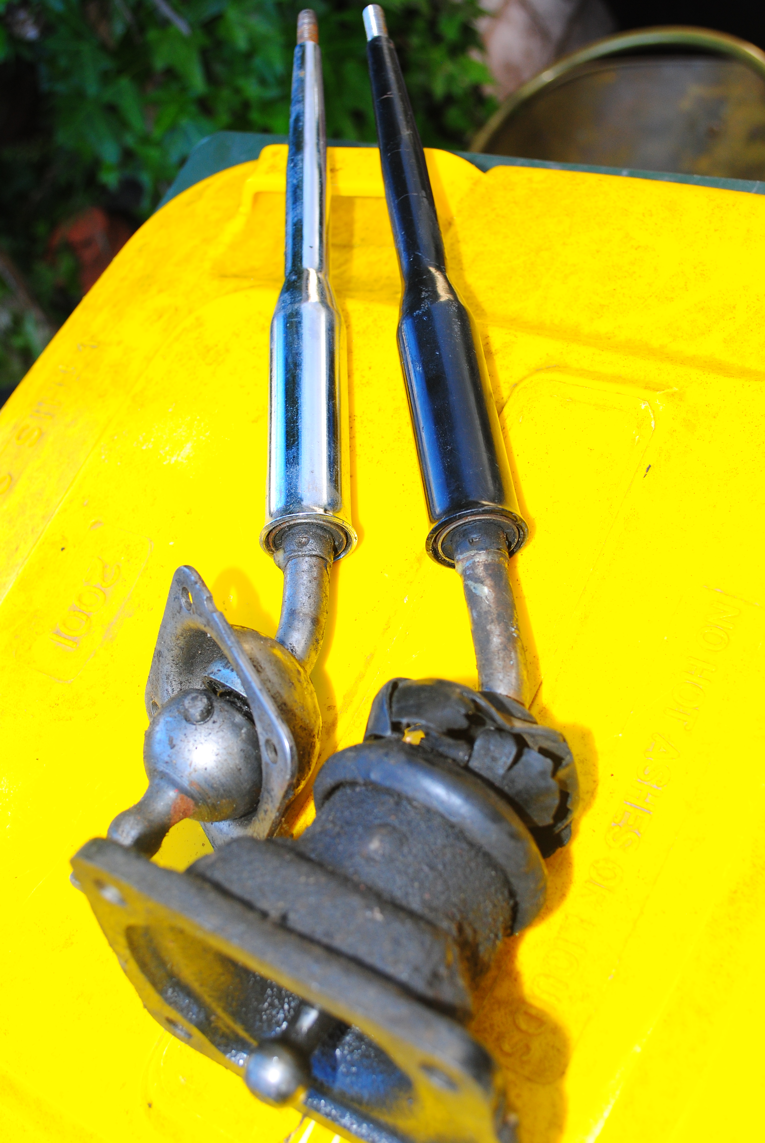

bruce Posted January 13, 2012 Report Posted January 13, 2012 (edited) Has anyone had any experience in removing the top part of the shifter from the middle section? I've got a K50 shifter that has had the gear knob thread cut off, and I'm looking at replacing it with another thread from a K40 or T50 shifter (since no other shifters fit the K50). Here's a photo of the sliver T50 shifter and black K40 shifter: Then the join which I want to undo: Looks like the top bit slides over the bottom gear stick shaft, then the side is punched in to fix it into place (with a bit of glue). Was going to hold it in a vice and get a hammer and chisel/screw driver and try and tap it undone. Though bit unsure if it's just been slid on, or actually screwed on. Don't want to ruin it. Edited January 13, 2012 by bruce Quote

bruce Posted January 14, 2012 Author Report Posted January 14, 2012 The bottom bits are different. Here's a photo for comparison. Left to right, TA22 T50, KE55 K50, and KE30 K40: Putting the K40 shifter into the K50 base plate fits, and can shift gears, but is sloppy, since it doesn't have that middle ball bit. Didn't put the circlip on. The cut K50 shifter end (probably to put a bigger thread on for a gear knob): Got a couple TA22 T50 shifters so I'll have a go at removing the top half. Quote
