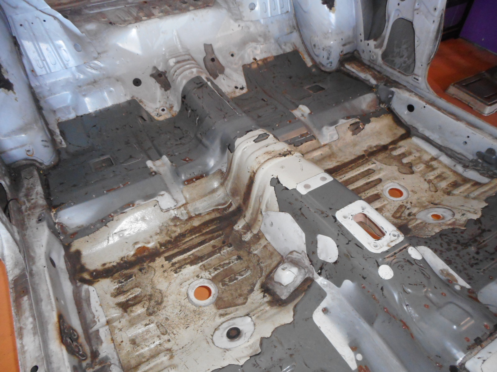

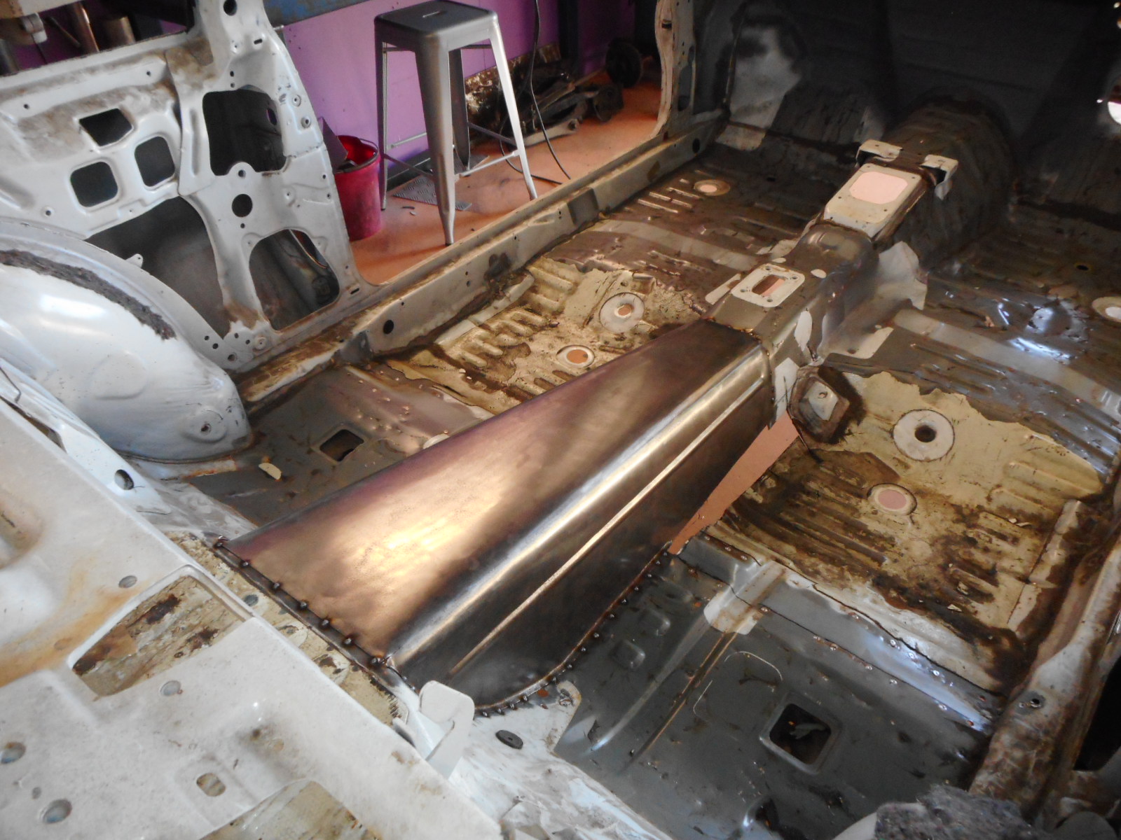

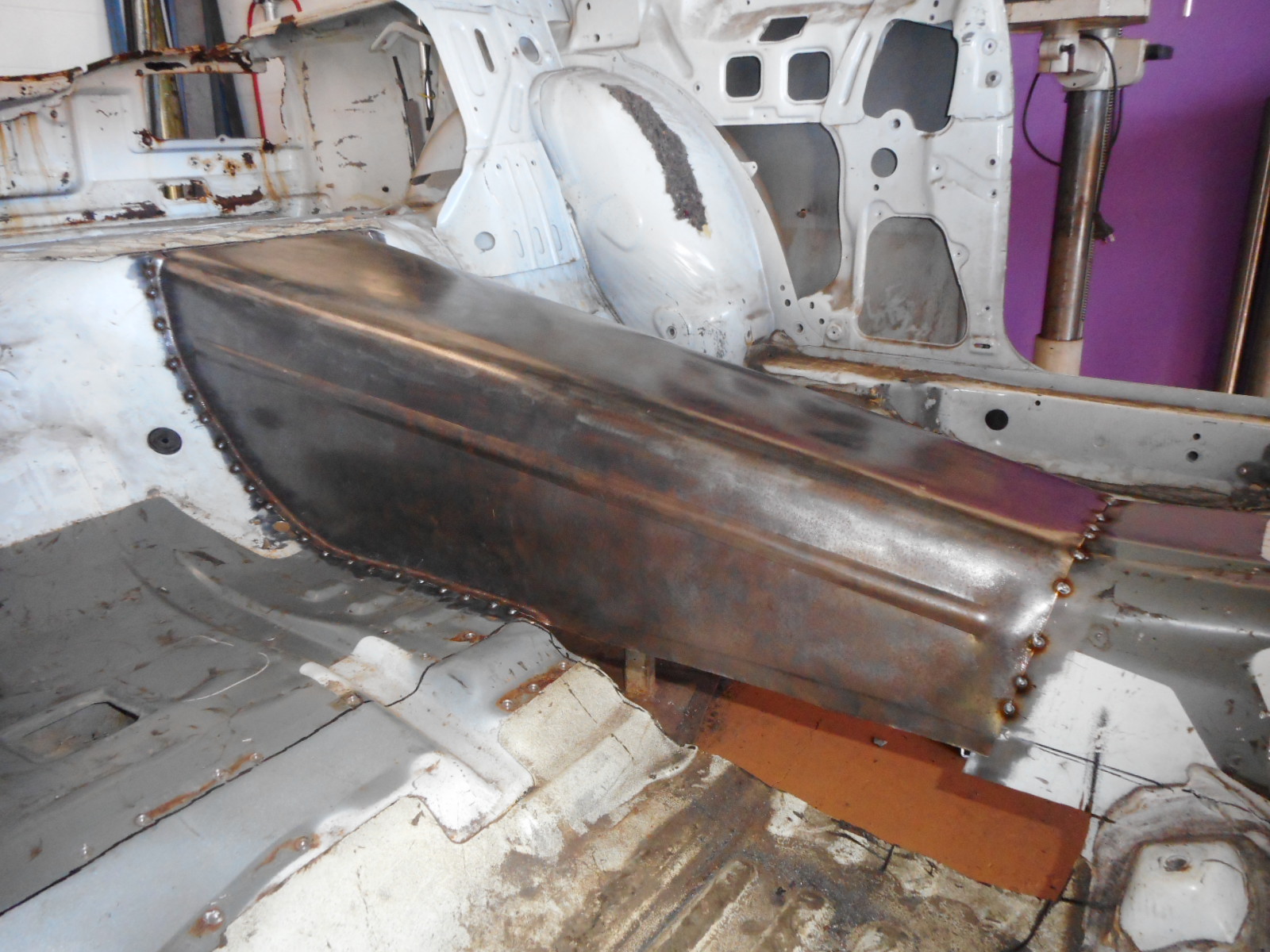

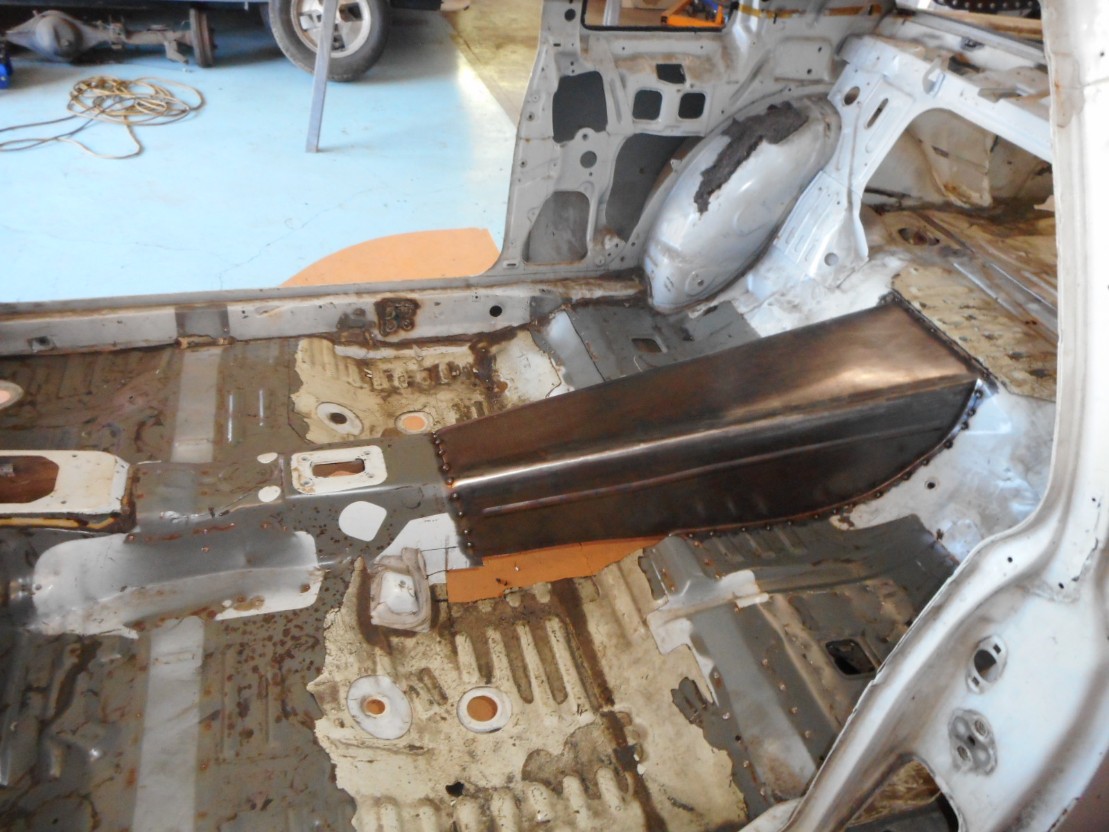

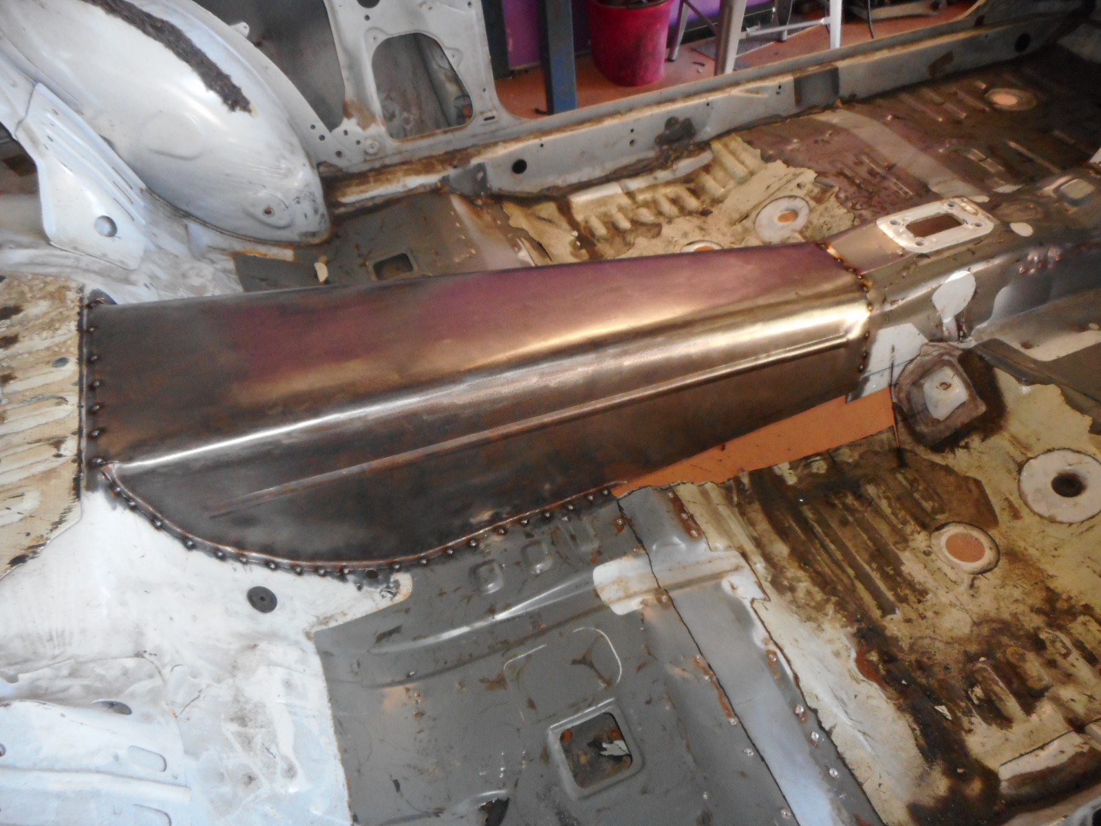

supra2 Posted December 13, 2017 Author Report Posted December 13, 2017 New big clearance tail shaft tunnel going in. 1 Quote
TRD ke70 Posted December 13, 2017 Report Posted December 13, 2017 Oh, you have been hard at work. Nice. Quote
LittleRedSpirit Posted December 13, 2017 Report Posted December 13, 2017 Do you base this build on the live rear or the irs? Quote
ke70dave Posted December 13, 2017 Report Posted December 13, 2017 Yah i was wondering the same. I cant quite work out the purpose of the larger tunnel at the rear. If its live axel i suppose it allows for more bump travel? If its IRS i'm not sure what benefit there is. But I'm sure there is a good reason:) Quote
supra2 Posted December 14, 2017 Author Report Posted December 14, 2017 Yep, big travel live axel. Ill never use that much, but its a replica and thats how TTE built them. Quote

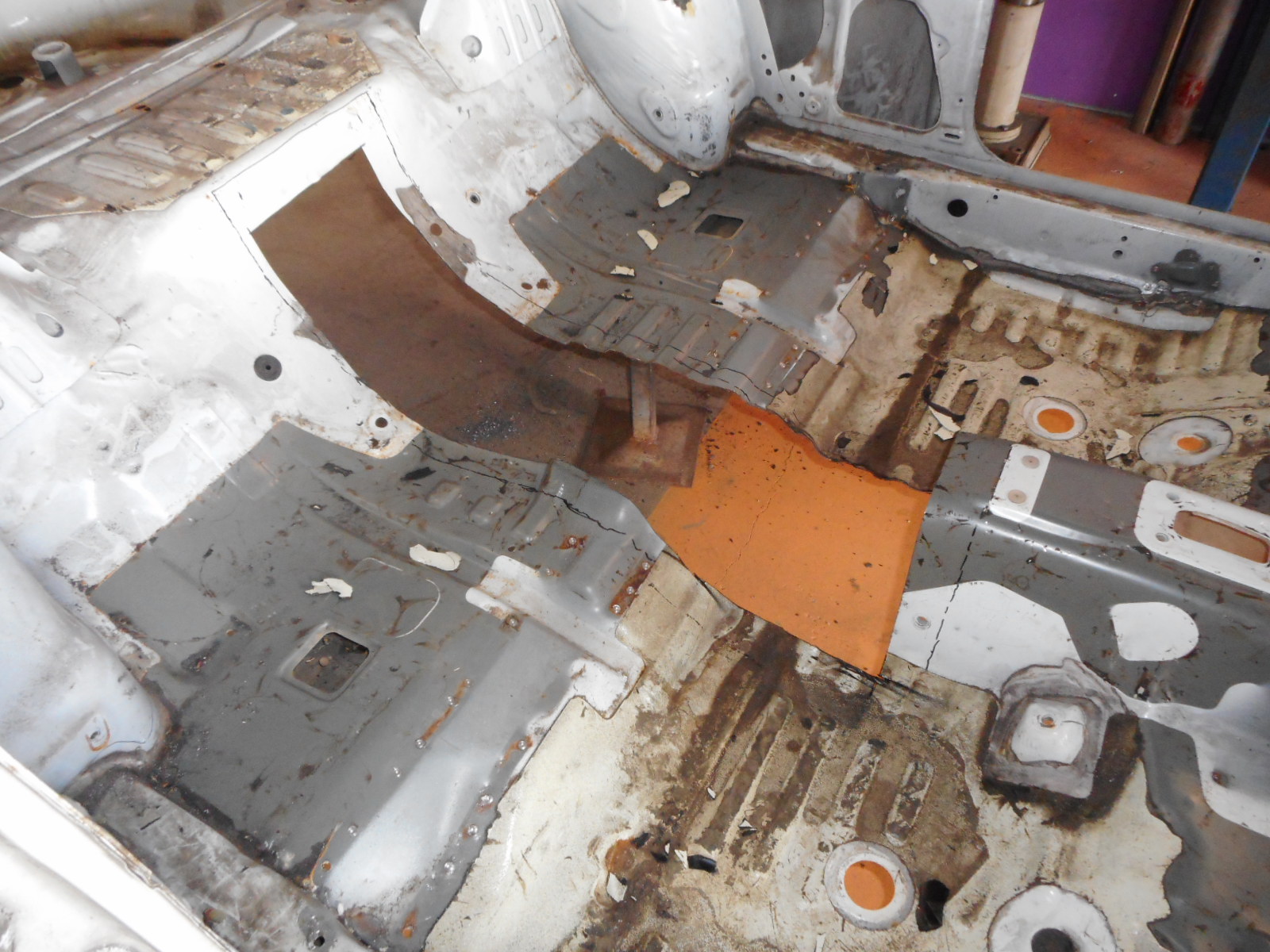

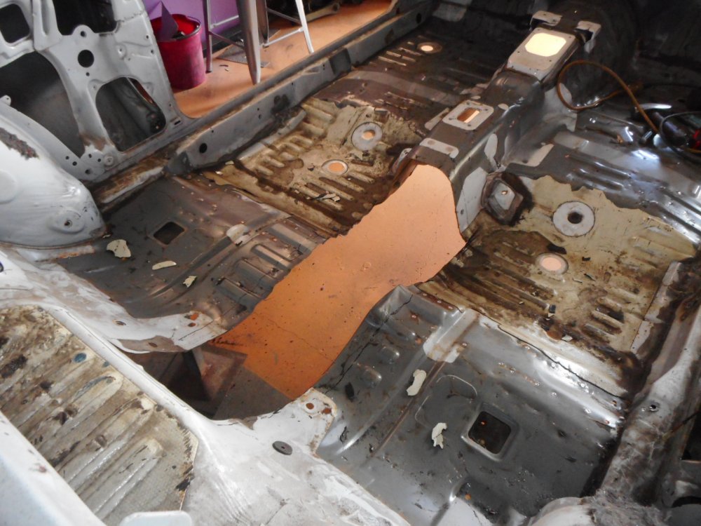

TA64 Posted April 6, 2020 Report Posted April 6, 2020 Its been a crazy few years, but things have finally settled down enough to really focus on this project. Fitting new flat floors. Quote
altezzaclub Posted April 6, 2020 Report Posted April 6, 2020 Yes! I had this marked out on the old rally car and never got around to doing it. I was thinking about it yesterday for the new build, but I don't have the press for the ribs. Those low floor areas take such a hammering. Quote

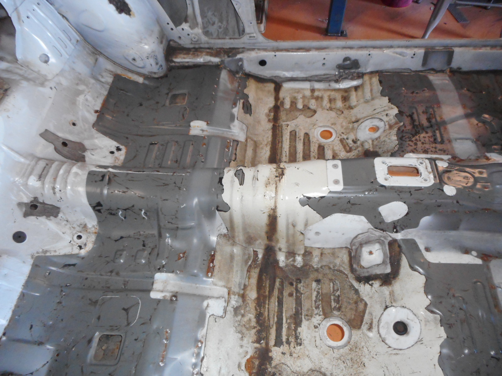

TA64 Posted April 7, 2020 Report Posted April 7, 2020 Yes, its a handy tool if you plan to use it a lot. Full length chassis rails going in. Quote

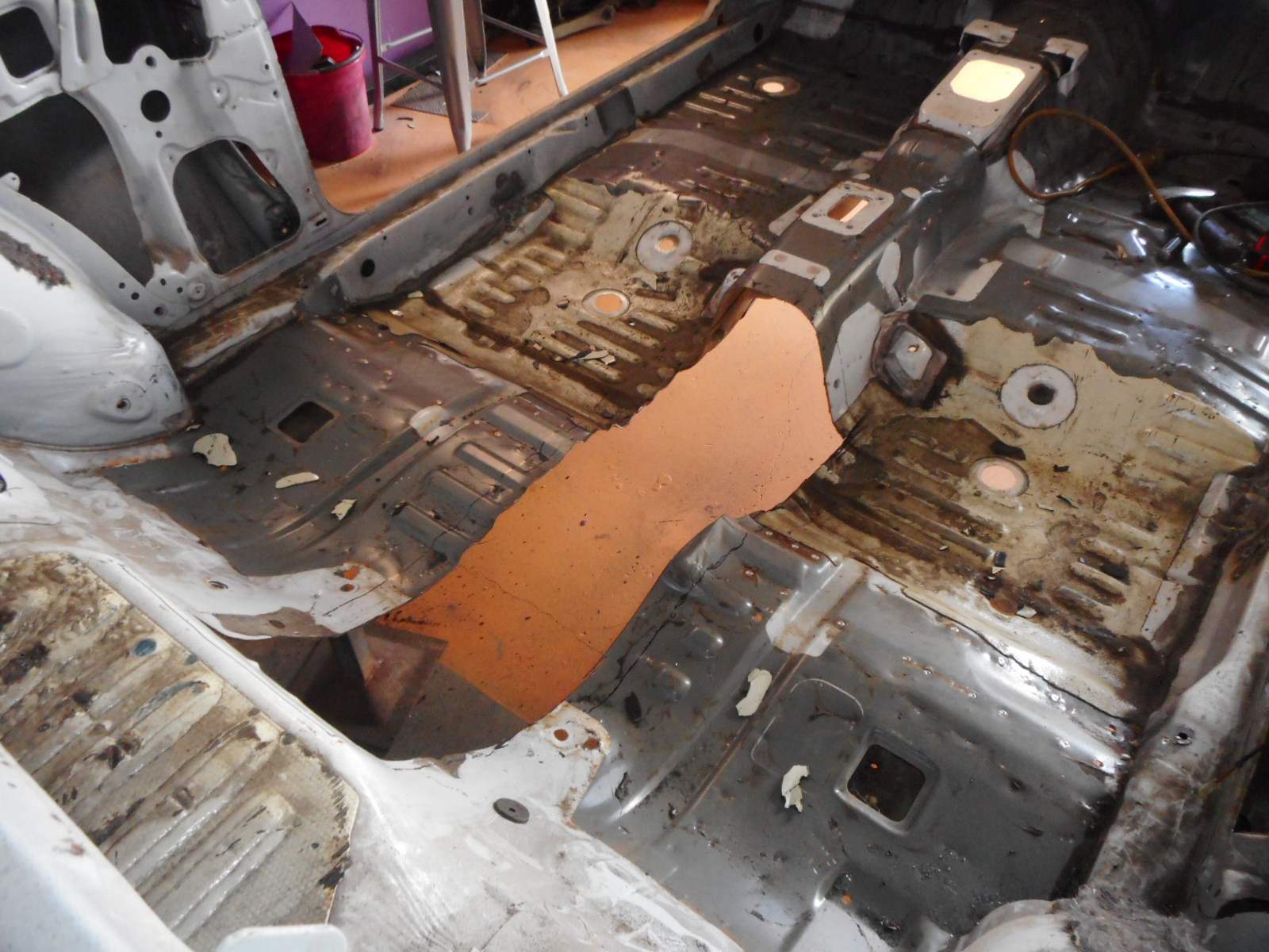

TA64 Posted April 10, 2020 Report Posted April 10, 2020 Photos showing the new big rear wheel arches going in. Quote
