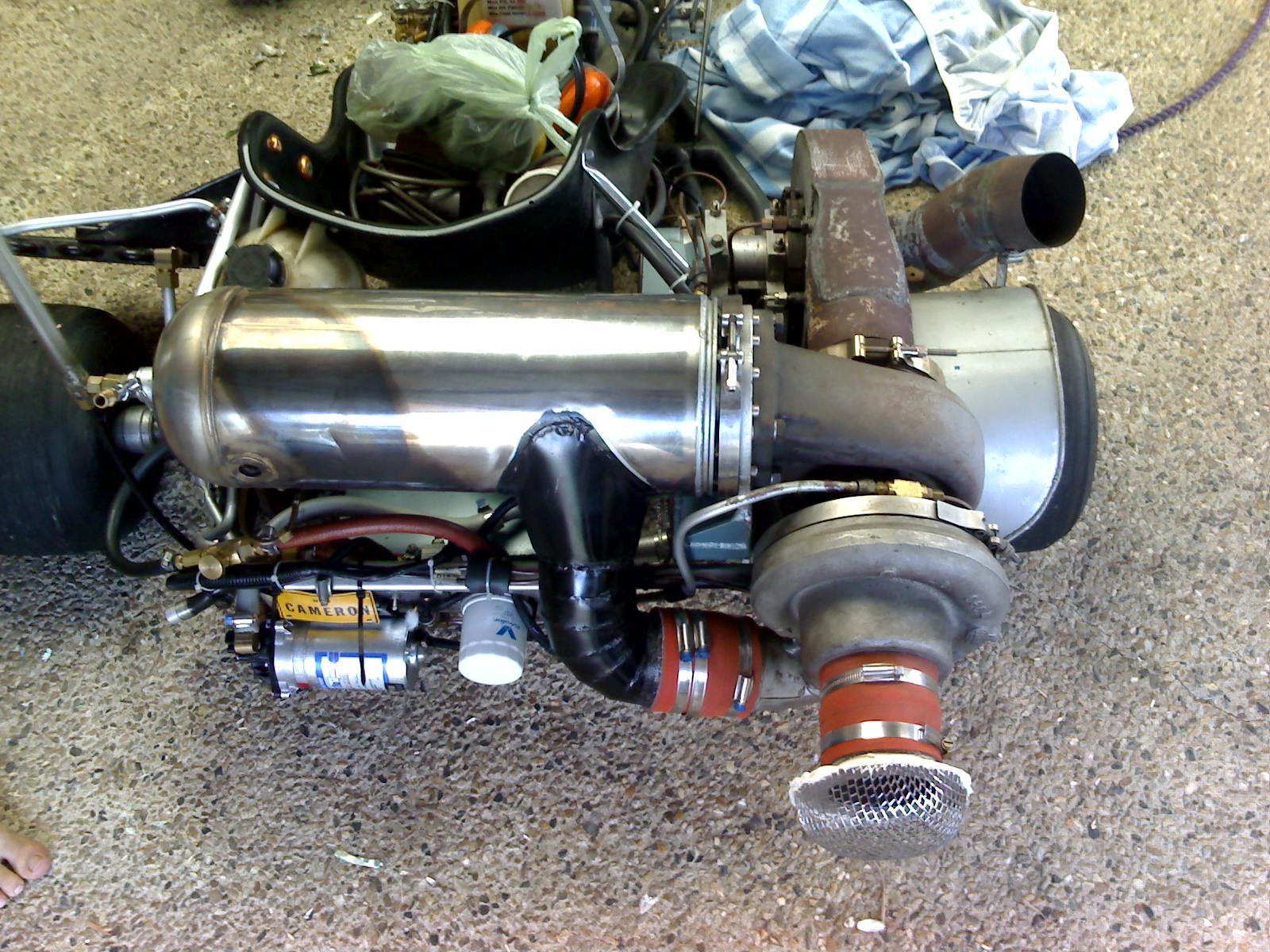

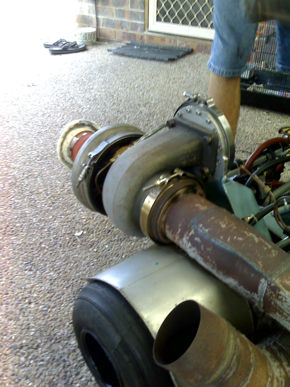

Pretty much i turn on the master switch for everything then I turn on the oil pump. Once I have oil pressure the fuel pump comes on automaticly. Once I have all the systems primed I turn on ignition and gas warm for 12 seconds to about 400 degrees C then turn leaf blower on and as I slowly open the fuel metering valve I turn the leaf blower up slowly. And in about another 5 seconds I should go from 0 to 30,000RPM.
But a few times the start has "hung" where fuel is burning but it just doesnt spool but when it does RUN (Even comercial jets get this now and then) they generate a bit to much power..lol. But last time this happened so much fuel was burning in the jet it spooled up so fast rear wheels started spinning and it lifted off the ground from the instant increase in rotating force in the engine. So it can be hard. Starting is always the worst part if it goes good well engine should run well.
But last time too_quick saw it I was doing arebuild from a "out of temperater run"..lol I melted the stainless steel fuel manifold (well more the weld and mounts etc) so I was redesigning and also going to find a better finish for the drive turbine houseing as well paint burns and it mild steel for testing so rust to. But it is slowly coming along. Should be track ready again by the end of December :hmm:
But I run it on straight kero (jet fuel) but can burn any fuel if slightly re-tuned for it eg deep fryer oil.
I have a video here of it on a hung start jumping off the ground before I tuned it to make more power Ill try to compress it and get it some where for you to see ti run.

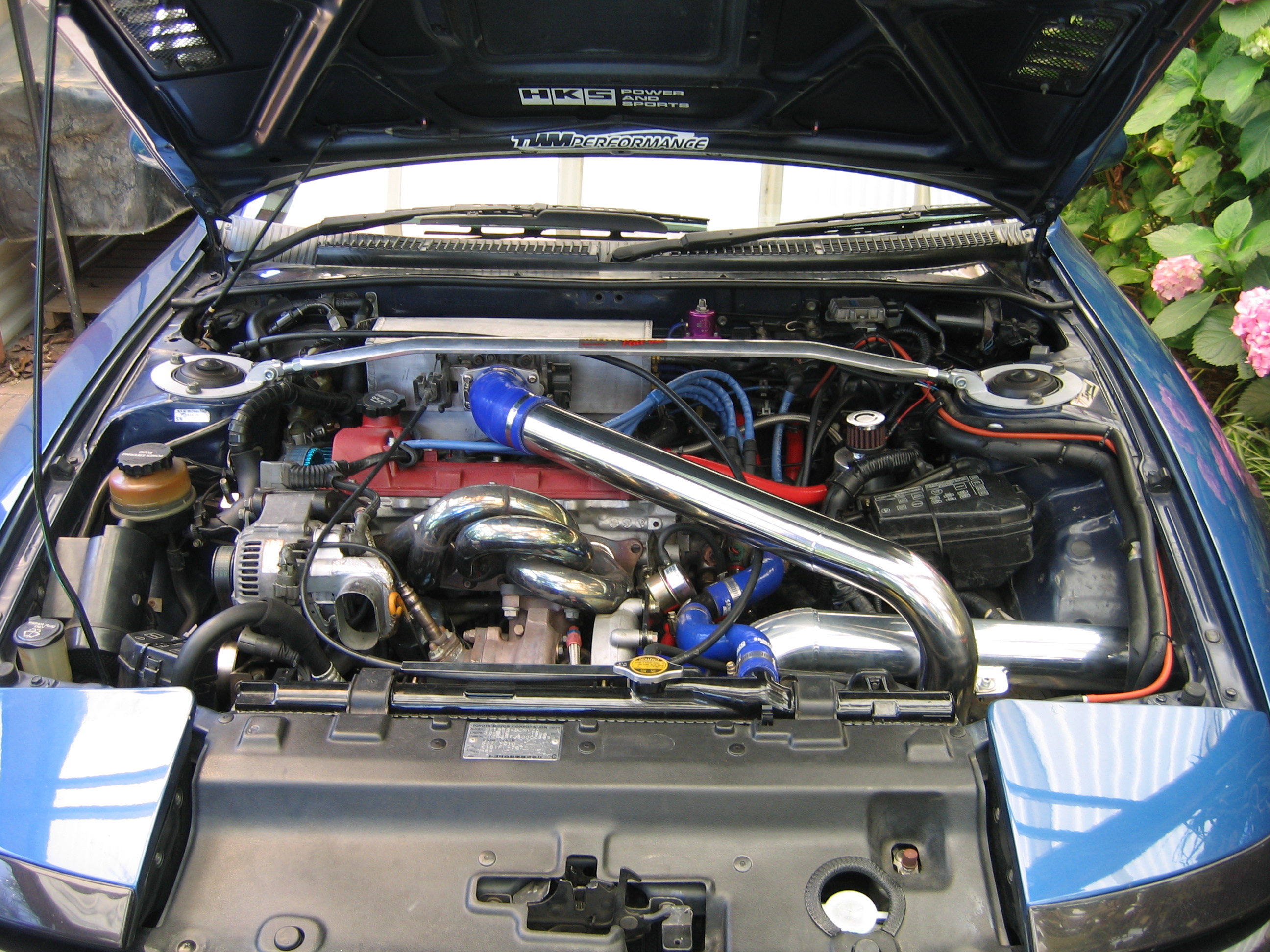

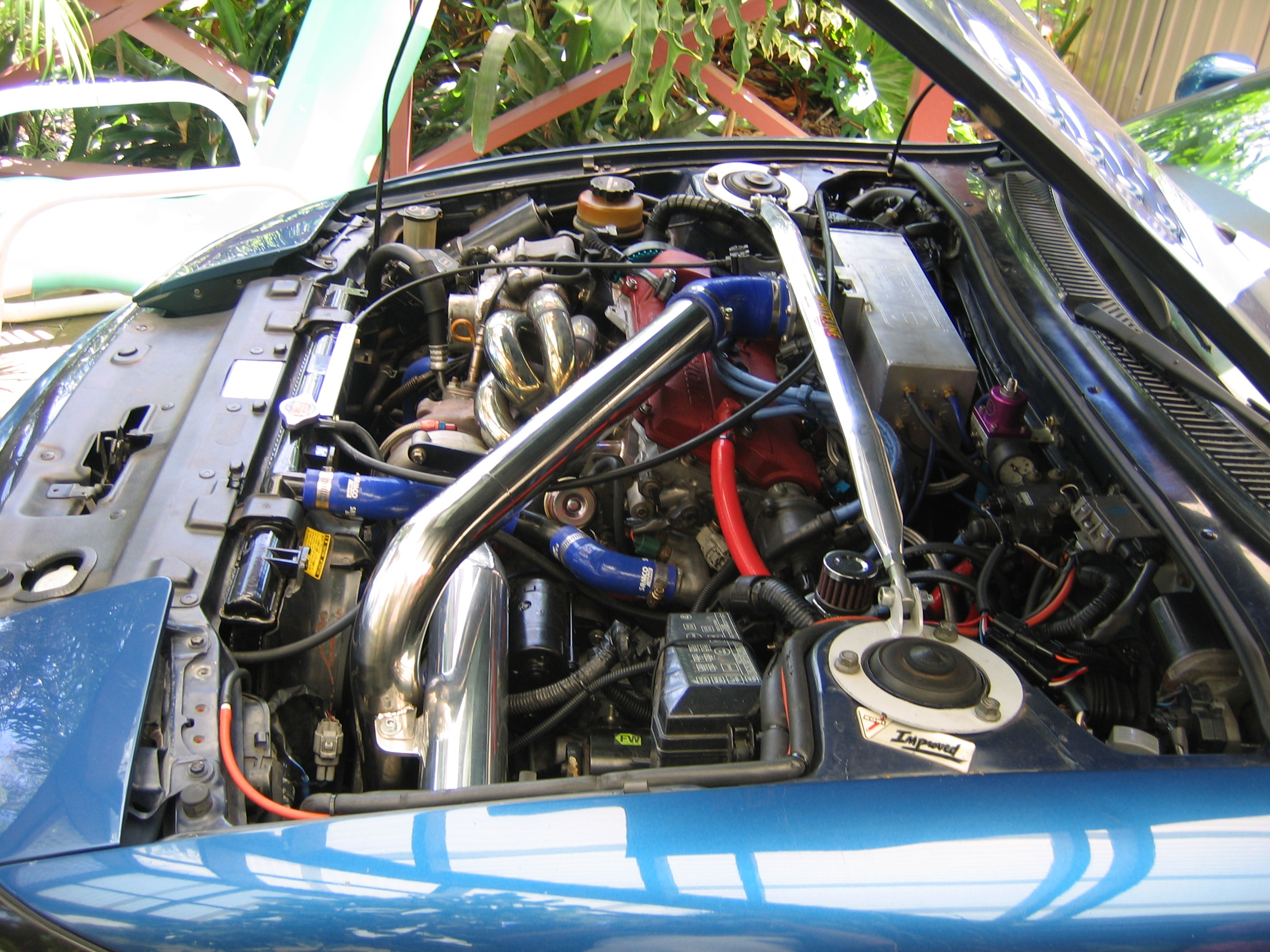

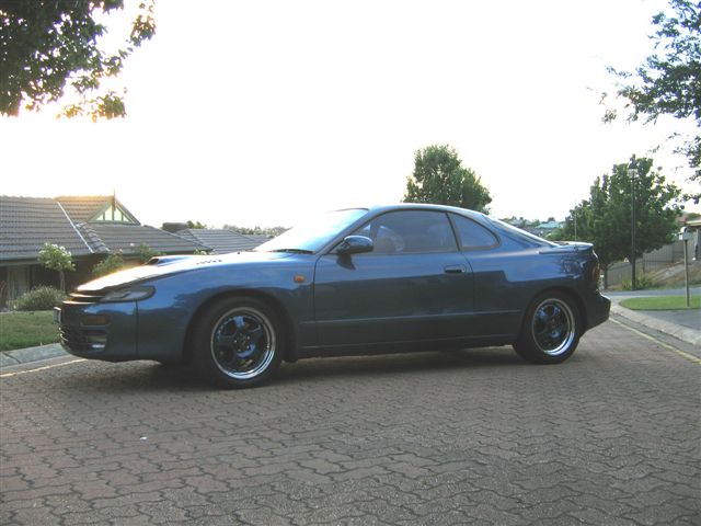

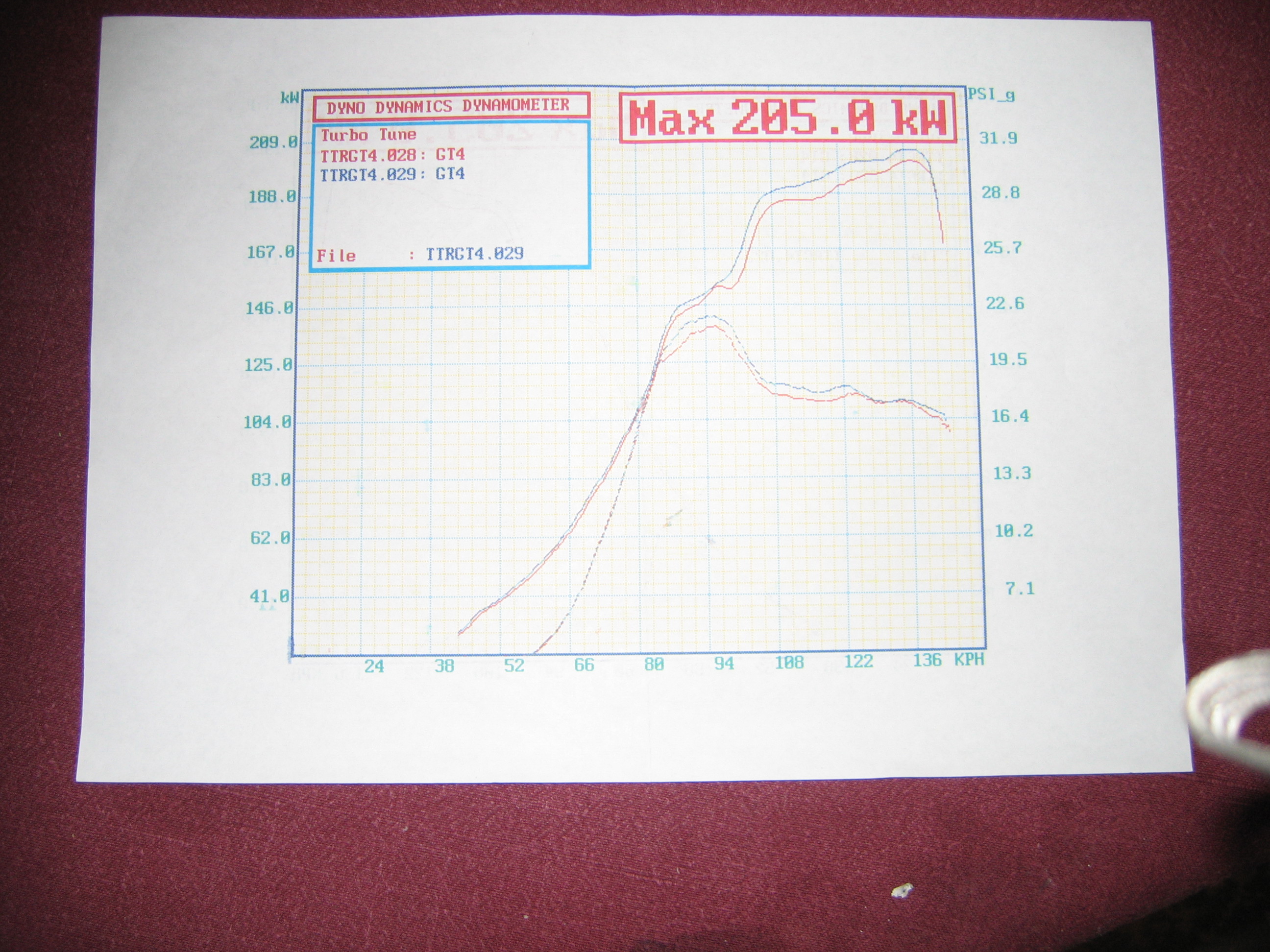

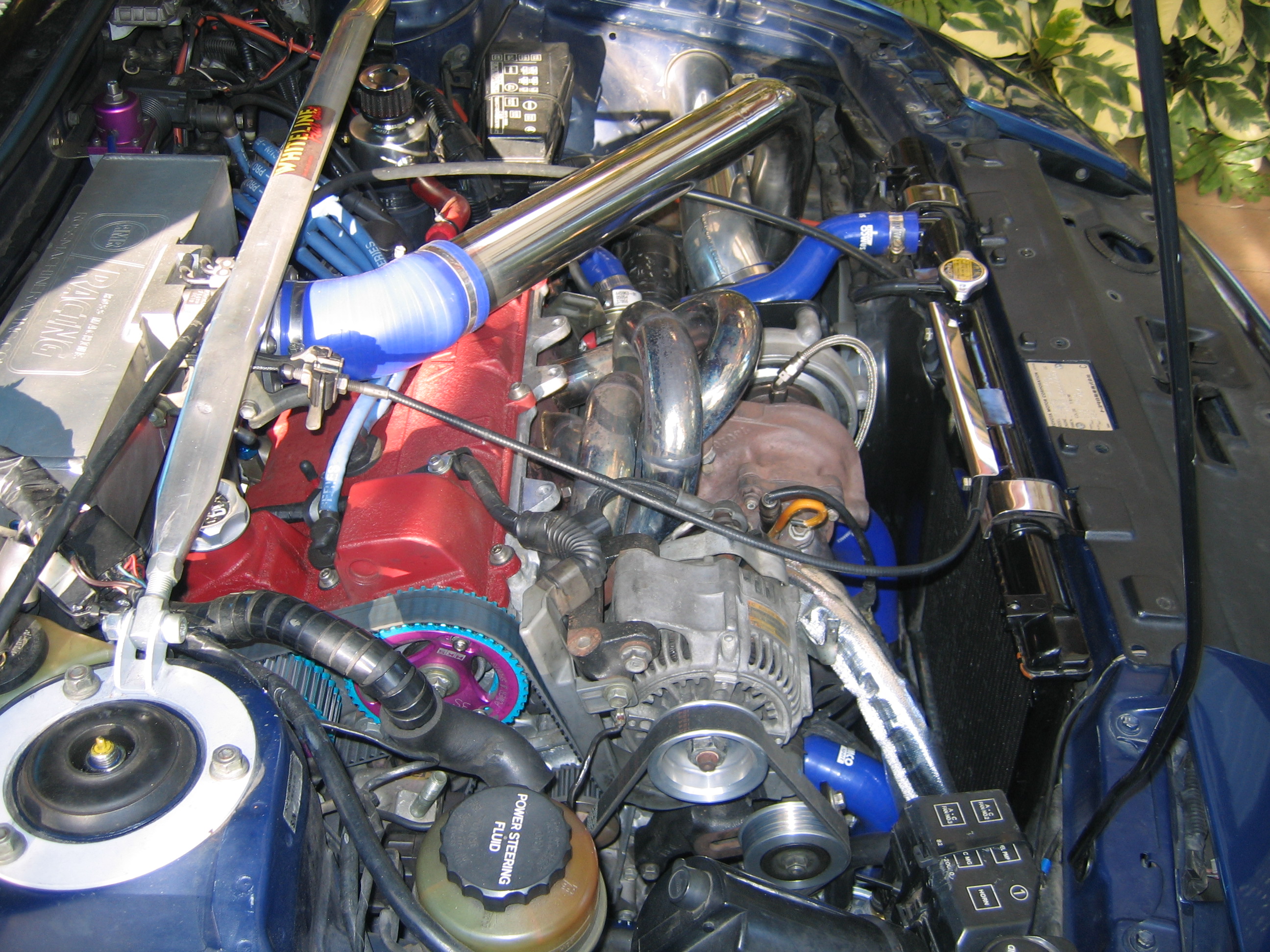

post-1769-1174055050_thumb.jpg :P this thread needs life ...meet my GT4 1990 ST185R aussie delivered 205 AWKW @ 8000 rpm on a hybrid CT26/GT30R turbo ,264o cams ,550cc inj & link plus ECU ,i have a list if you would like i can post it up ... car was busted badly for mods & i have taken it off the road to make a dedicated track car . its in bits at the mo & will be up & running April new mods include a externaly gated GT35R turbo ,800cc inj. open exhaust & a cusco front lower brace, its made 245 kmph , & was pretty quick over 400 mtrs & has bettered a known 13 sec WRX . ok i'll post up the new look with stripped out interior & uber mods when its done in about a month . cheers dave
post-1769-1174091258.jpga few more pics , gt35r fitted just !post-1769-1174090928_thumb.jpg[Originally Posted by ToDa30/4
had the GT4 6 years ,started off with the usual mods we all do and got carried away,motor built by Chris Miltons in Adelaide ,fabrication ,install & dramas sorted by Mark Mills of MADAZ Motorsport ( Top Guy ) and myself

Ok thats about it plans are I'm stripping the car out to get as light as i can, will be using the car for ANDRA sports compact Sports AWD class , run it at mallala & the collingrove hill climb, i had to put the project aside but am now back into it ready for the track april 07attachment=13251:Picture_128.jpg]
