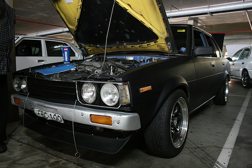

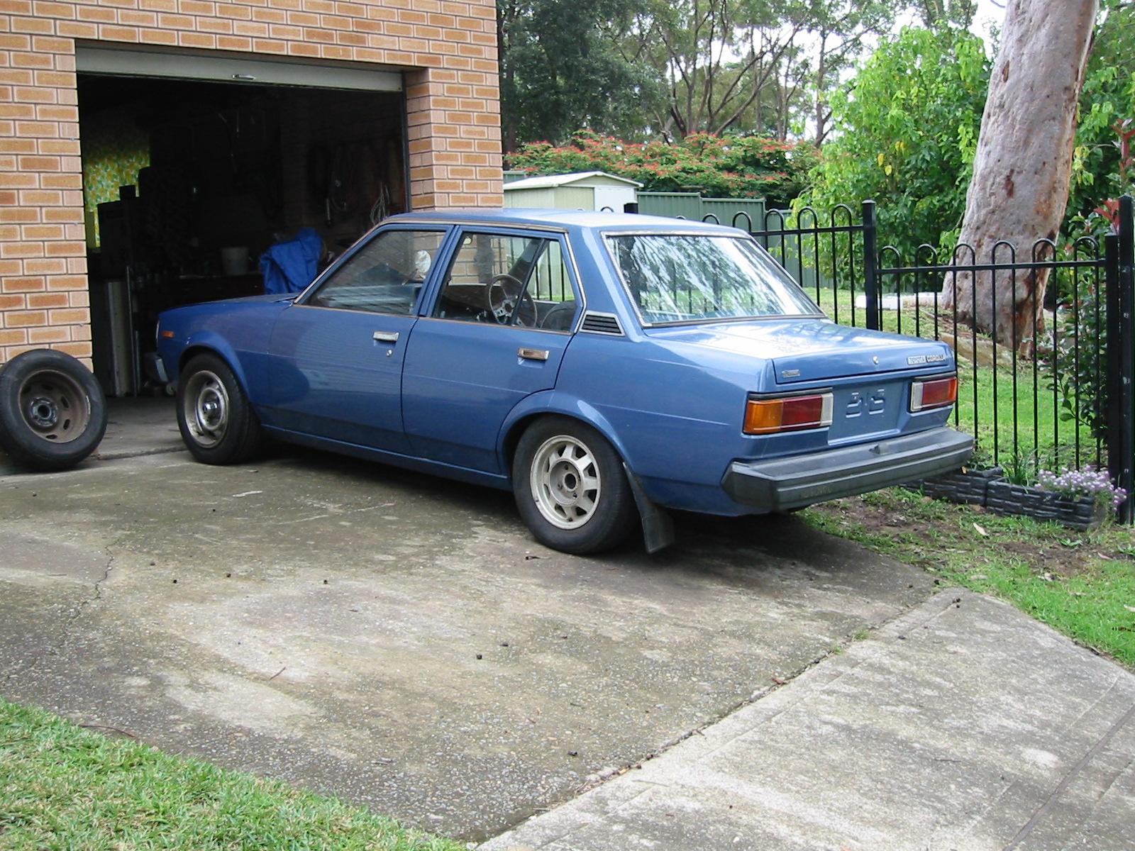

Hi just thought that u may like to see my rolla
KE70
Engine: N/A vvti SR20
Driveline: S13 Silvia box RA60 T series diff
Suspension: Hieght adjustable front & rear with 350lb springs at the front and 200lb springs at the rear with 200sx coilovers, noltec bushes, sprinter sway bars
Brakes: celica drums rear, hilux 4 spots front, MA61 supra master on modified KE70 booster
wheels: 15"x7" Konig rewinds

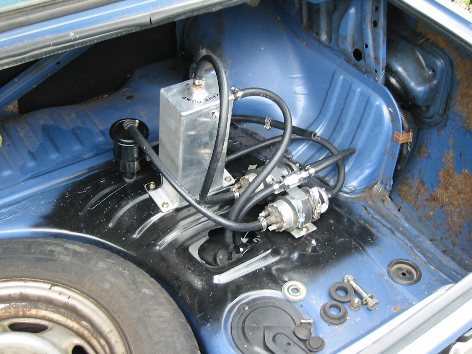

Fuel: twin VL pumps, 1.5L surge tank, VL in tank pump, 5/16 steel fuel lines
Other: ST165 radiator, RA65 celica seats, modified T-18 bumpers

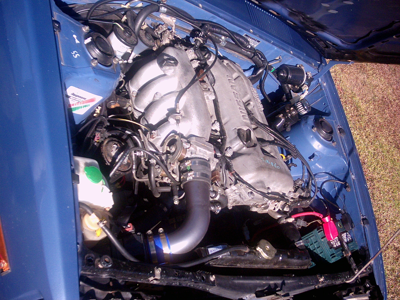

engine

fuel system

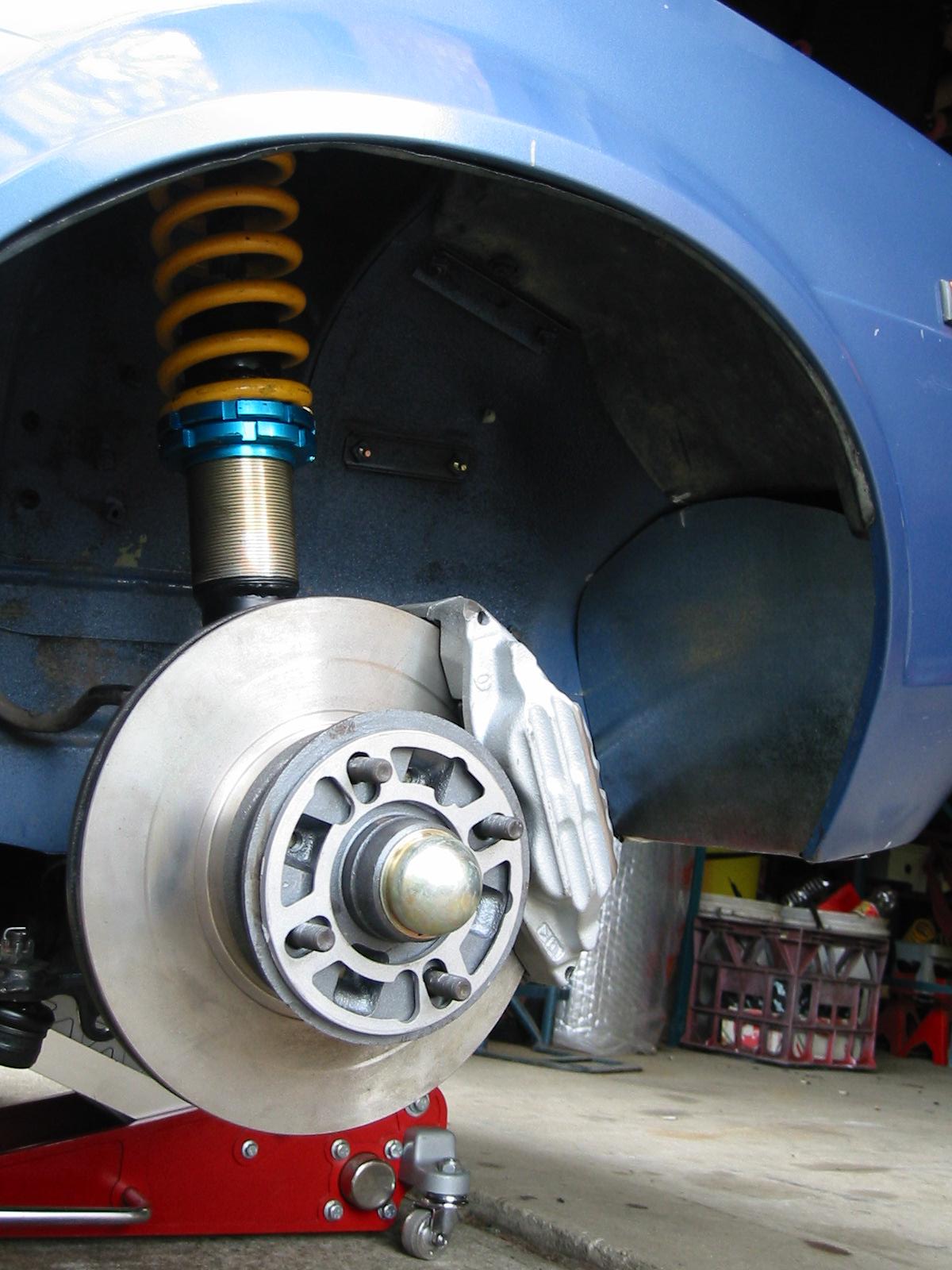

coilovers

nice work dude. Very nice witht the coilovers keep us all posted! :)

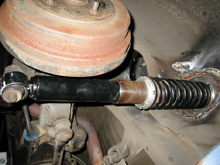

coilovers

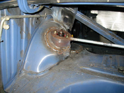

I don't know how good they are coz i havent driven on them yet, tomorrow i gotta finish the firewall in the boot and set the heights then I'll take a few pics and post em.

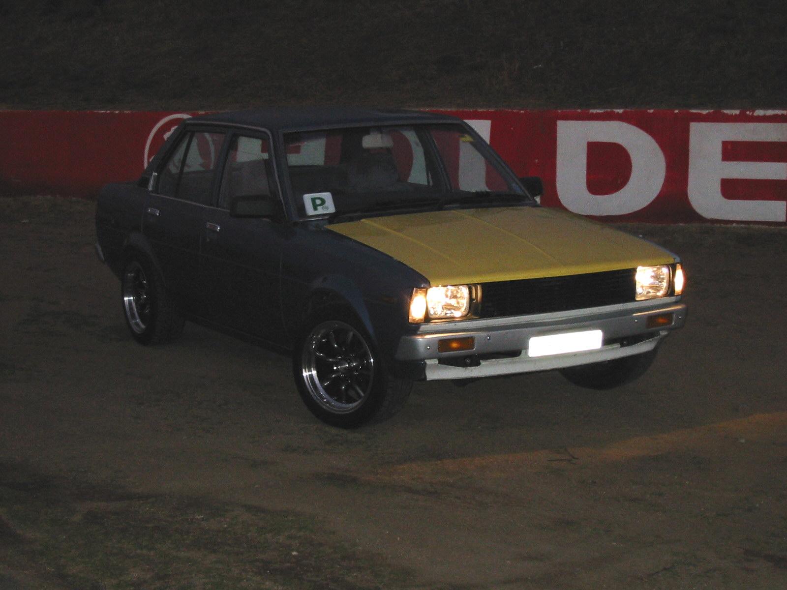

I took that pic late last nite by the way, the inner gaurd and boot are now painted.

took some pics on the mountain this arvo, ride is soooo much better with coilovers, handles better, is smoother, quieter etc

took it for a decent run about an hour ago, its better than before but the rear dampers are stuffed, so I'm gonna put some decent coilovers and springs in when i get some money, hopefully ohlins dampers & lovells springs

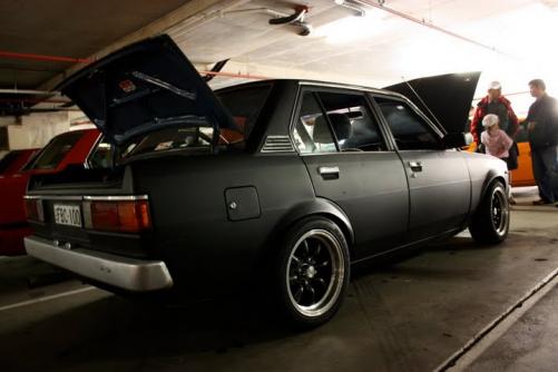

is it just me or do i see T-18 Bumpers?????? cause they look much like them, and i always wondered if they fitted nicely on them
Cheers Sean
they are, but they don't fit at all, if you look close you can c that the mounting bolts on the rear are different.
other than that the curve of the rear bar is a little off and the ends are completely different (an exercise that took about a week to get right) the front bar is about half an inch to long and again the ends are all wrong. The front mounts need to be modified and the rear needed new mounts fabricated from scratch.
so yeah they fit, but how badly do u want chrome bumpers on a KE70...
and u better be good with a welder and grinder or know someone who is...
