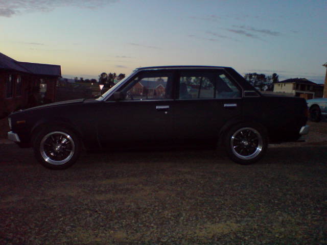

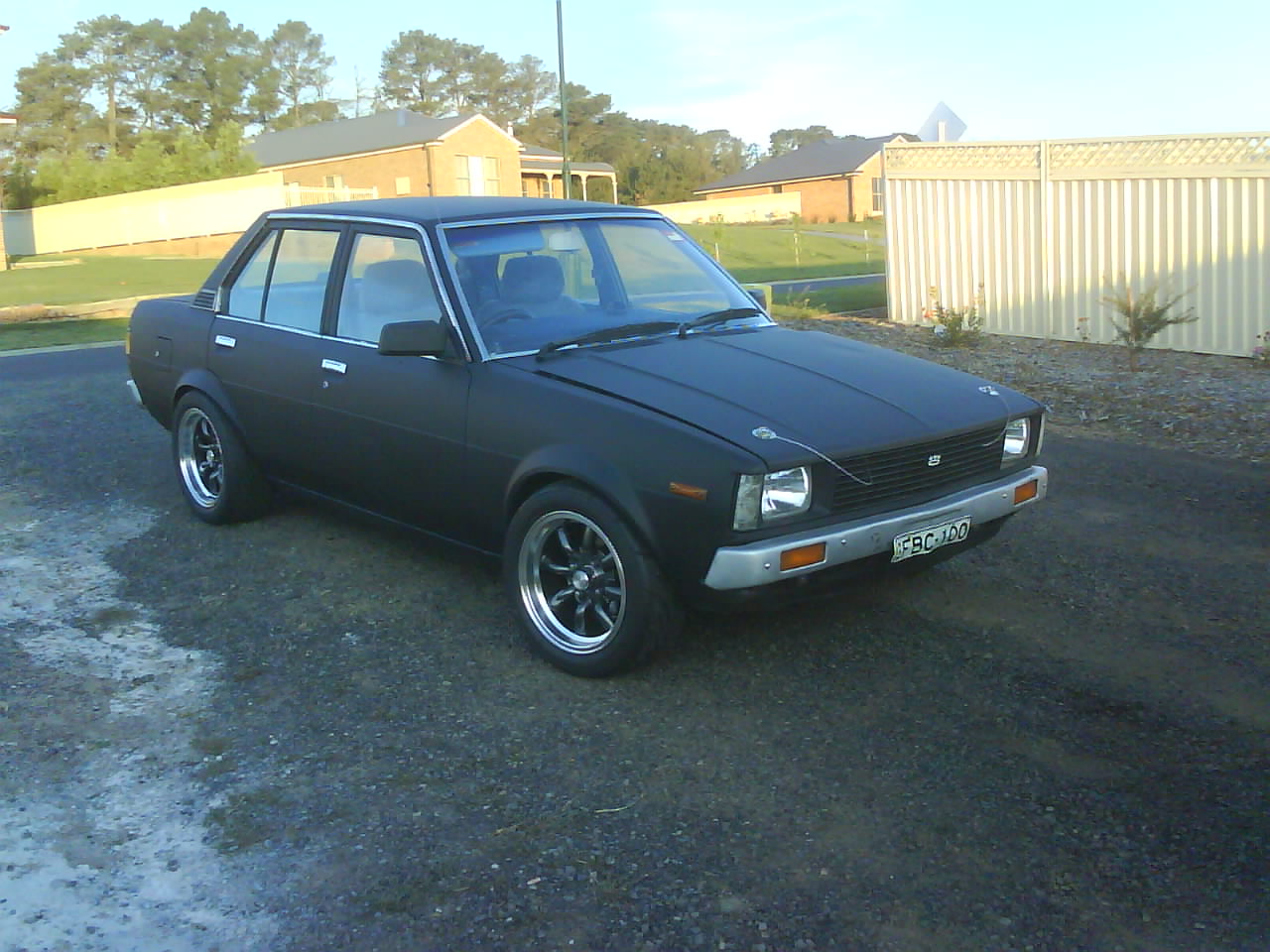

::UPDATES::
I figured i'd better update my pics so they work :yes: and add a few new ones, the cars all the same colour now and ive got some jdm headlights coming and hopefully a front lip if my pm gets replied to, goin out today to find out about some tein bits and to maybe buy a KE70 van, pics
i really like that last pic, livin in penrith now asweel, i just visit bathurst

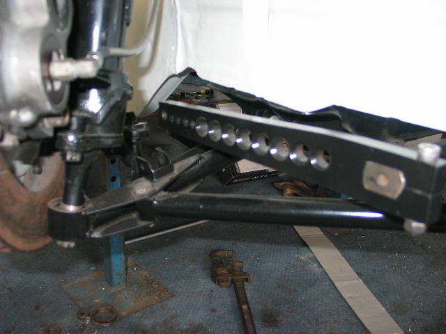

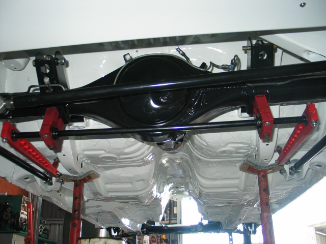

a few more detailed coilover pics, all this stuff is pretty and welded properly/painted now

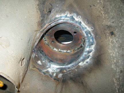

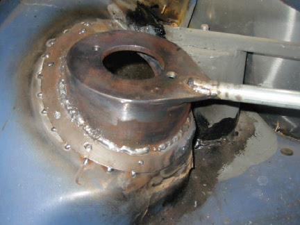

this is what i want to do next, sort of :)
i want to copy this setup but put equal length rear four link bars, a watts linkage setup, and a little different with the front struts but this is the general idea :P
