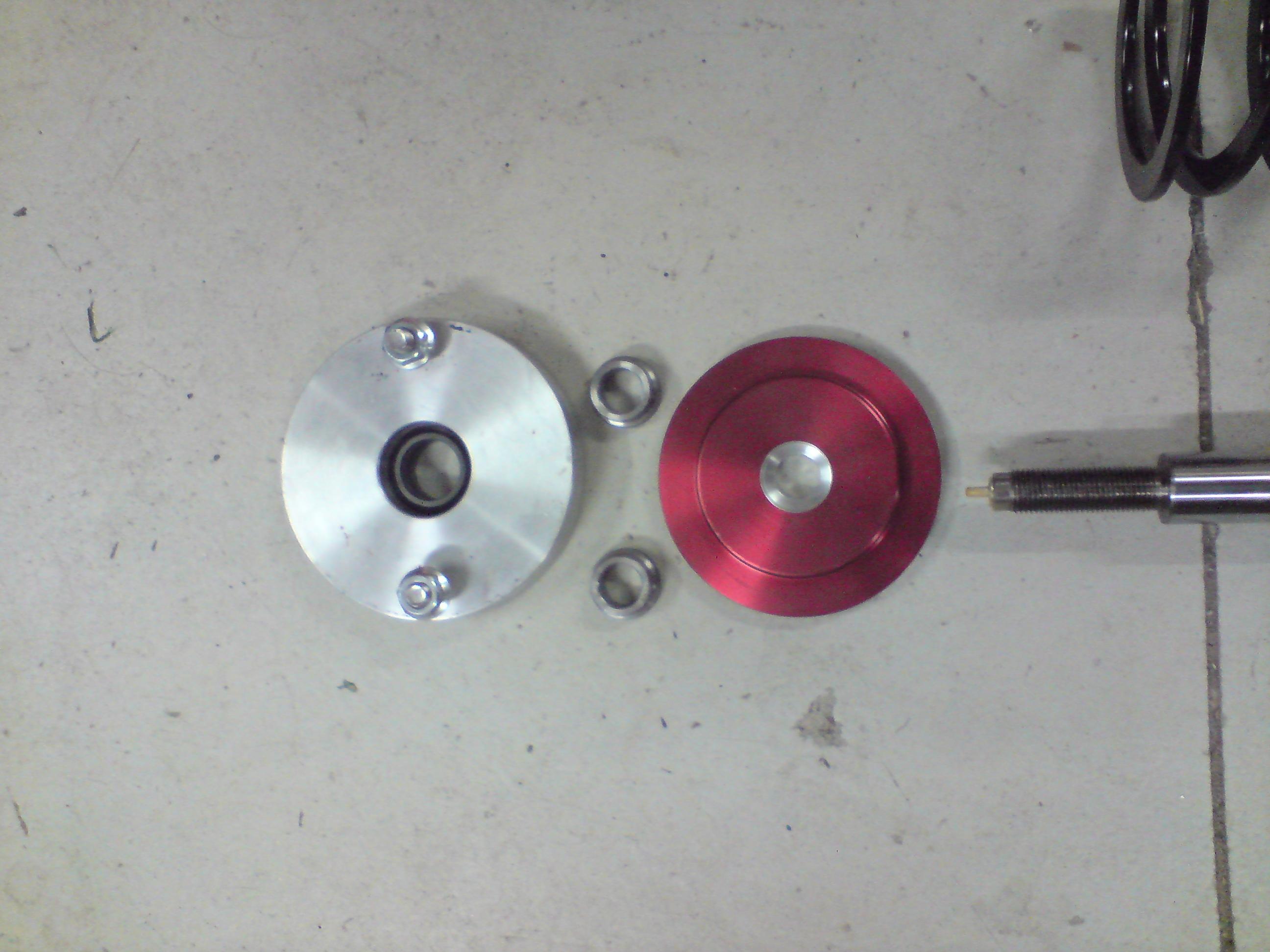

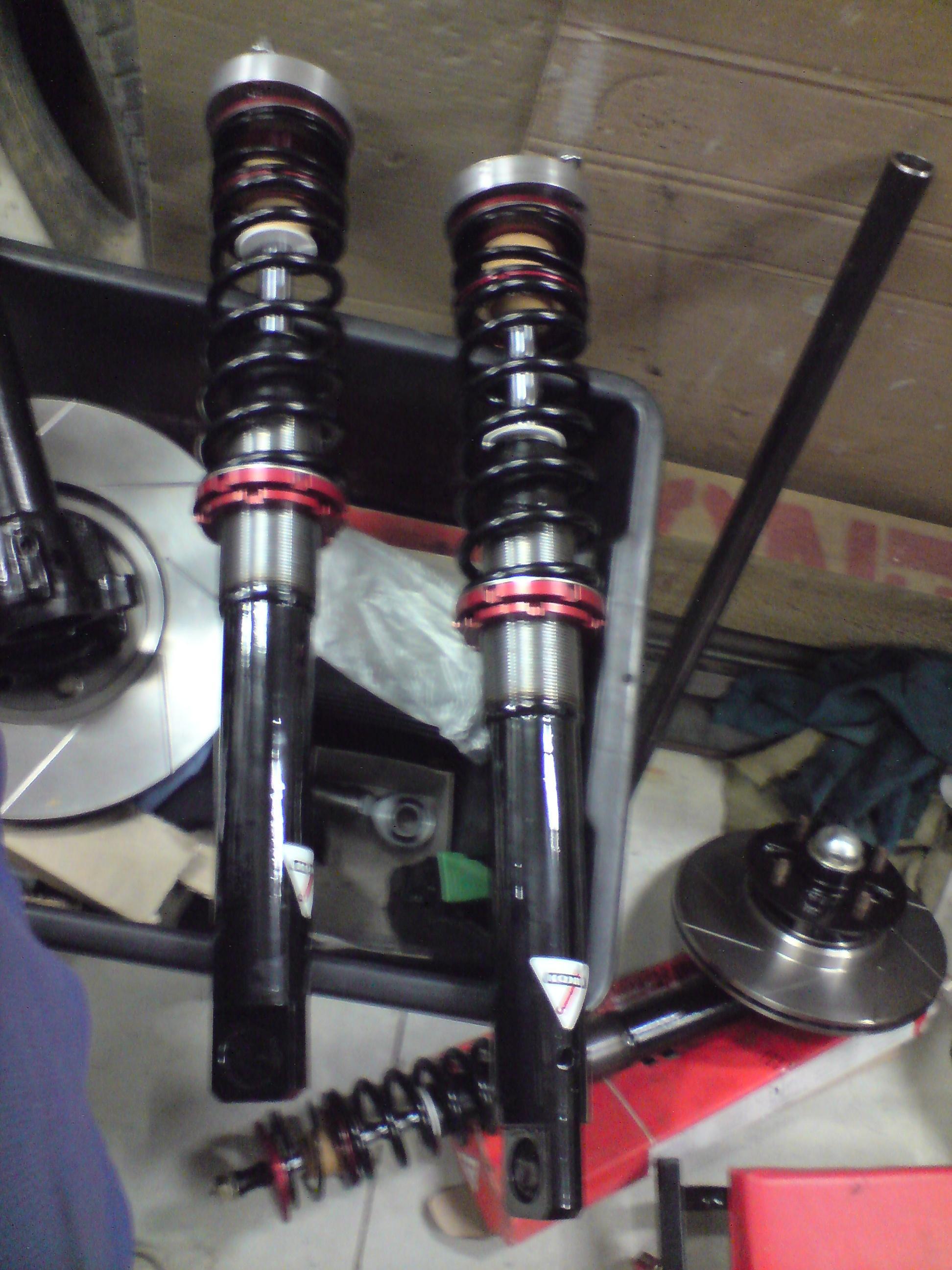

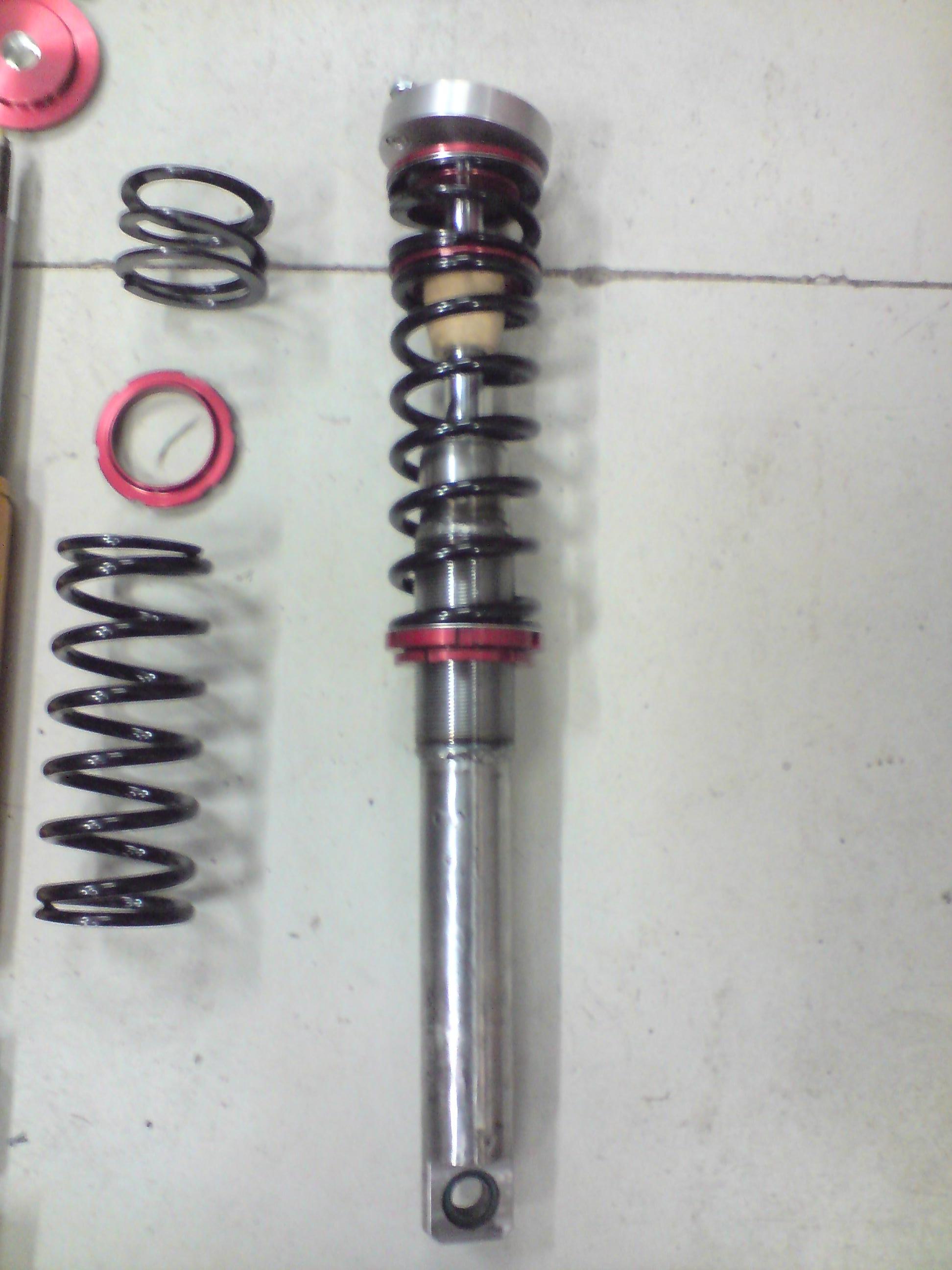

Ok, i've been busy assembling everything for trial fitting and the like and ive set all the hieghts and whatnot. Here are some pics of what ive been up to.

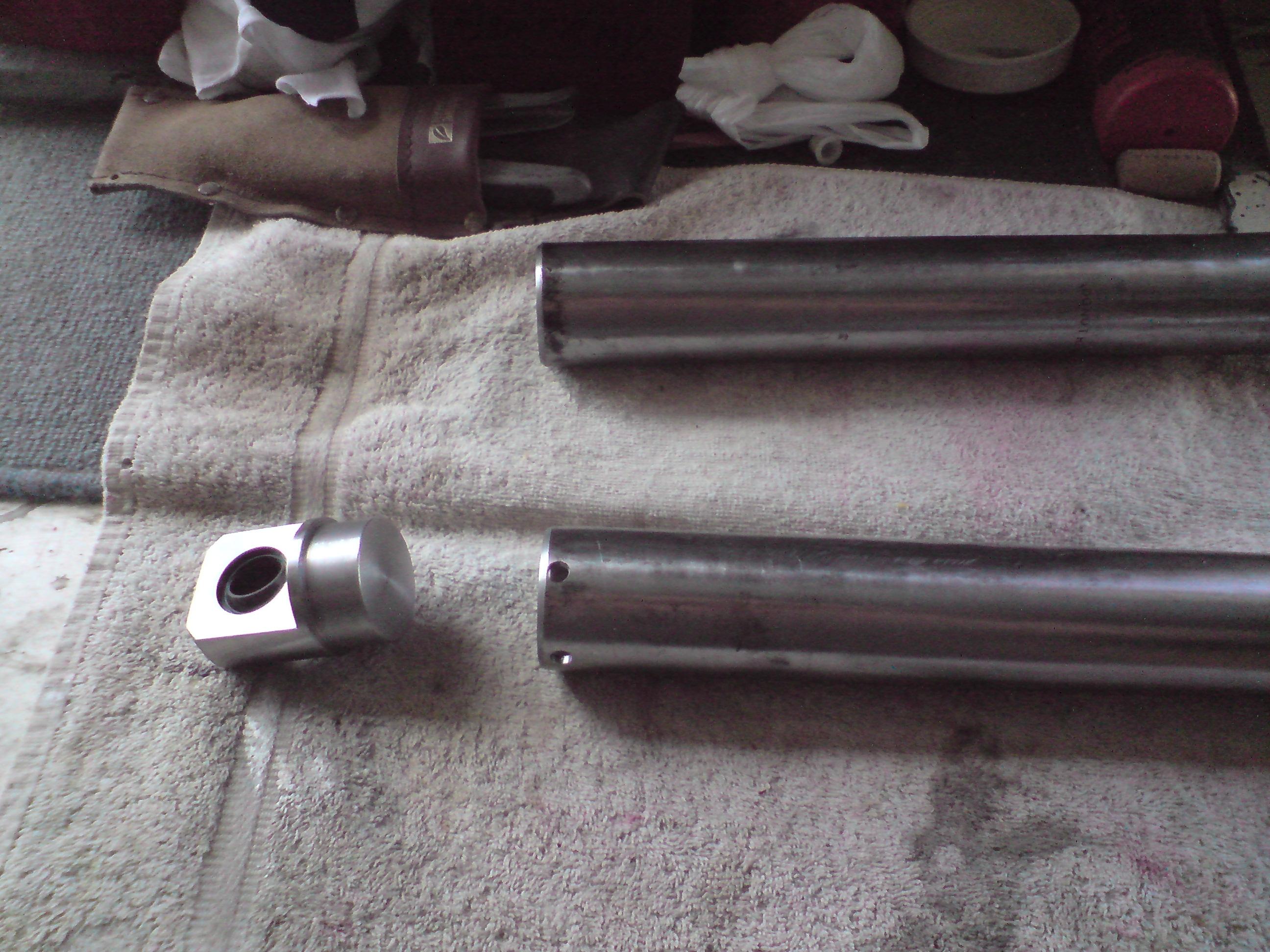

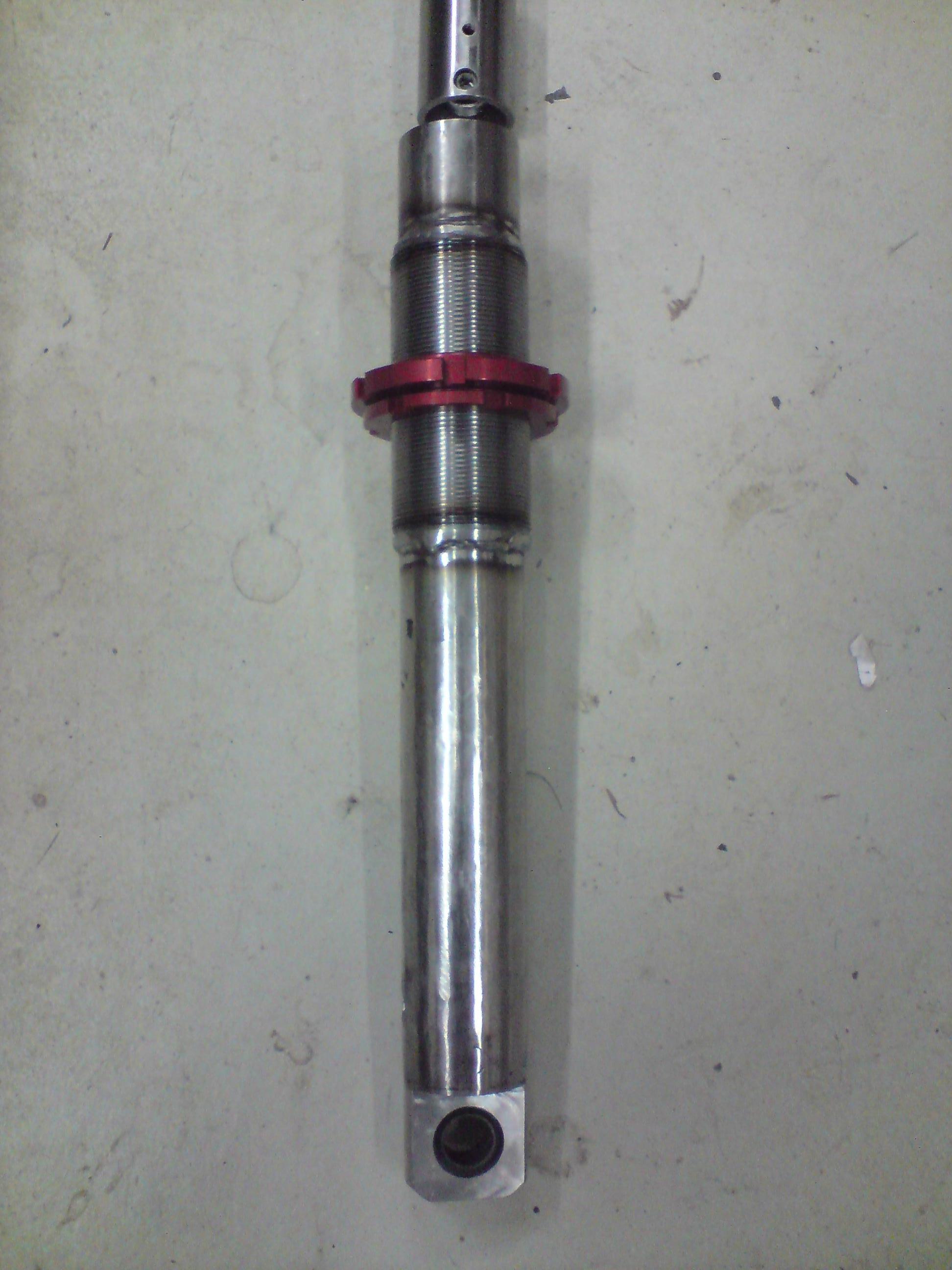

these first 2 are the welded and unwelded versions of the rear tubes

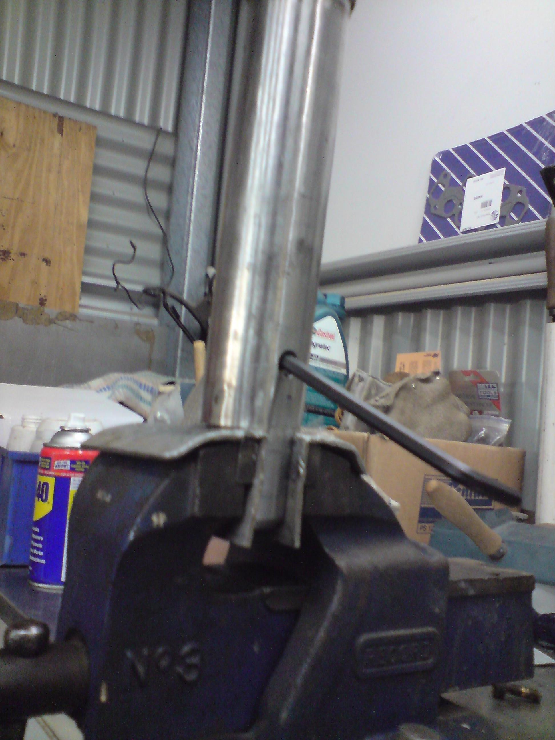

the first pic here shows how the adjustment thing i made up works when everything is assembled, if that allen key is turned it adjusts the bottom (bump) adjuster, and the last pic shows the machined rear strut top components

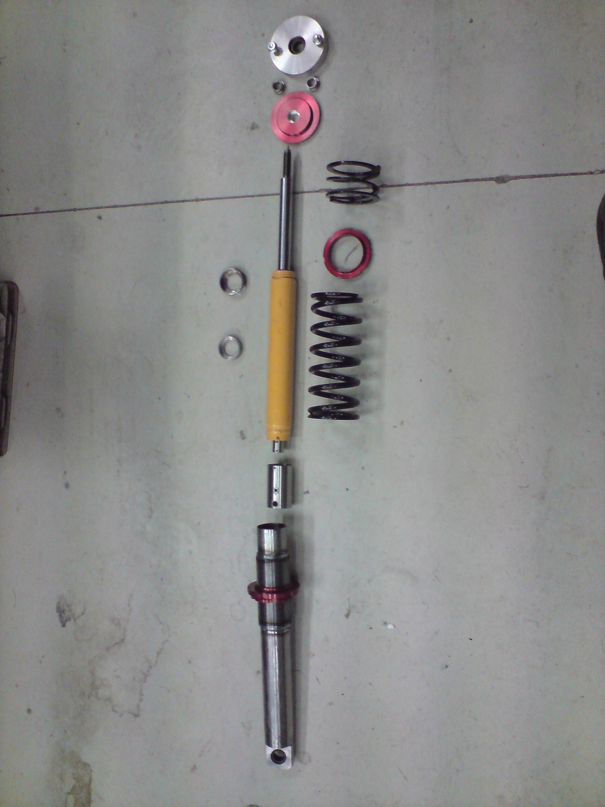

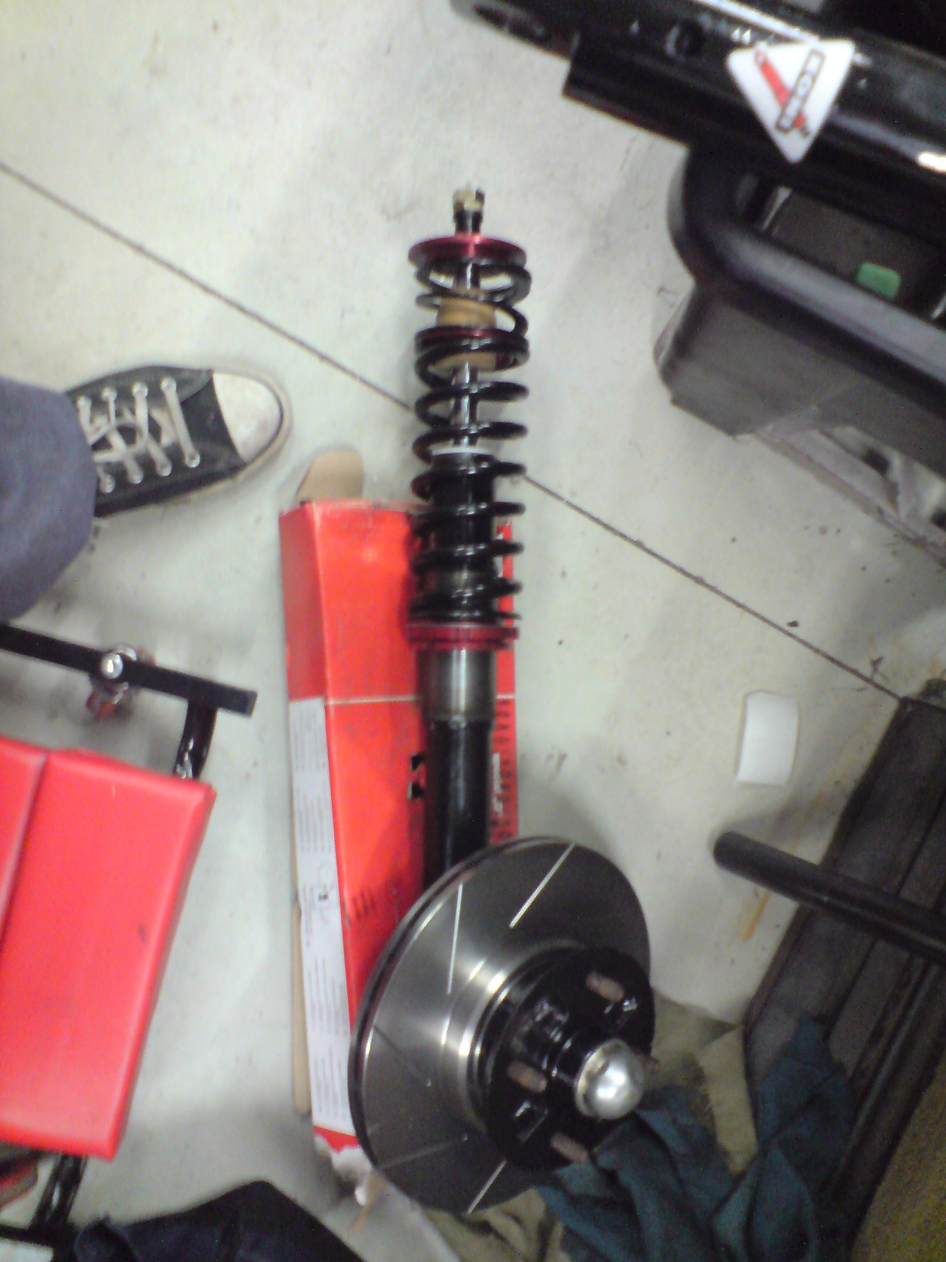

These are exploded and assembled views of the rear coilovers and all the bits i made, almost seems a shame to paint them

hell yeah that is some very trick sus :D
i like, top work mate
I second that! Top work on the suspension. How do you mean polish your car with WD40?!

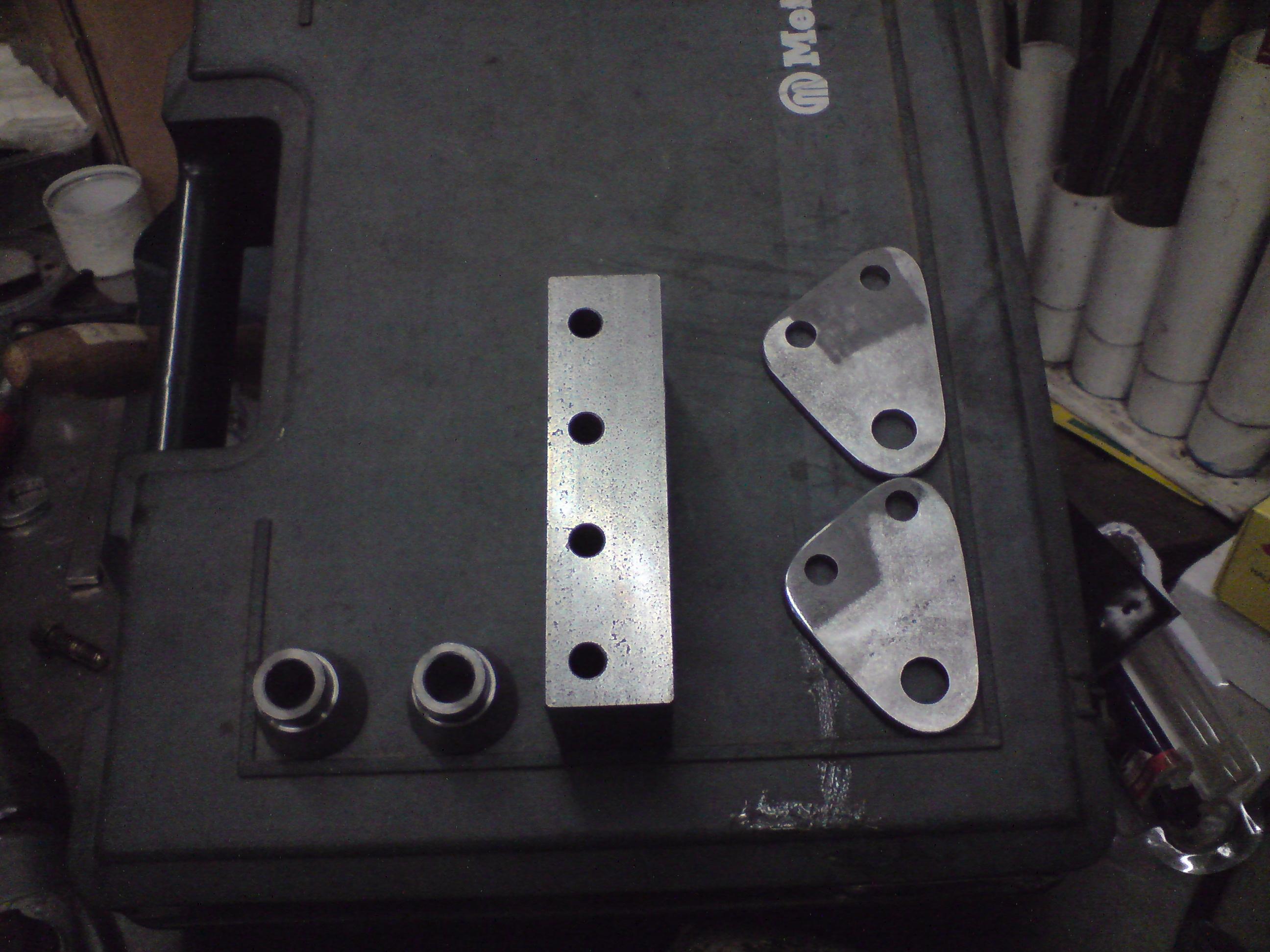

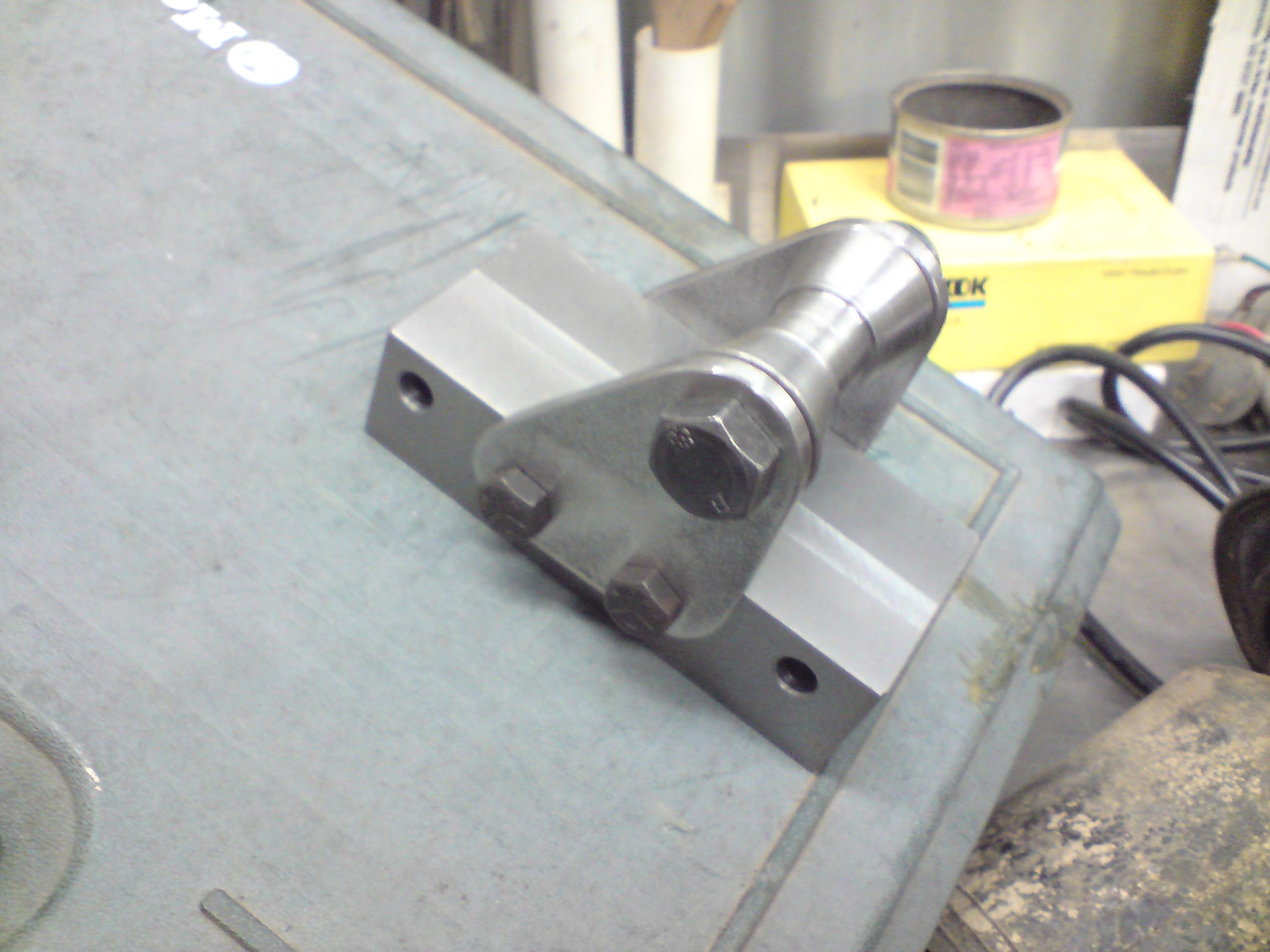

I made up the last little bits today, the paint is drying on them as I type this. The rear lower suspension mounts are done, all thats left now is to assemble everything when my painter friend gives me my struts back, weld the lower rear mounts into the car and install everything.
Lower rear mount pics, Assembled:
Disassembled:
