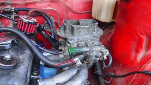

  18. rito so i pulled it all off last night. Gave the carby a clean and set the float. It was pretty much spot on anyway. Need to get another manifold gasket as i tore it taking it off Grrr. its stuck to the exhaust pretty hardcore even tho it was only sitting on for a week. The fuel did look pretty crappy and the tank is really low, so its probably sucking in some crap from the tank. Would it be worth doing a full drain of the tank or just top up with clean fuel? Have to wait now anyway to get a new manifold gasket. Will be couple weeks as ive got few things on the next couple of weekends
  19. Ill pull it off again, check all gaskets again and clean out the carb and reset float while I'm there was hoping to drive it to exhaust shop :ninja: to save towing/car trailer hire so was trying to sort it out first (its not that far) but ill see how it is after i take it all off and put back on again. if its still no good ill get the exhaust done before going any further.
  20. unsure of what type i scavenged it off another corolla and no i don't have a regulator. It worked on standard with no issues and the standard had no return line. Is the job of the float to close off the fuel inlet when it reaches the desired level? after i had it running i pulled the top of the carby off and the fuel bowl wasnt overflowing or anything, from memory it was about half full which seemed to be ok?
  21. Have not adjusted float level. How is that done? I can't find any leaks
  22. How much effect do main and air jets have at idle? It seems to rev ok but the idle just keeps surging

  24. Hello, I posted this in my rides thread but ill put it here too, I have recently put a weber 32/36 on my 4k and fitted extractors at the same time. The carby came off a 18RG? i think. I can't get it to idle stable. It seems to be very rich at idle. Have attempted to tune according to basic settings and will continue to surge at idle and when backed off from accelerating will drop and nearly stall. I have checked: 1/ Ignition timing - 10BTDC at idle and advance is working on acceleration. 2/ used starter spray to check for air leaks, couldnt find any. when i replaced it i replaced all gaskets including manifold gasket and used aviation sealant on carby and adaptor plate gaskets 3/ Have checekd jets, it has Primary/Secondary 140/135 mains 160/175 Air 50/55 Idle 4/ it idle very well before carby swap It has an electric fuel pump fitted which worked on standard carby with no problems My questionsn are 1/ Shoud the air jets be larger on the secondary instead of mains? 2/ Do i need a fuel return line, at the moment i have blocked it and i suspect this may be a problem? The red arrow is fuel in The green arrow is blocked fuel return the blue arrow is the vac adavance hose 3/ any other suggestions? Please see youtube video of what it is doing,
