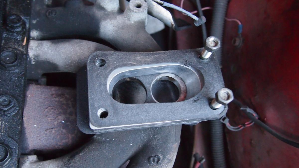

the casting was pretty crap from factory, as i was cleaning up the edges i found all these hollow sections. looked pretty dodgey....- 20 replies

all good did it yesterday. I was in a rush so i didnt get any pics. Used altezzas way to get rid of the bulk of it and i bought a cheap rotary tool to clean it up. Damn genuine Dremmil bit was more than the cheap rotary tool lol. AND IT BROKE at the end so meh.- 20 replies

ok cool. Ill probably be giving it a crack tomorrow see how i go. I'm heading heading up your way next weekend Reed so if i destroy it ill let you know haha. Cheers- 20 replies

sweet. cheers guys sounds good. If i buy one i might use it to port my head then as well. How easy is that to mess up Altezza?- 20 replies

hmmmm not the most patient of men tho. lol- 20 replies

yeah thats the plan. have extractors now, might have to do a sneaky drive to the exhaust shop with nothing past the collector on the extractors :ninja: Cam regrind will be done at the same time as the box later coz ill take the engine/trans out.. from what ive heard doing the cam with engine still in is a prlck- 20 replies

Yeah have extractors ready to go in at the same time and will be doing a cam regrind when i put the 5 speed in. Yeah i was thinking the sale thing about the turbulence but ive heard that in some situations it helps? i don't know how true that is.... May need to get a die grinder as i was planning on using an angle grinder and do it as neat as possible but i spose you can only get so neat with an angle grinder..- 20 replies

Hello Guys, Question on the 4k intake manifold. I'm fitting a weber 32/36 and have an adaptor plate. As i don't know as much about carby stuff i thought id put the question up here. My adaptor plate is an oval shape however the ports (i guess you can call them that) on the manifold where the original carby bolts up is two circles, one smaller than the other. My question is, if i remove the centre of this to make it the same shape as the adaptor plate will this help or hinder air fuel flow? Photos show what i mean. The part shaded in red is what i would be removing. Before After
