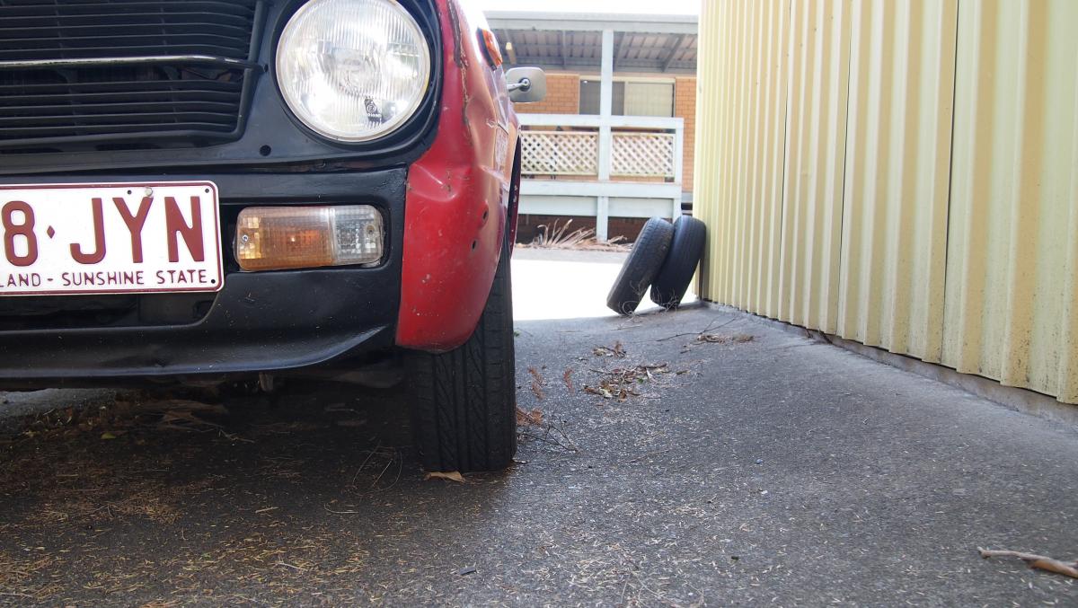

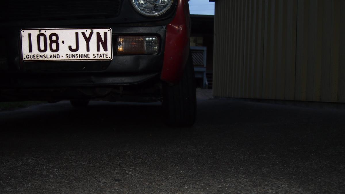

  4. Thats pretty unlucky dude. Do your tyres stick out heaps?
  5. Yeah it pushes forward Plan on making it fun for motorkhanas/khana cross. don't need as much power and still heaps fun :2thumbs:

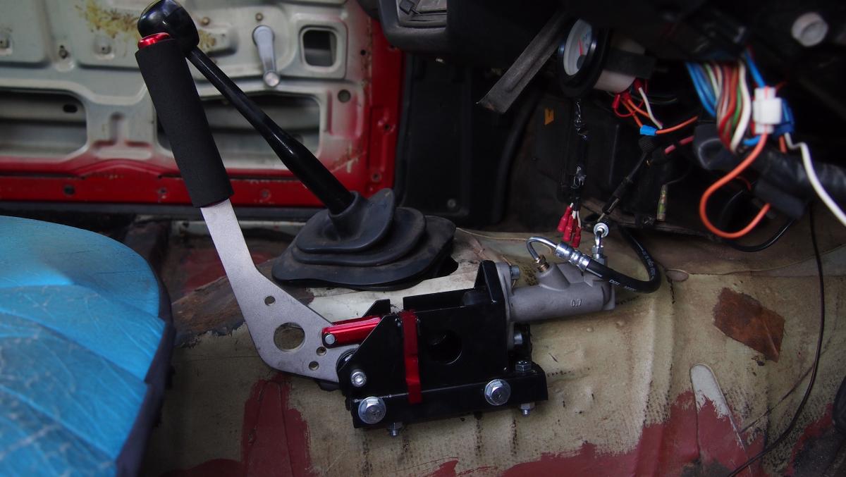

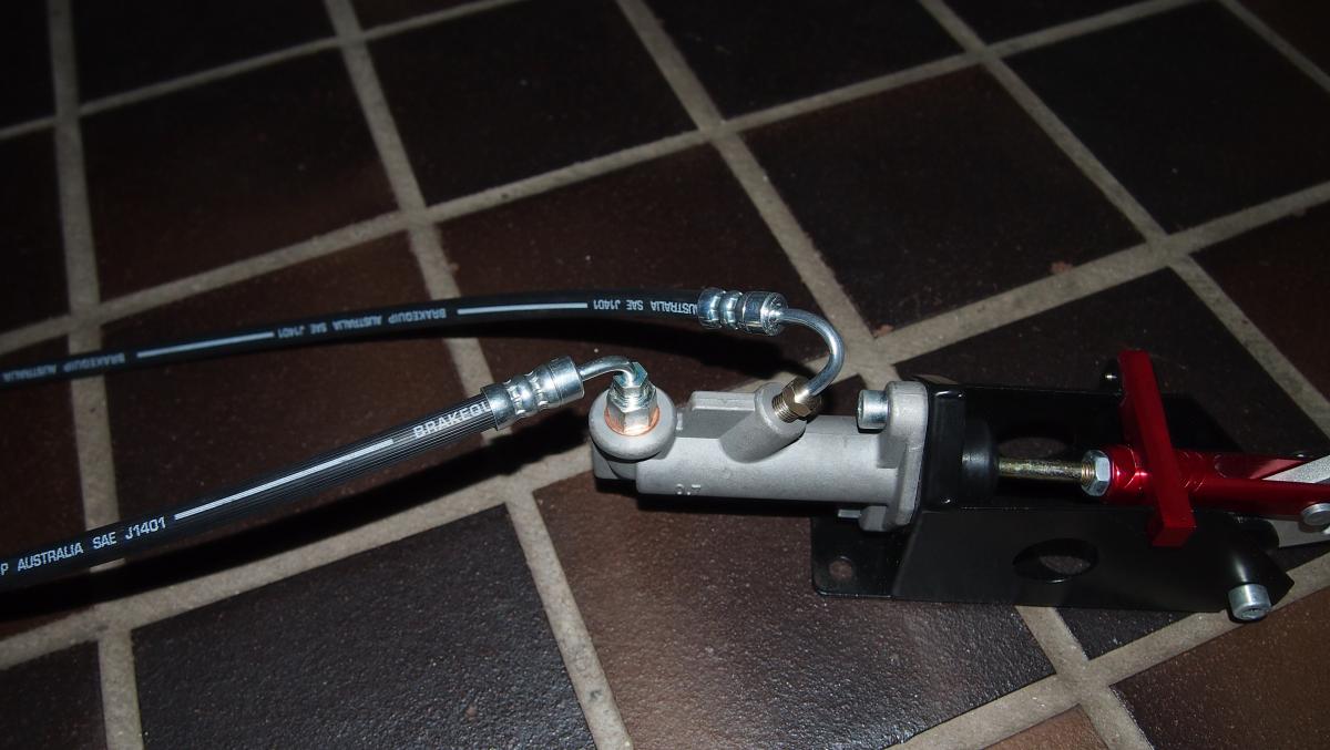

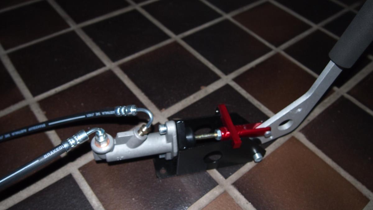

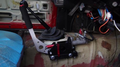

  6. Fitted hydraulic handbrake. Ebay special just had to make up the bracket. I had some flexi hoses made up by a brake shop and fitted in.

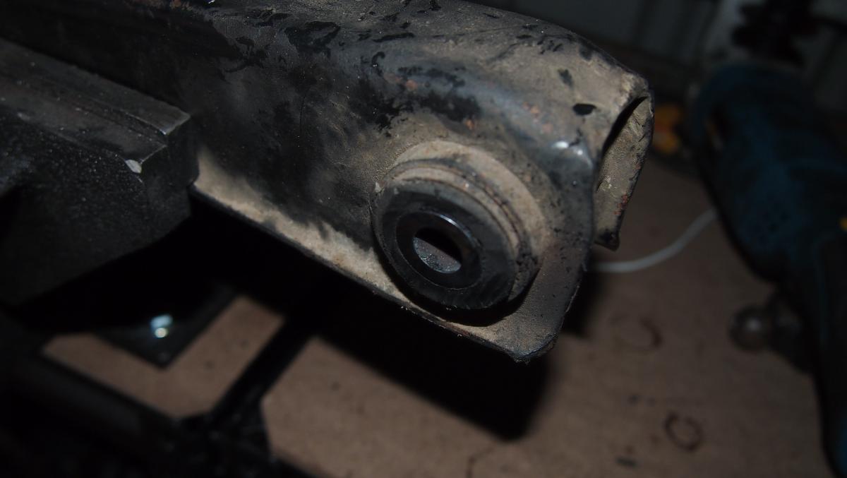

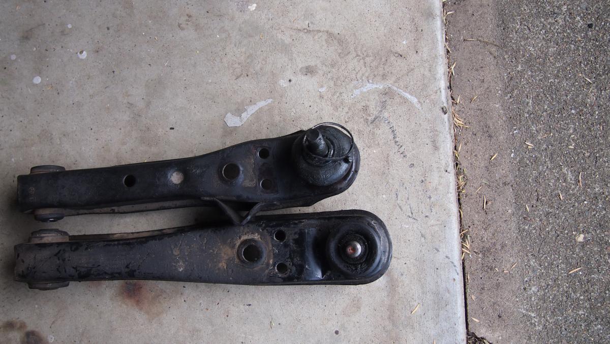

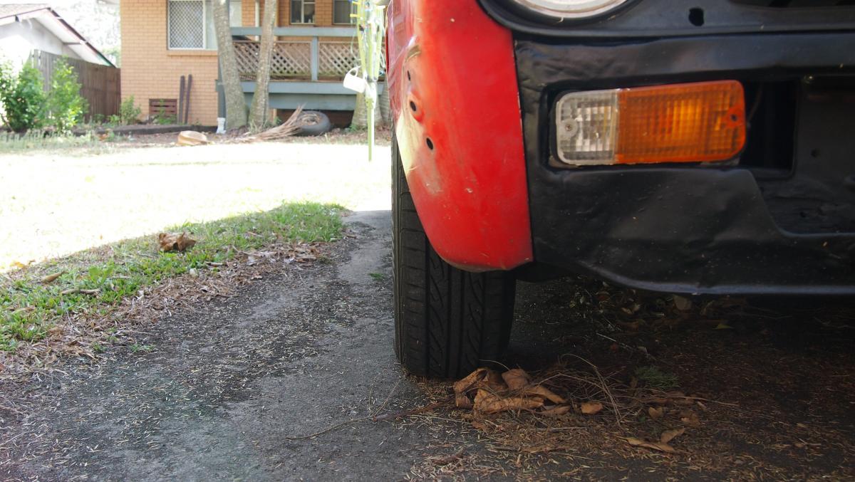

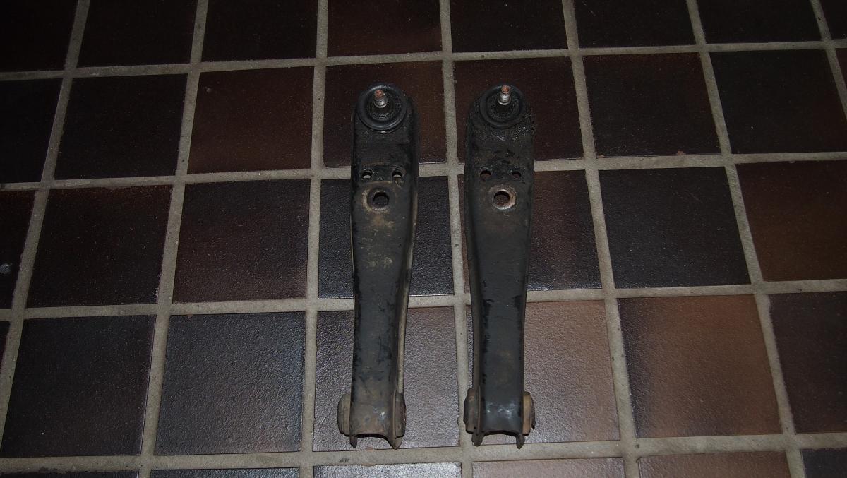

  9. Fitting GB Sigma LCAS Picked up a set of GB sigma LCAs from a mate who has a GB which he has modded to a pretty sweet motorkhana rig. I pulled one side off the KE and had a look. They were definately longer by about 20mm. I had to make a few modifications to them but i was expecting to. The hole for the sway bar was too far out on the sigman LCAs so i had to drill another hole otherwise the sway bar link wouldve been sitting at about 45 degrees . Also the inside bush was too fat to squeeze in so i had to grind that down to fit in its home. The ball join on the sigma control arms was different too so i couldnt us the castle nut which came off the corolla. I had some nuts lying around that fit so i just used them. After that it was just a matter of reasembling the suspension. Since the lower ball joint was further out it had made a chronic case of toe out so i did a quick to adjustment by eye ready to go for a proper wheel alignment. I'm still wanting to fit coil over sleeves so i think ill wait till ive done them and then ill get the W/A done after that. Here is a couple of pics of Before and After the LCA change. Sorry i have no camber specs atm but when i get the W/A done ill try to get a print out so i can put up the camber spec afthe the LCA change.

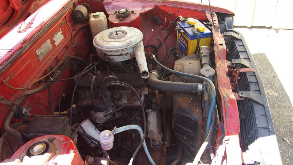

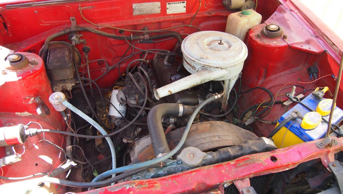

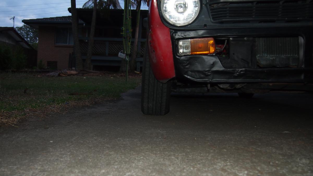

  10. Removed front Chrome bumper Started off by taking off the chrome bumpers, this led to having to put the lights somewhere, which led to modifying the lights, which led to wrecking the red paint from welding brackets on, which led to painting the front grille section... so for a build where i didnt want to bother with to much bodywork i did a fair bit of mucking around getting it all to fit. Turned out ok though so here are some pics. Also took this oportunity to take a couple pics of the engine bay.

  15. Sweet got my hydro handbrake. Just need to plumb in and mount. Hey SatNav do you have any pictures of how you had yours mounted? Saw you rolled old Spike :sob: Sorry to hear that mate.

  20. Looks alrite might be a plan. How did that activate, forwards or backwards?
  21. Got these off Ebay. Pinking up from PO tomorow ill let you know if they any good http://www.ebay.com.au/itm/TOYOTA-COROLLA-KE20-KE70-1-1LT-1-3LT-HURRICANE-EXTRACTORS-/160863955134?pt=AU_Car_Parts_Accessories&hash=item25743d28be#ht_2486wt_1037
  22. Both new so should be sweet then. yeah i was going to try to have it sitting next to the standard one as long as it will be comfortable to use. If not ill just use hydro... not going to drive it too much on the road anyway. Cheers for comments :thumbsup:

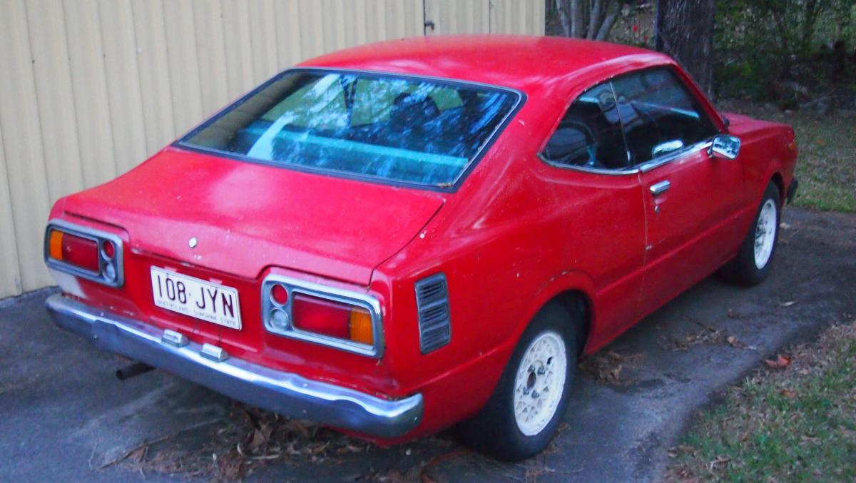

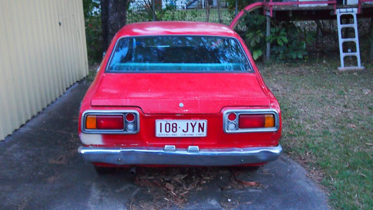

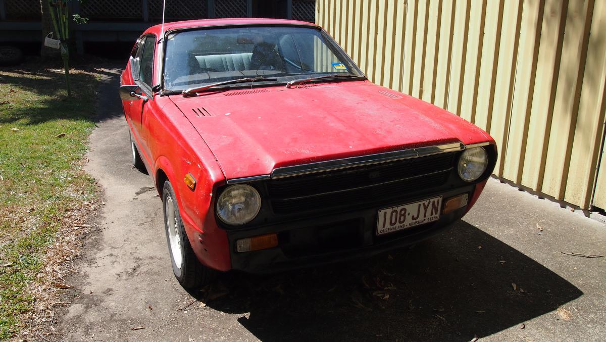

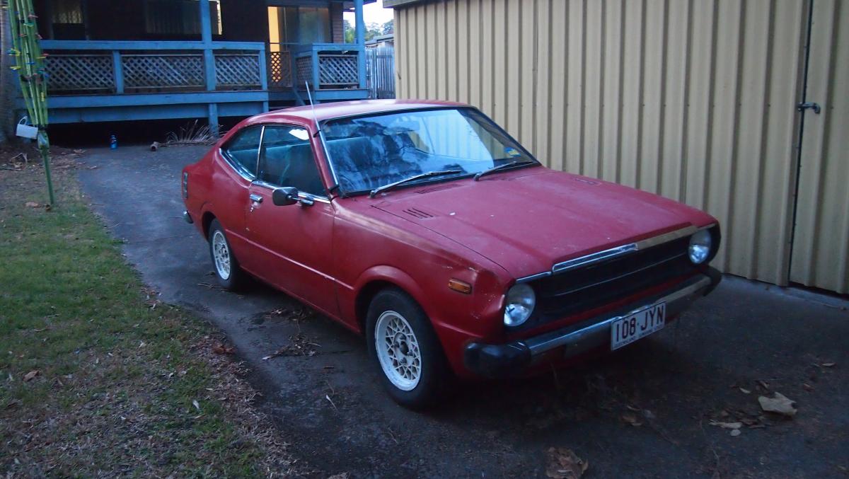

  23. Hey all Names Michael I'm in Brisbane Have had a ke55 coupe i bought off an old lady for a while and havent had the motivation to do anything untill recently. Ive started a blog too if you wanna check it out - hoping that will keep me motivated. Looking to turn it into a fun motorkhana car :rocknroll: Heres a couple of pics
