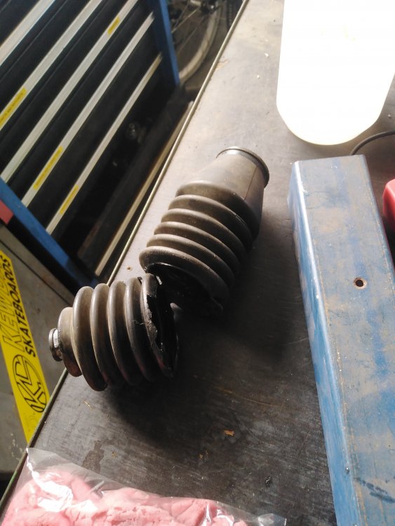

The left rack boot is changed, its been dead for a while. Put some fresh moly grease into the rack after cleaning it up and regreased the tie rod ends. Spilit boot on the left side and no spare to change it, but theres no play and when the thing is installed the remaining rubber caps it off. Ill just let it die a slow death and change it down the line. Decided to fix my tacho, as it stopped working when I rewired the fuel pumps. Decided to untape and trace many things, ended up shortening up the power feeds to ignition and ecu power by about a metre since they are side by side in the glove box. I checked over all the tacho wiring, and removed the old fuel pump circuit that was balled up in the back seat area since the rewire. This meant a lot of dash and cluster had to come out, and also the blower motor and vent for the fan. While it was all apart I re routed a lot of things, tested all the tacho wiring from the pullup to the dash, and the pullup to the left kick and all was well, so I checked the power side and realised that it was powered by the spare pin 87 on the old fuel pump relay. All I had to do was reinstate a relay there to power it, and to put it all back how it was minus the now removed fuel pump circuit. So I tidied it all up, put it back together all but the last couple screws, fired it up, and tested it, and tacho still dead. Had a quick think, decided the work I had done was sound and then checked the fuse to the relay, and of course it had blown when I rewired the fule pumps most likely. Changed that, then perfect tachometry. Yesterday I clearanced the bonnet a bit more under the reverse cowl and drilled a drain hole so water can flow out and not build up under it. Ive had a bit of an issue with the number 1 filter rubbing through on a sharp endge it now passes freely where it needed to. I also took the breater outlet off my catch can and sealed it to reduce the amount of rich running smell you get while its warming up. Seems unaffected by the change as far as how it runs. https://youtu.be/O_-iBGJGoBs
