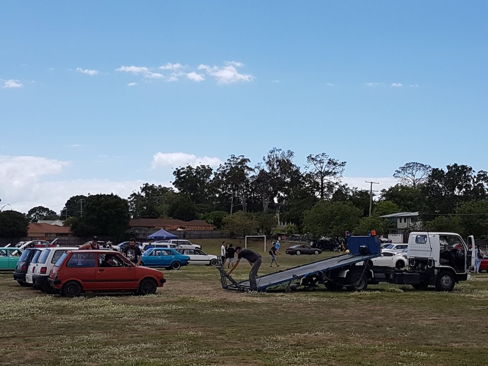

Had a great Sunday morning at the 7 of Clubs all Japanese Classic show and Shine event. Unlike last year the AE86 was well represented, with stock ADM, Stock JDM, ADM to JDM, UK Spec and modified versions, mine with the 2az and another with a rotary. Notches and hatches, Levins and Truenos. The black ae86 called Loco86, owned by a bloke called Mitch, won the peoples choice (I voted for him too). Great dude with an immaculate adm to jdm conversion. Built by him and his dad.
