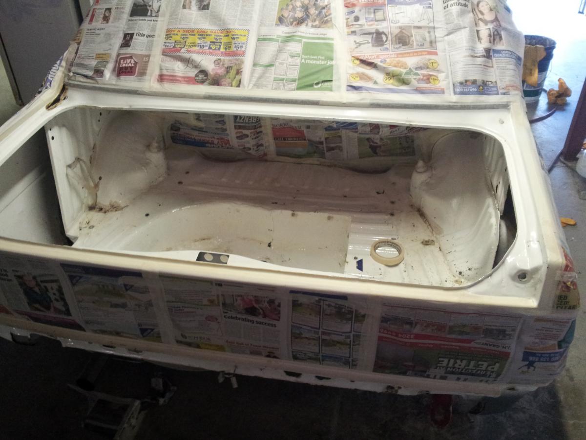

Good day today. Windscreen is back in and sealed up nicely, got the inside of the boot all painted, along with the boot and mould for the lower panel. Hopefully glass up the rear panel tomorrow. Fuel tank, tail ights, wiring and all the brackets installed into the boot as well. Trying to get the car onto the Dyno this week. We'll be picking up the new tyres next saturday, we managed to distroy 6 tyres in only 40km's at Hirstglen.
