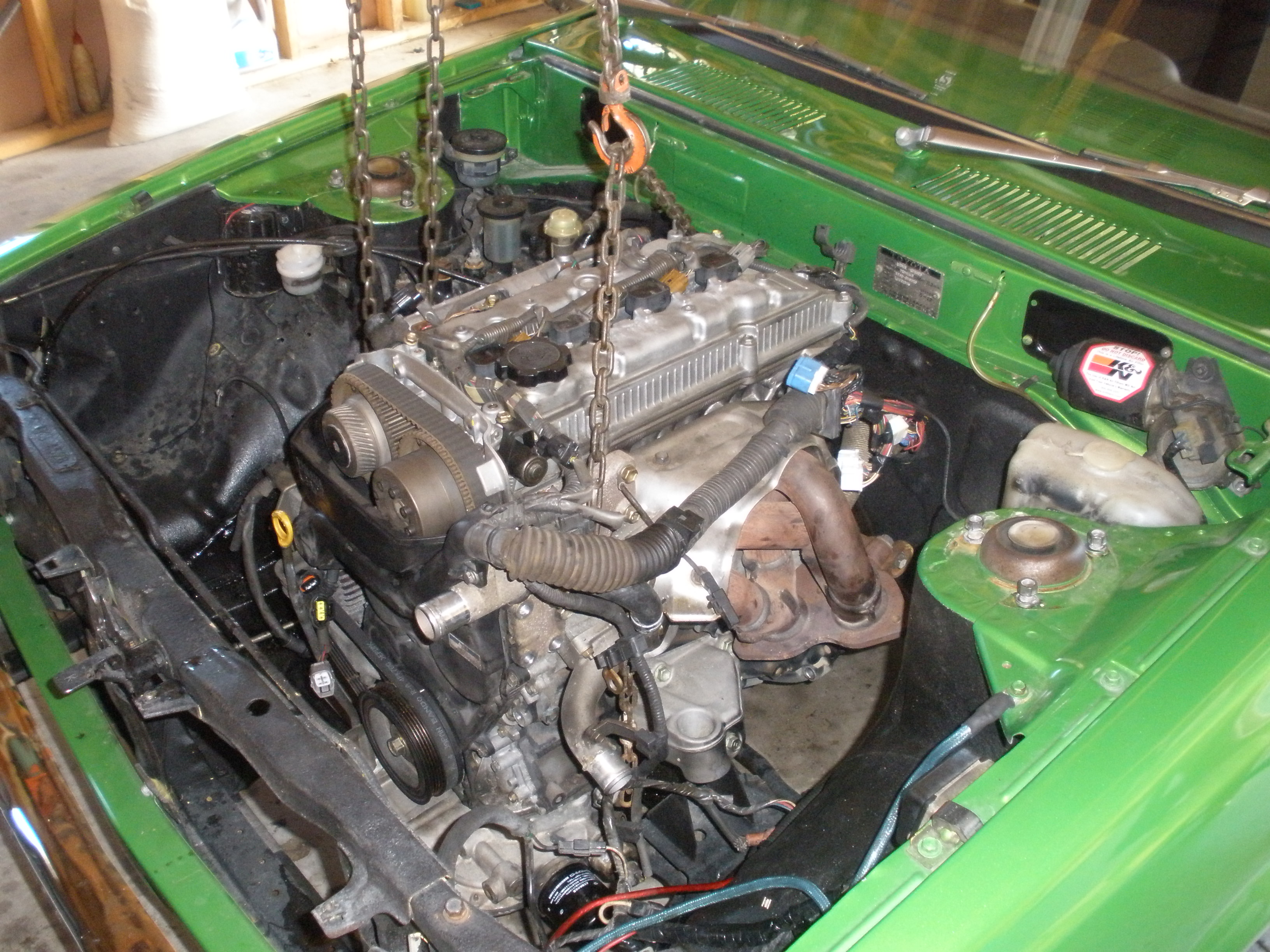

  1. thanks for all the comments. yea i like to be a bit different but its proving to be a costly exercise. Have been pretty slack at getting on here but i got myself a gearbox from down in dunedin last friday W57 finally. Bolted it up to the motor along with my brandnew solid flywheel and found that the existing clutch plate even fitted the gearbox input shaft. Score. To be quite honest its like this motor is made for the 30 the only modifying to be dones is the mounts on the crossmember I'm even using the original mounts on the motor. The gearbox lines up with the existing hole in the floor which i was stoked about. Just waiting on my bellhousing to be modified as the starter is on the wrong side and have to make up some plate for the mounts and with the engine sitting in place weld them to the crossmember. Got my 4k on trademe http://www.trademe.co.nz/Browse/Listing.aspx?id=243213971 just trying to sell that off so i can afford to go buy myself that mighty expensive link. Also trying to sort out a lsd diff head for my hilux housing and the brakes to go on it. Big project but it should be good fun. I'm aiming for about 250hp at the wheels but it will propably be more like 200. Sorry i don't have any fresh pics at the moment but i will try and get it out this weekend and take some but it will more likely be next weekend before i get the bellhousing back. Phil.

  4. sat the motor in today just to see what i had to do with the crossmember etc it all ligns up overrated just have to cut the existing mounts of the cross member and use the mounts that are on the engine. The only problem i have at this stage is the swaybar is to close to the sump so will either have to find a different swaybar or maybe get one made. Just sorted out a bellhousing tonight its a 1S bellhousing and i am now going to use a W57 gearbox as apparently the ratios work better with the beams.

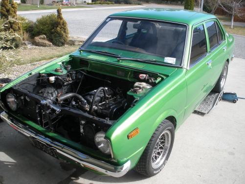

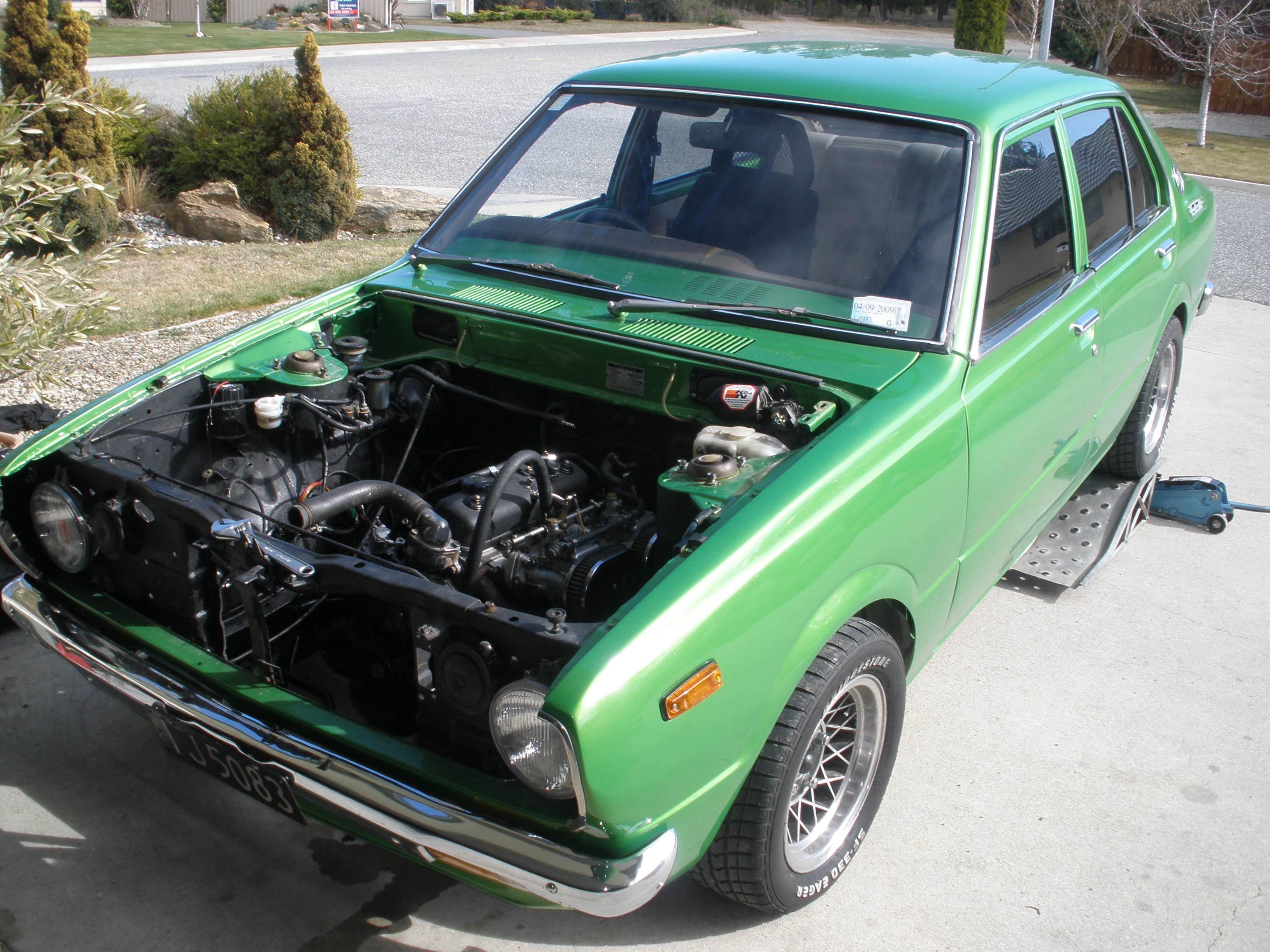

  5. thought i better put a photo up of the car

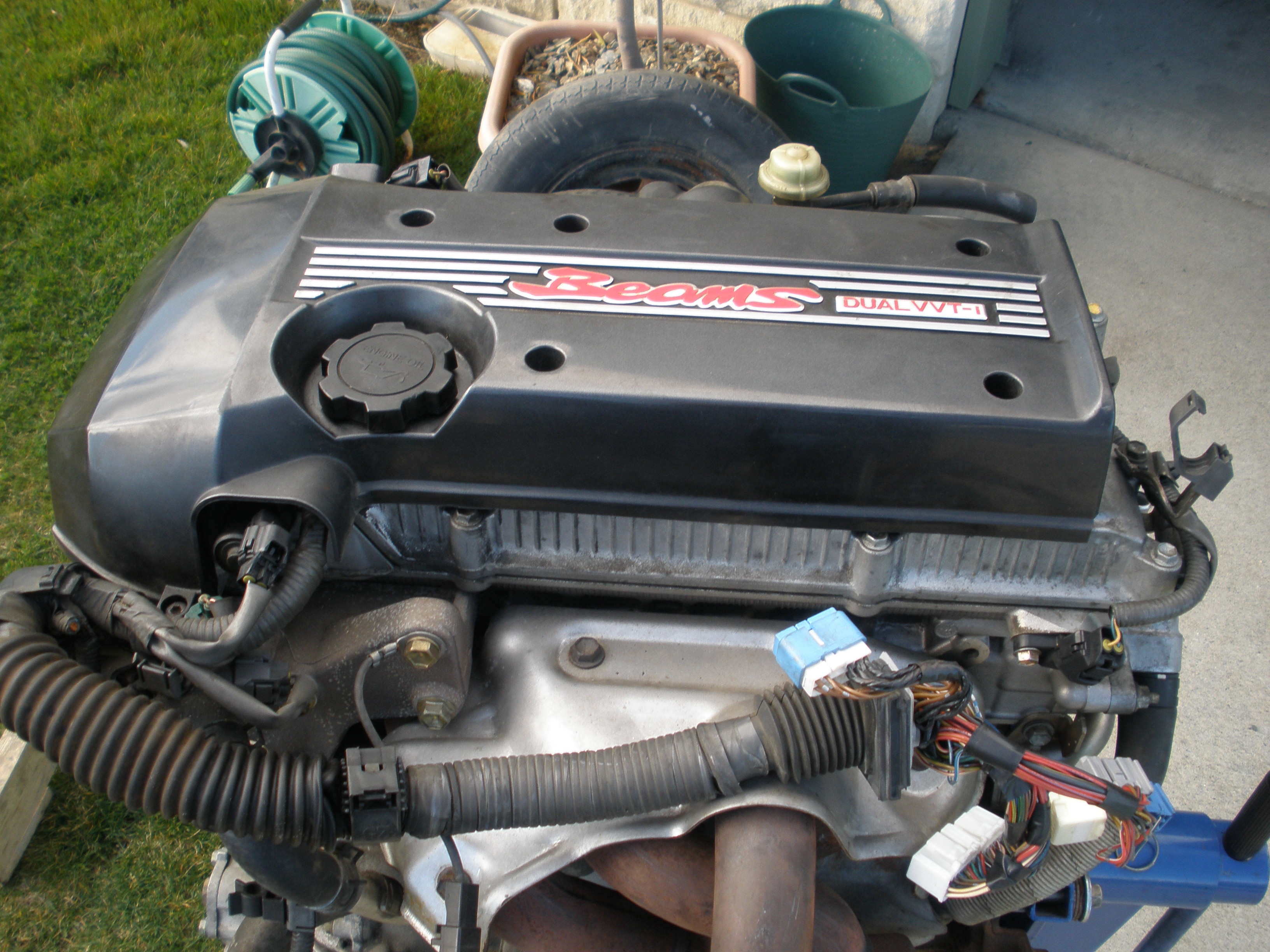

  6. well i have bit the bullet and bought myself a 3sge beams to drop into my ke30 that i rebuilt from the ground up last year so i will try keep you guys updated on what I'm doing. Motor : 3sge beams Gearbox: W55 with 2c bellhousing Intake : Blacktop quad throttle bodies Engine management : Link G4 storm Diff : Undecided ?

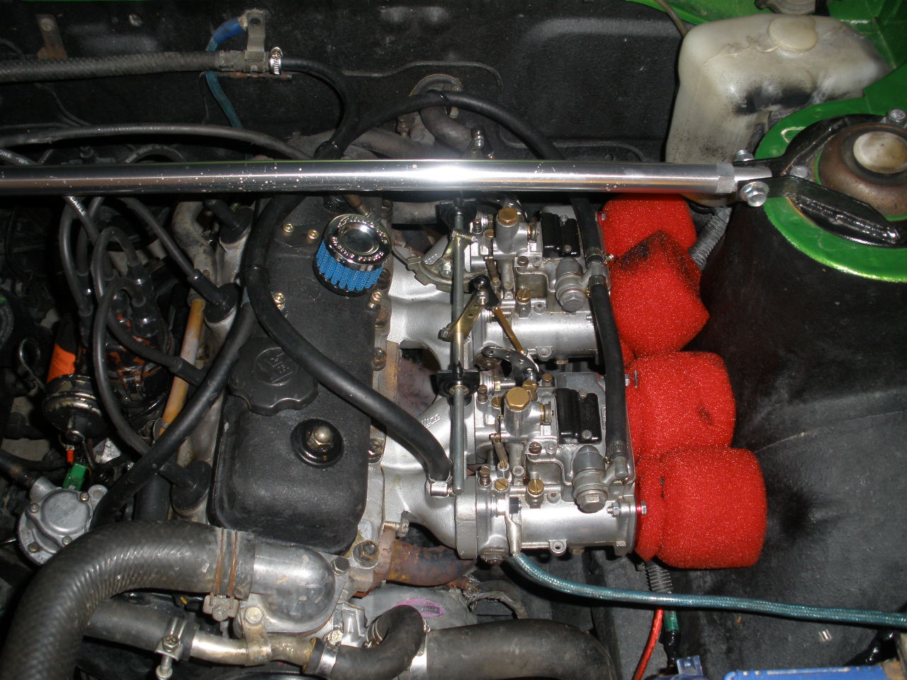

  22. haha propably all up cost me about 1300 but i rebuilt the carbys. Got a different filter setup on it now the socks werent sucking enought air cause they were pressed up against the strut tower, got some nice K&N's on it now
  23. i presume youre talking about the sidedraft manifolds ? they seem to be a well made manifold, bloody expensive setup but makes it go like a cut cat
