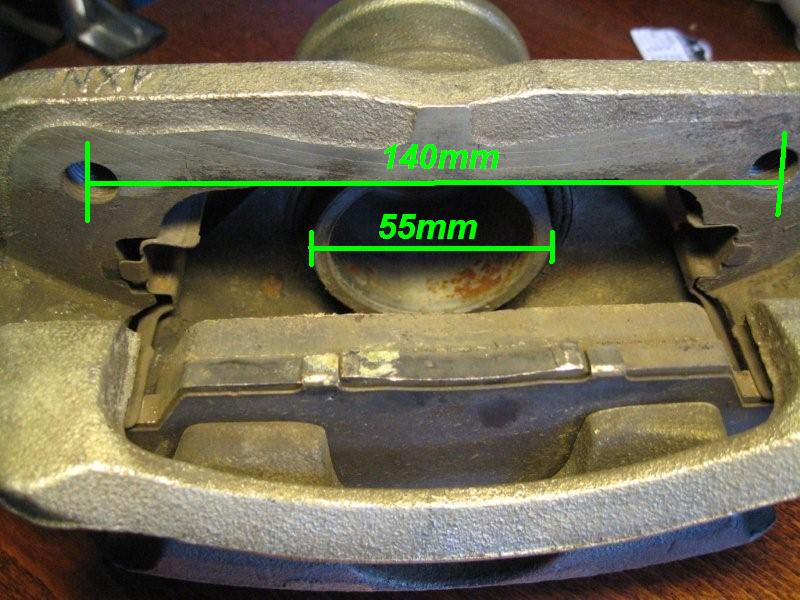

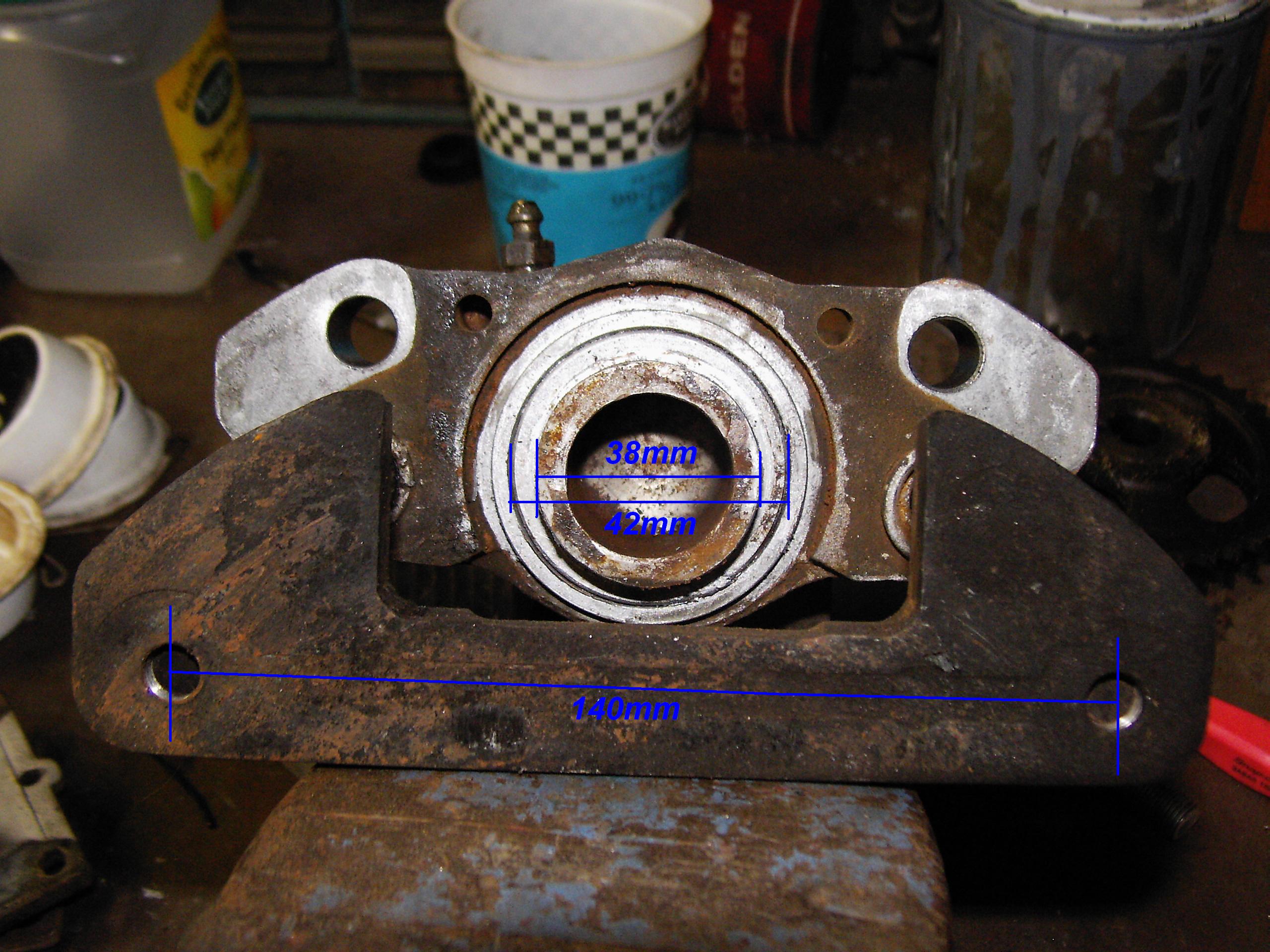

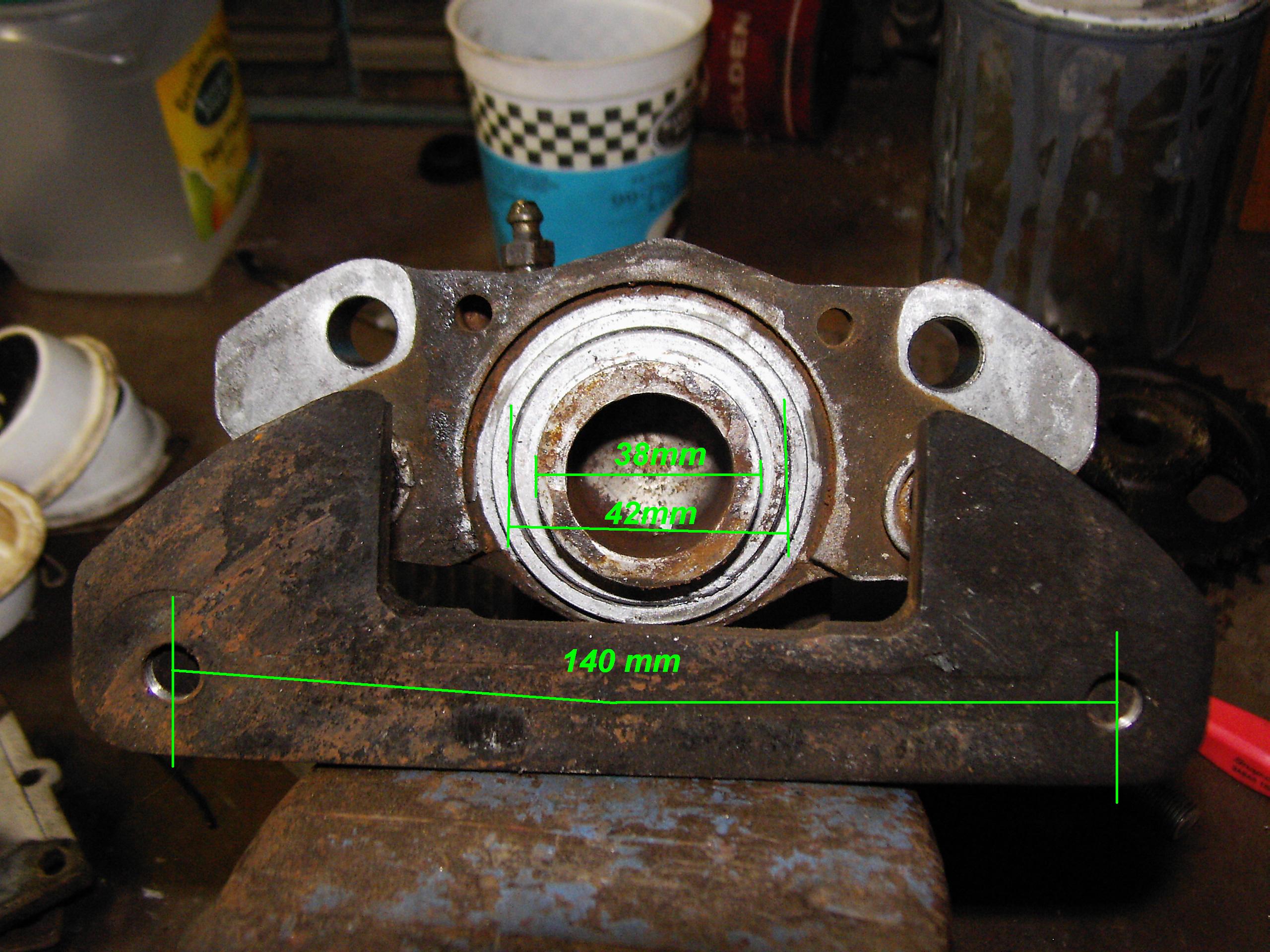

  17. I contacted the guy with the calipers on ebay and he sent me some more pics and some measurements here is the corolla caliper vs the honda caliper Corolla caliper Bolt Spacing= 140mm Piston Outer daimeter=42mm Piston Piston Outer daimeter at brake pad= 38mm Honda Prelude Caliper Bolt Spacing= 140mm Piston Outer daimeter=55mm Piston Piston Outer daimeter at brake pad= 55mm

  25. I was scanning through ebay looking for brake caliipers and I came across these http://cgi.ebay.com.au/ws/eBayISAPI.dll?Vi...DME:B:TB18:AU:1 They are Honda Prelude 91-96 BB4 Front Calipers and have a 140mm bolt spacing so i went to the shed and measured A ke30 strut and they are 140mm exactly the same so this would suit KE30+55 and others I was wondering if this would be a cheap upgrade with some bigger discs cheaply? Opinions Please
