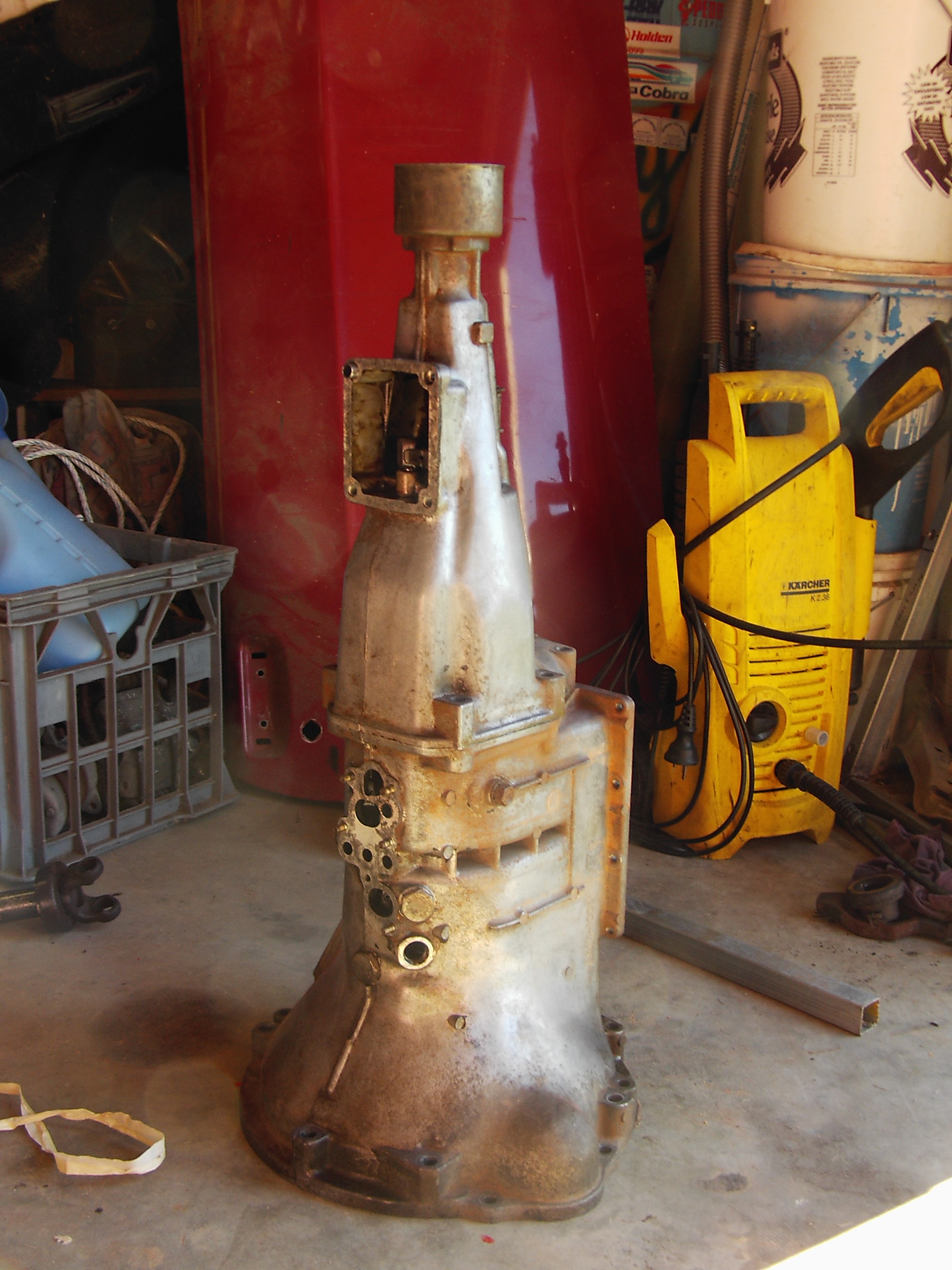

  11. A picture of the gearbox would help us identify exactly which gearbox you have

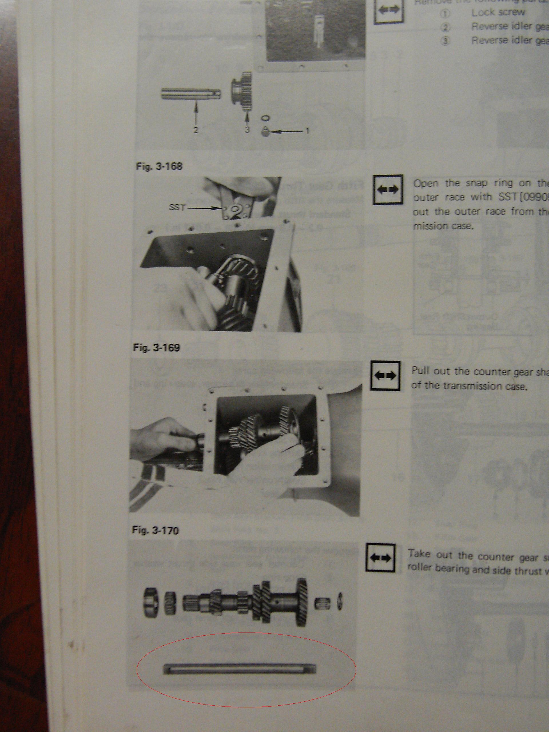

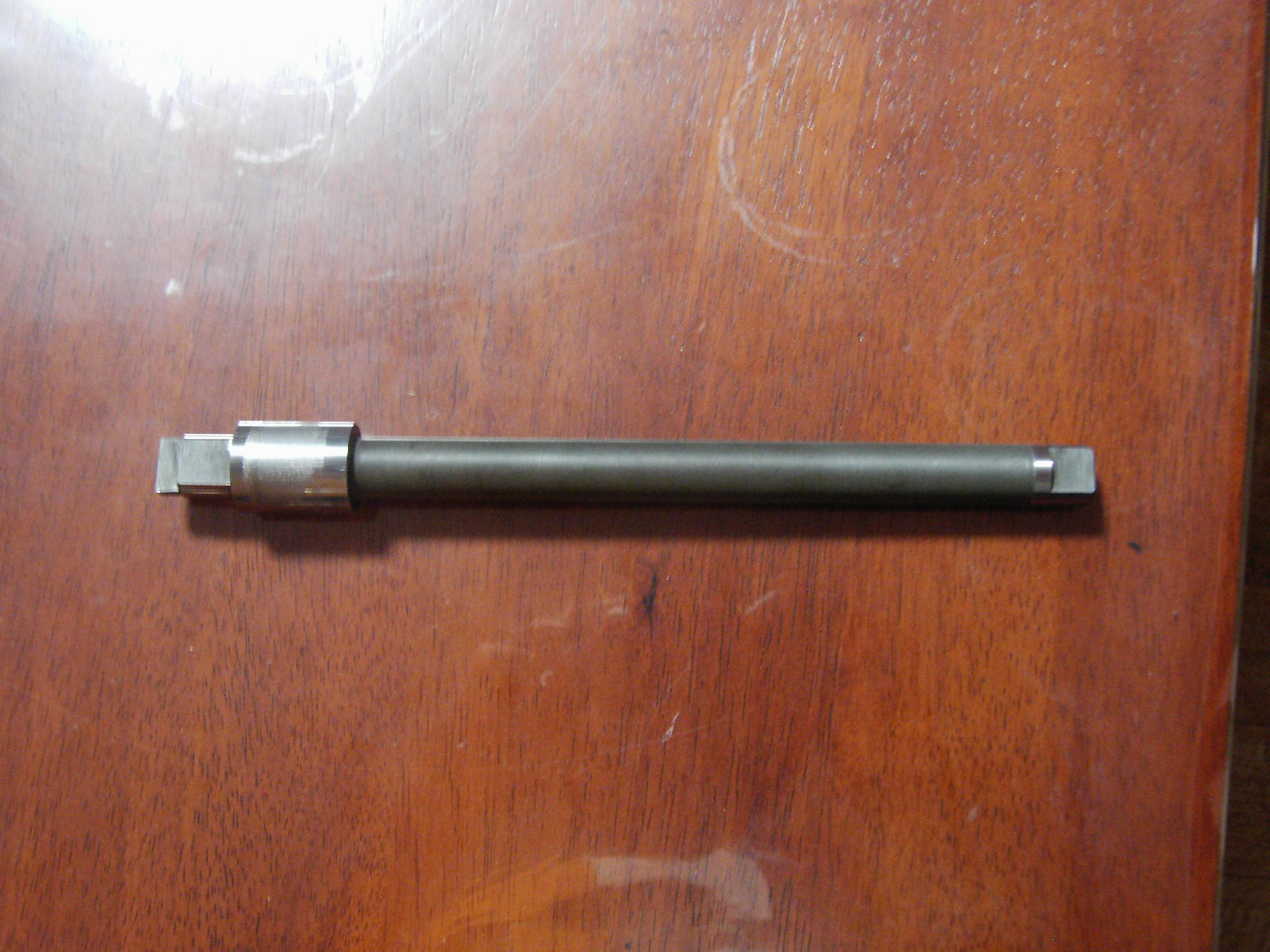

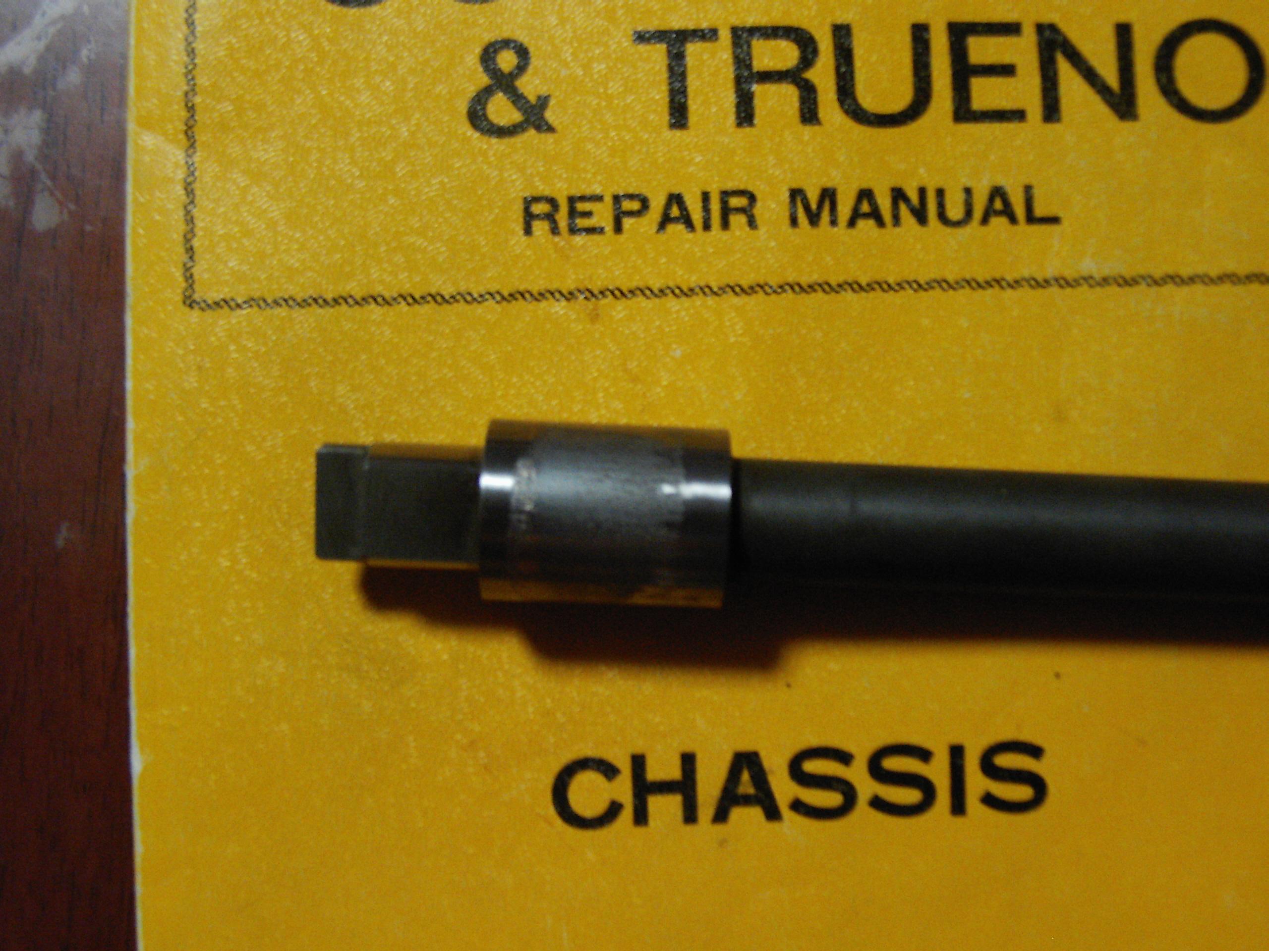

  20. My K-50 had been making a whining bearing noise in 1st,2nd,3rd and 5th gear so my mechanic said come in and i will teach you to pull it apart. We thought it was just a dead bearing but when we pulled the countershaft, which is the shaft that runs parallel to the output shaft in the gearbox and where the bearing operates for the gears on the shaft and it has deteriorated creating the whining noise. Has anyone else come across this? Is it common problem? Here are some images of the shaft out of the gearbox and an image from my Toyota chassis manual, only in the manual it doesn’t have the section of bearing steel in which the bearing runs on in my gearbox. Any advice or anyone with a spare would be greatly appreciated. :)
