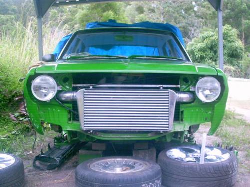

  21. Holy crap man! love your work! I have the same size cooler and was worried it was not gonna fit behind the grill, looks like it will, awesome :P I'm pretty sure it is 300 by 780 end to end cooler by 75 thick.
