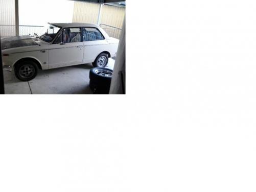

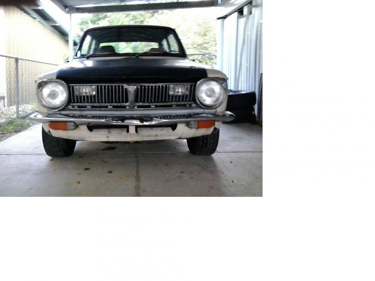

finally got me hot little hands on a ke11 6/70 ami built model. I don't know a great deal about these cars, but this was a good score, and ive always wanted one. Starter motor is shagged so i have replaced it the sarvo and got her running. it has a warm 3k with k40 4 spd and jap diff. Has had front brakes upgraded and been told its ke 20 hubs and rotors with ke35 discs. rear has reset king spring leafs. still retains ke10 front leaf interior seems pretty straight forward and original with ke20 seats in the front and everything else stock. door cards and parcel shelf have been cut out for speakers:( at the moment it runs well but will need a bit of mechanical tlc and body love. theres quite a bit of cancer in bubbles and scratches and surface rust but nothing worthy of wrecking the car. its going to be a slow work in progress and hopefully theres some ke1x lovers out there that can throw in some knowledge and assistance. Plans are to respray in original cirrus grey, get some red pinstriping, restore and polish all chrome and lights, and throw on my twin webers. any mods to make things easier, nicer to drive, must do's, etc would be fantastic but heres some photos while i get back to the new car Cheers!!!
